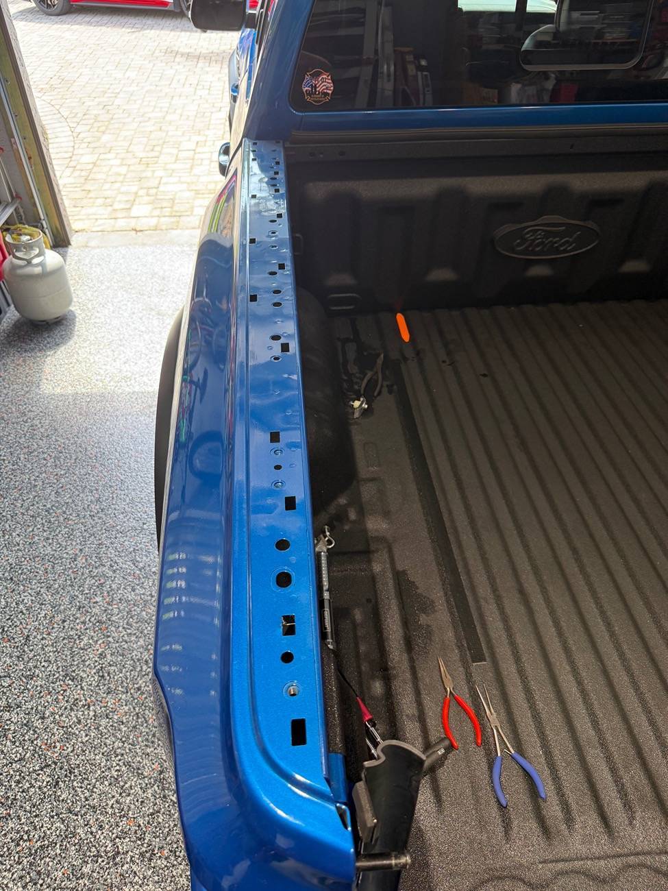

I have sealed all the holes in the bed but still getting water in. The bed cover is the Retrax by Realtruck. Any suggestion?

What holes have you sealed? I used neutral curing silicone around the stake pocket covers and in between the bed rail plastic and metal and nothing is leaking yet. I also did a tailgate sealing kit.

aal the holes under the bed rail, including the clips from the bed rail

Unfortunately until they are sealed, it's still going to leak through the stake pocket covers directly into the bed. And potentially between the plastic bed cover trim pieces and metal. I think Realtruck recommends silicone.
