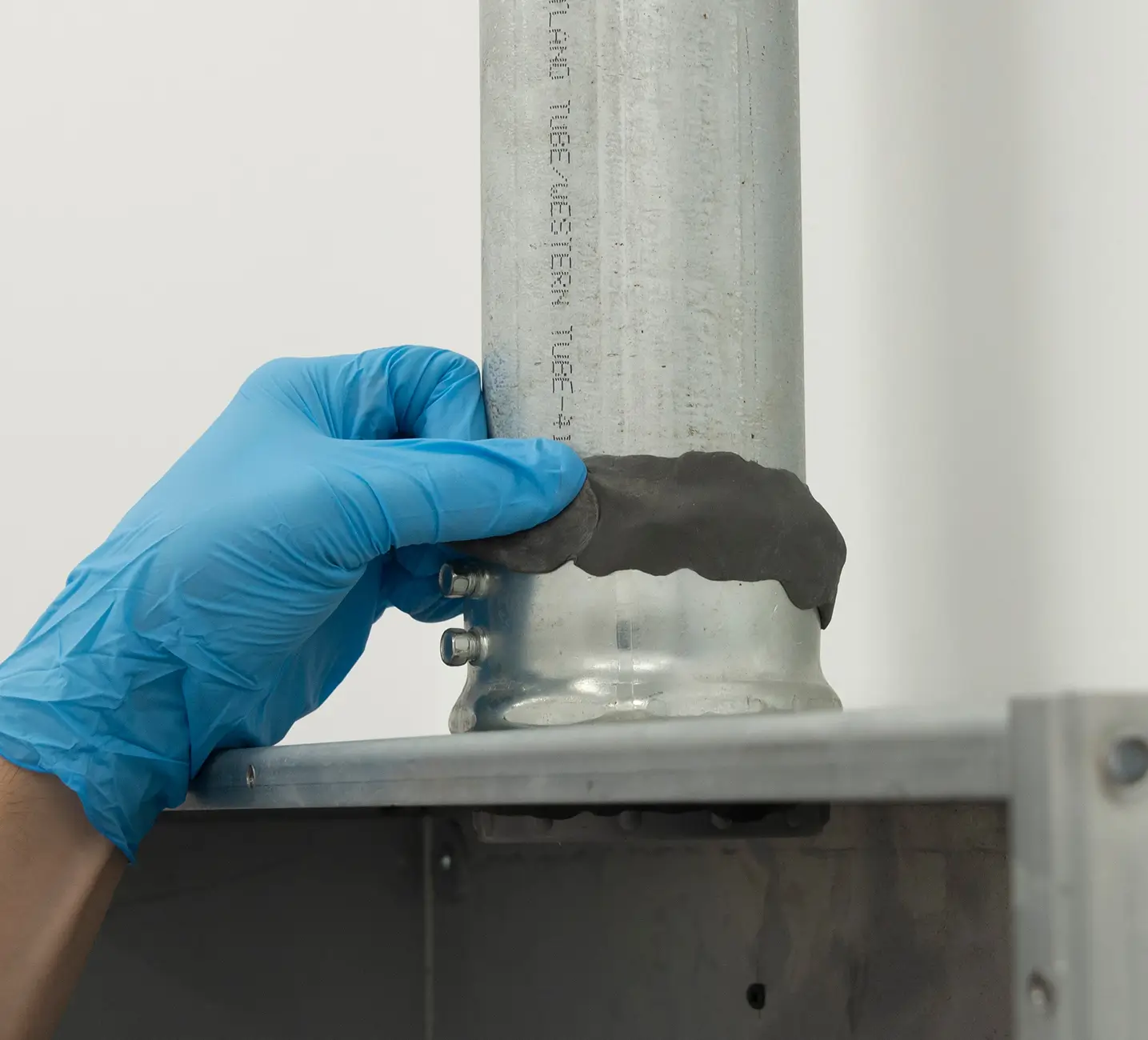

I have rubber plugs that fit all 12 of the exposed holes below the covers. From there, I'm going to use Duct Seal to seal the edges around each pocket, below the cover. Duct Seal is that dark grey, forever pliable play-do like stuff used to seal foundation holes for electrical, ducts, etc. Similar to rope caulk or plumbers putty but designed to last indefinitely without drying out.
Will it be as good as others fixes here? Definitely not. But I don't need waterproof. I just don't want a bucket of water in my bed each rain 😅 My tonneau already leaks so just want to eliminate as much as I can.

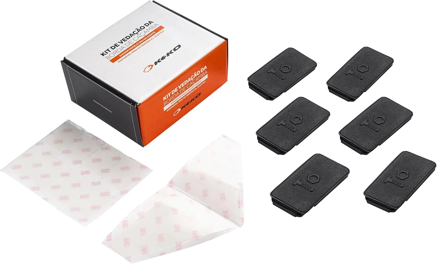

Perhaps already posted, but maybe a 3D printed part (PETG, ASA) for the cover along with a soft gasket (TPU). Just a mock up as bolt holes not accounted for.
Ford Ranger Water leaks from bed rail caps. BedCapCoverDraft
CaptAngry
Oct 4, 2022
439
712
Denver, CO
2026 RRaptor
Space Engineer
Damn, someone finally came out with a commercial offering. So far my 3D printed ones seem to be holding up, but it is nice to know there is a company who noticed the issue. I actually have their tailgate seal kit already
