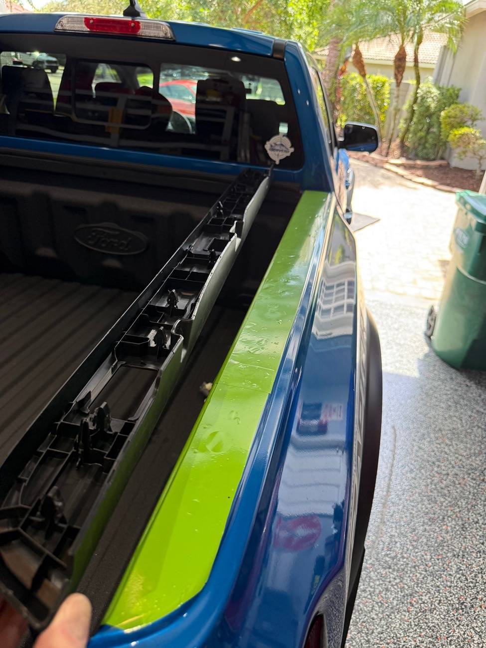

I installed my Retrax last night. This is what I did for the stake pockets.
I removed the stake pocket covers.
Put some rubber grommets in the holes.
Put a bead of silicone on the rails that are under the covers.
Put the stake pocket covers back on.
Ran a bead of silicone around all four edges of the stake pockets.
Installed Retrax.
I have a tailgate seal kit coming next week. Hopefully all that will reduce water/dust intrusion as much as possible.
Here are pics right after a long pressure wash after the pockets were sealed and Retrax installed. Pretty good in my opinion. I just got the tailgate seal kit and will be installing it sometime this week to see if it gets better for both water and dust.

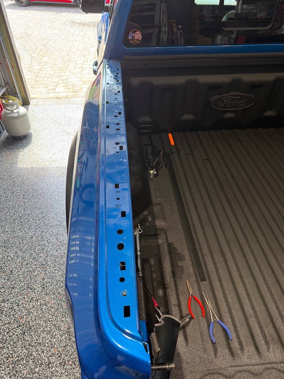

Had some time today. Took off the bed caps. It’s like friggin Swiss cheese under there. I cleaned up and dropped a layer of Orcal 651 (whatever color I wanted to get rid of). Popped holes in the vinyl for the caps to go back on. Later siliconed those penetrations from below. Then you can put your taillights back.
We she’ll see.

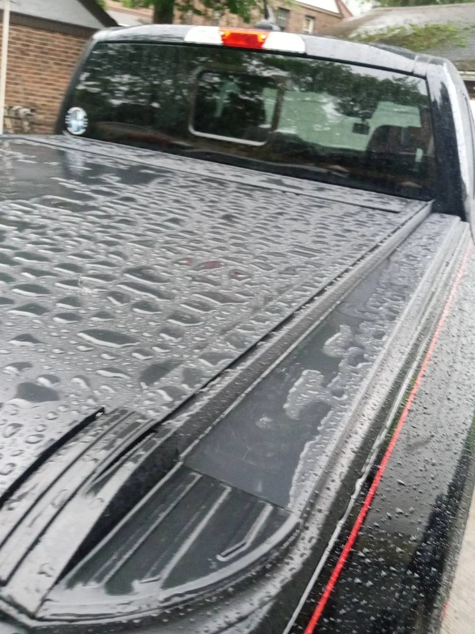

I have a Lomax tonneau cover that works great but it doesn't fully cover the bed rails. I noticed leaks from the bed rail caps and the only fix I could think of was to seal around the caps with clear silicon. I think this would be the same with any tonneau cover that doesn't fully cover the bed rail caps.
Anyone else had this issue?
This will cure that leak. LOL

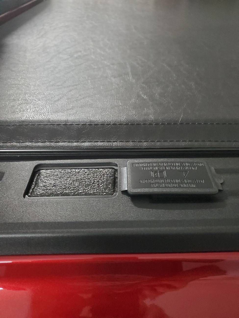

I didnt like the way the silicone looked so I bought some 1" closed cell foam and cut it slightly larger and thicker than the stake pocket holes. Then put the caps back on. Seems to be working well. I also put black vinyl patches over the holes inside the bed.

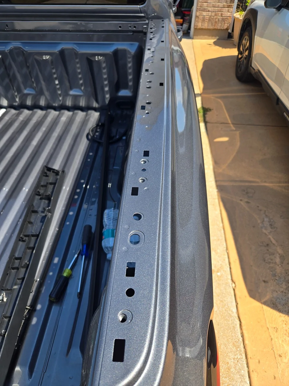

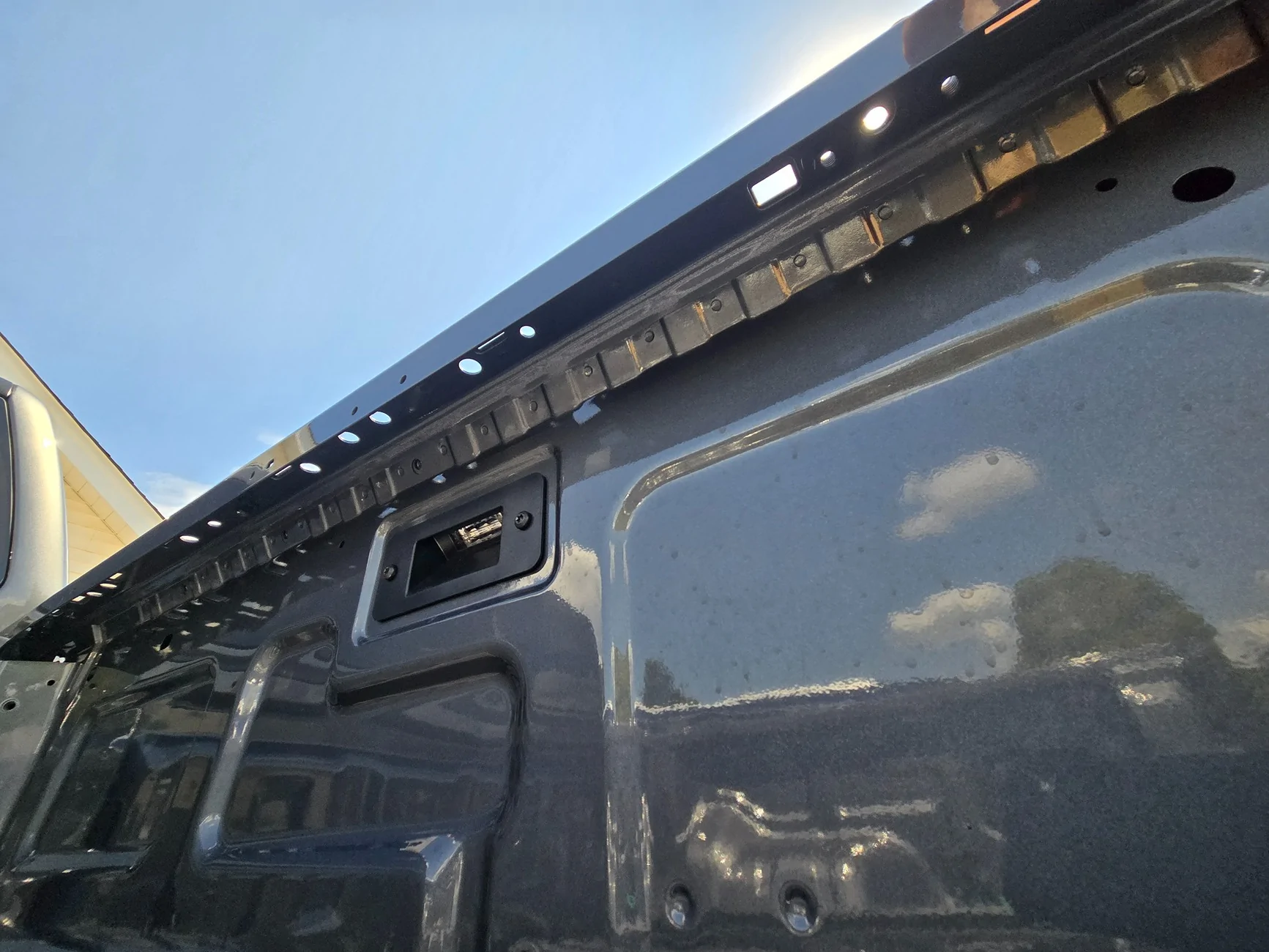

We she’ll see.
Thank you for this. Took my bed rail covers off today (only broke 4 clips, same 2 on each side broke perfectly flush, will be jb welding them back) and doing exactly what you described today. Vinyl the rails, pop rail covers back in, and silicon from below. Like really who tf at Ford approved this Swiss cheese design-with bed rail caps that have built-in water pass through? Blows my mind and concerns me.
