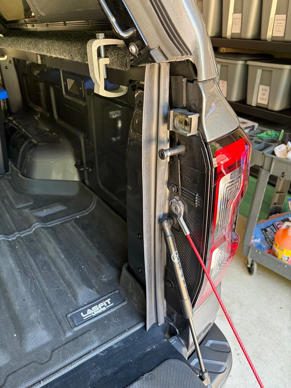

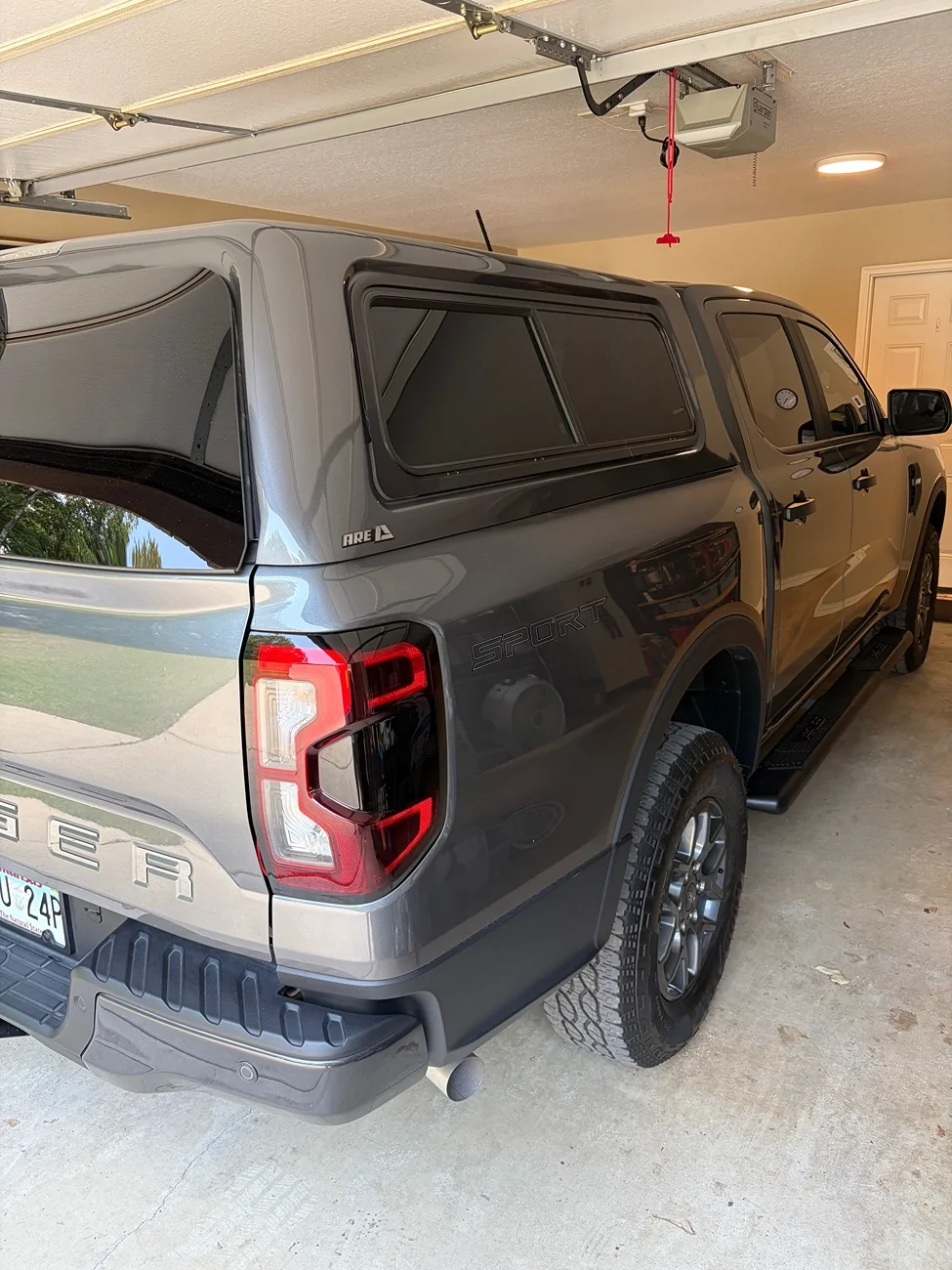

I’ve virtually eliminated leaks in my bed. Installed Rok Block and side seals from Keko kit. Flex taped all holes in front of bed. A.R.E. CX Evolve totally eliminated bed rail cap leaks. Sprayed side gaps at tailgate with full force garden hose - no leaks. Recently drove through 2 1/2 hours of steady rain on I-44. Bed stayed bone dry.

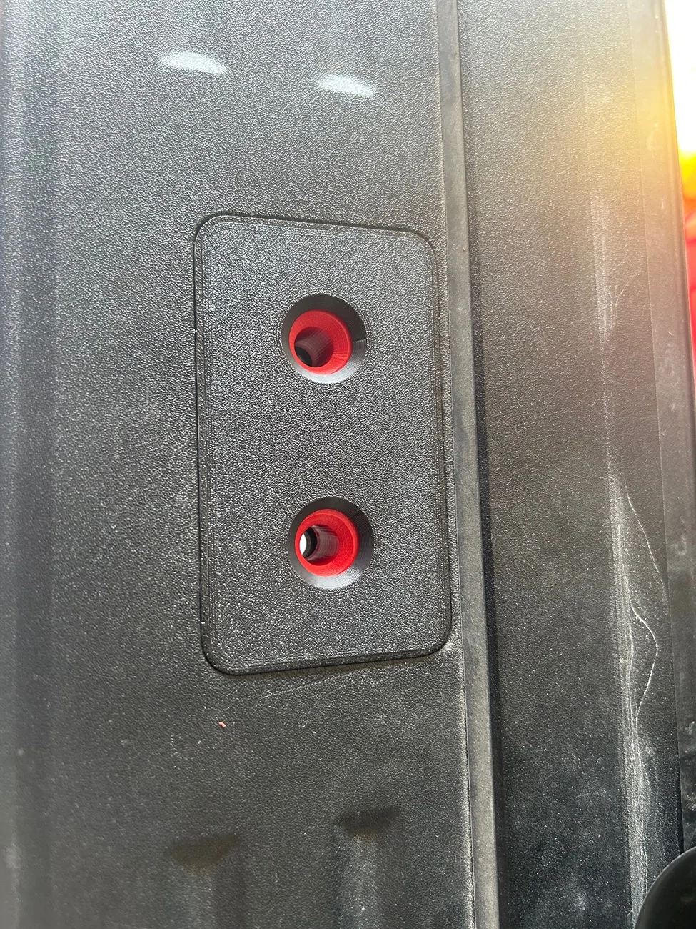

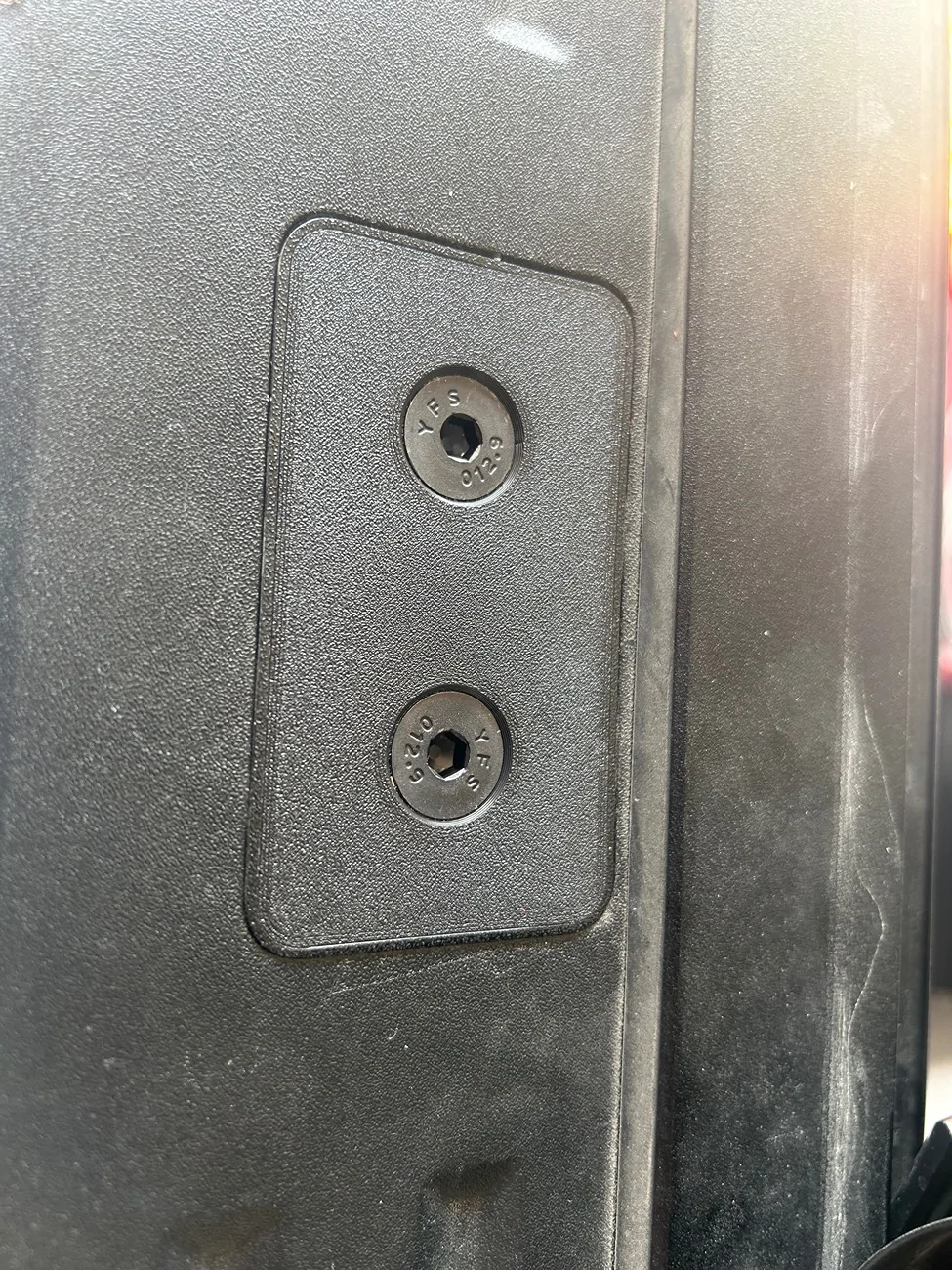

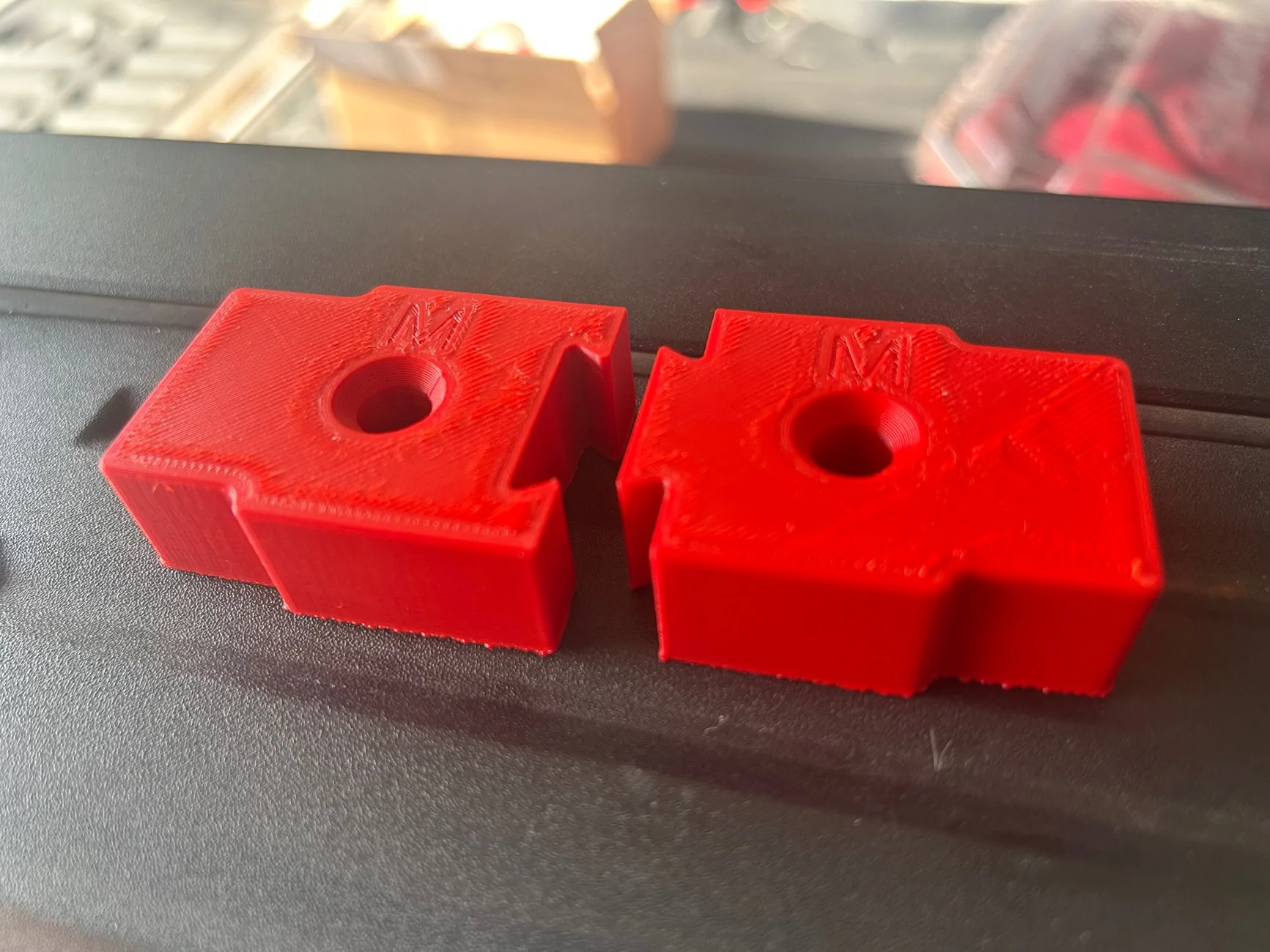

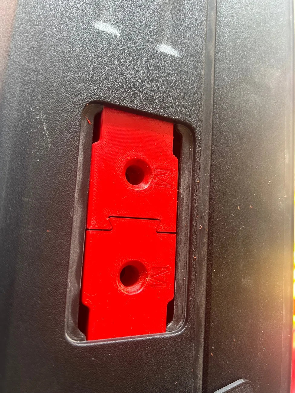

Here’s my take on better plugs. Like a few others, I 3D printed these. I used ASA and 100% infill - effectively making a solid chunk of UV tolerant, impact resistant plastic. A few studies I found (although I am no expert on them) showed that ABS style plastics can have a compressive strength higher than concrete.
Unlike some other designs I’ve seen, I wanted to preserve the flush look with the bed caps. I also wanted them to bolt down, so that I could pop out the bolts to bolt down tie downs or even cross bars.
I started with a simple rectangular spacer -but found that the plastic bed caps would flex near the stair pockets and make it really hard to get a nice flush and tight fit. To support the bed caps, I split the spacers into a two part piece with a loose slip joint between them (the bolts truly hold them in place), but offset under the bed caps a quarter inch or so to prevent them from flexing. Makes everything nice and snug and feels much stronger.
The top caps that you see when installed are also ASA and have a groove fitted with a printed TPU gasket.
After the annoyance of bolting them down once with regular nuts, I ordered a set of nut plates from American Adventure Lab that make it much easier to pop them in and out should I want to bolt something else down there. I keep a set of aluminum angle tie down plates in the truck should I need them. Not an often needed thing for me, but nice to know I have the utility ready should the need arise
I’m sure that these are likely not 100% waterproof - but I haven’t noticed any real leaks from a few rainstorms.
The model files are on makerworld if anyone is interested —>
https://makerworld.com/en/models/3215688-2024-ford-ranger-stake-pocket-caps

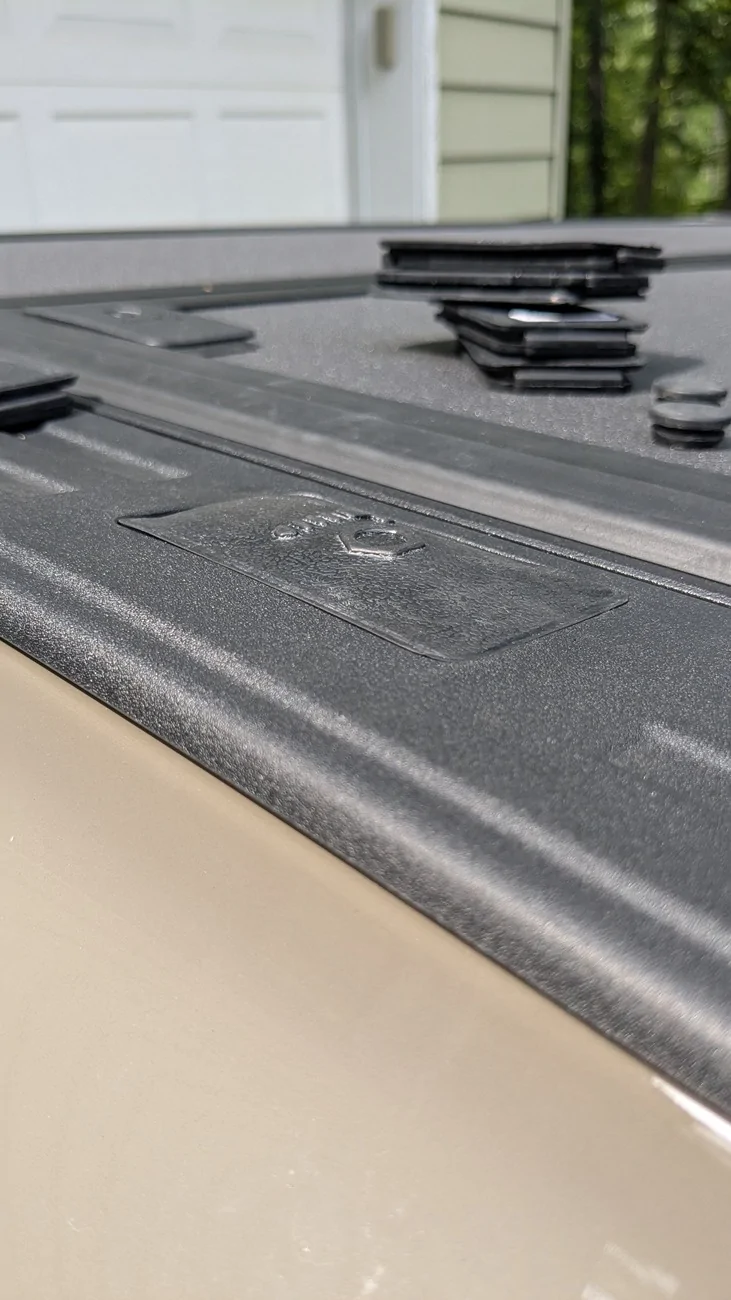

Unfortunately these DID NOT work on my 2026 Ranger. Not sure if they would work on the 2024-2025 with the deeper bed rails? The issue didn't seem to be the thickness though, but more just the general shape.
I tried to bend and push this plug into place, so much so that 2 of them actually ripped across the top from bending, and when I finally got it in it was bubbling up and obviously not fitting correctly. Will be returning. Was worth a shot!

Thanks for being the tester on these.
alrashid2
May 4, 2026
61
555
386
PA
No problem. Getting charged 6 bucks to return too, ugh! You've all helped me a ton so glad I could give back haha.
Once these storms stop on the east coast, I'll try my Duct Seal trick. The only dilemma I have is if it will let water just pool under the caps or not... I'm thinking about maybe only sealing 3 of the 4 sides and leaving the outer edge open. I'm not trying to waterproof, just stop the direct drainage into the bed. Maybe if I leave the outer edge of each pocket open, itll allow water to drain out between the plastic rail cap and metal bed? We'll see!

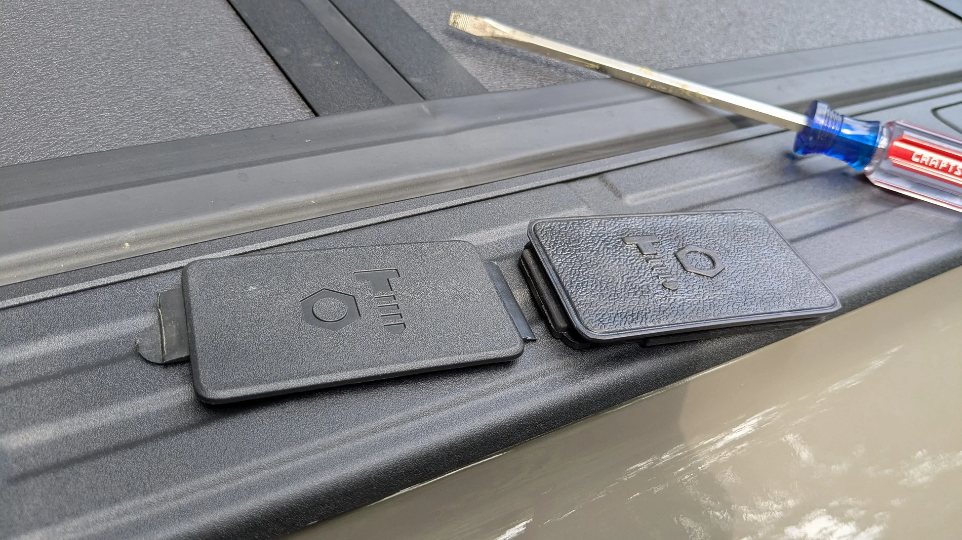

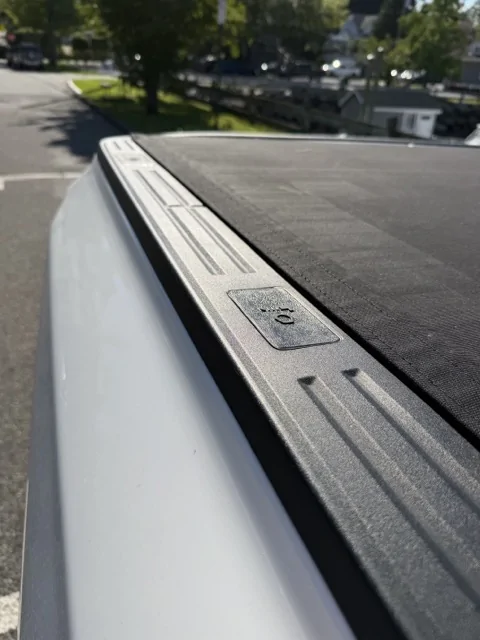

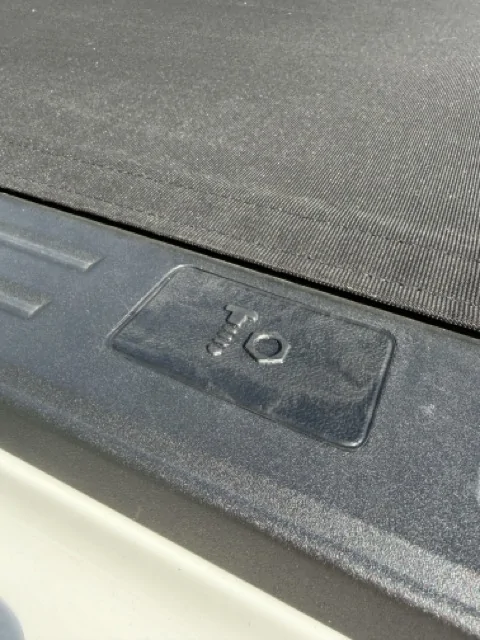

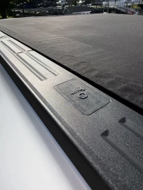

I installed these yesterday on my '24 Raptor. Recommend using a plastic trim tool to get them seated correctly. Fit is spot on once they're in. It hasn't rained yet so not sure if they work - stay tuned.

Got a bunch of rain last night and I'm pleased to say my bed was almost completely dry this morning!
