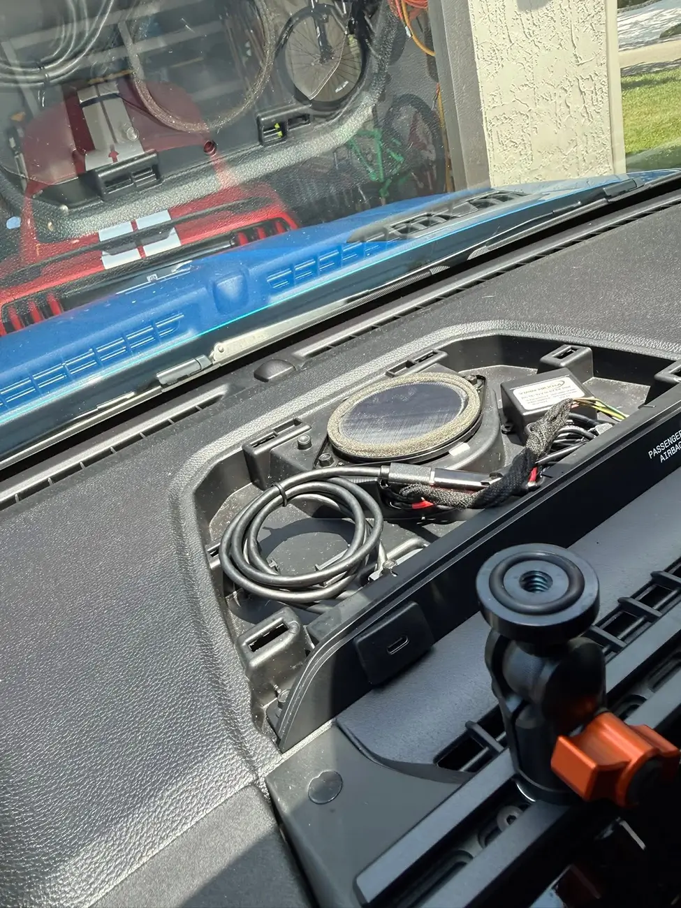

I might 3D print a simple bracket out of black ABS and put it in the inboard corner of the phone slot between the two glove boxes - but that will be a lot of extra work if it would flush mount somewhere else. I would power it using an “accessory hot” fuse in the driver side fuse box . Any comments are very welcome..

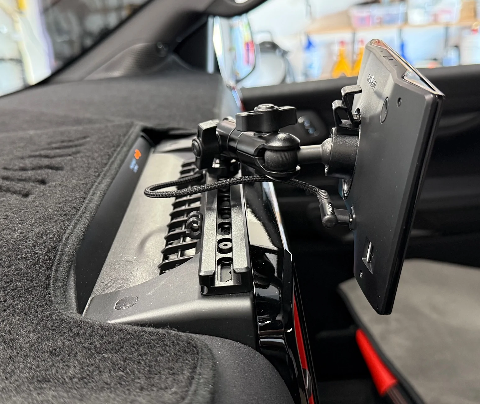

Someone in the Facebook group did this
I considered doing that, but I need a manual switch and I was unsure about how to get power up there, is there a hot wire up there that can be tapped into? I could add a mini switch in the vertical face of the trim near the Airbag warning lights.
The downside is that it gets crazy hot in that location from the sun, I bet that the USB power supply will not live very long.
FYI there are a few USB adapter cables with inline switches available, I tried two variations and neither provided enough amps for my gps to work correctly.

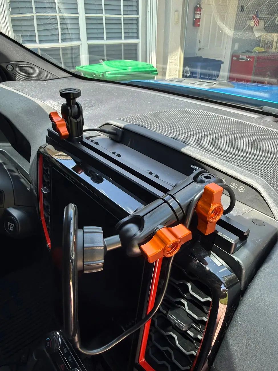

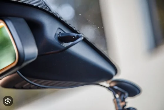

If you used the the OVRHD mount from AAL (https://americanadventurelab.com/product/ford-ranger-ovrhd-mount/) for your GPS, you could install the usb receptical up on the mirror housing like i've seen comes stock on AUS model rangers.
I'd use one of those power supplies I linked to earlier, throw it under the dash with a 6 foot extension up the passenger A pillar, tucked behind the headliner and over to the mirror shroud. On the input power to the power supply I referenced, add an inline switch and put that switch somewhere on the dash, or jump on the 5A overhead toggle switch (I think SW 1).
I'd personally add a new new switch, probably left of steering wheel to keep things simple and avoid extending that circuit above the dash.
