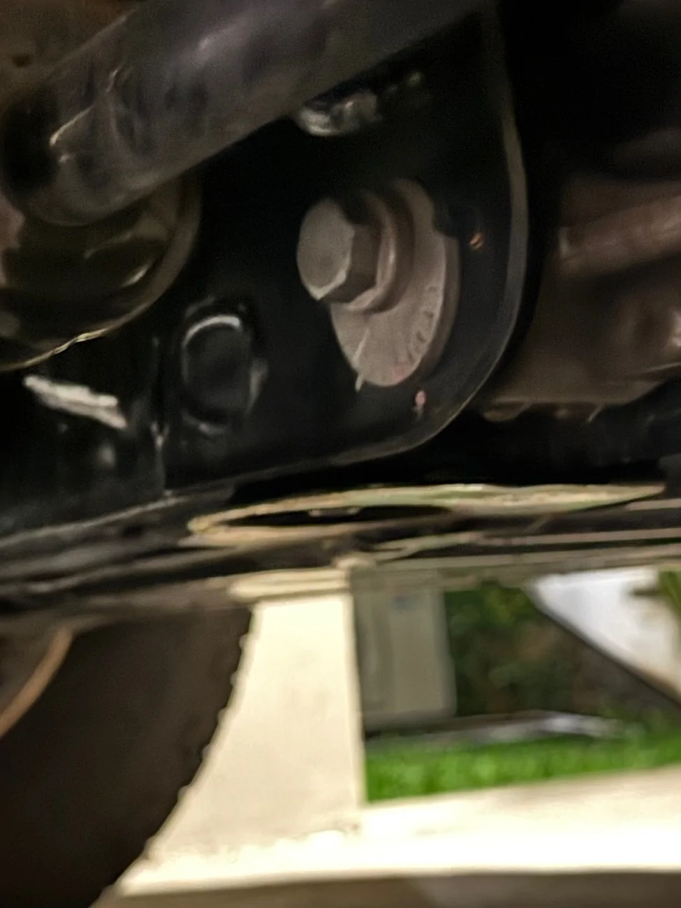

ISSUE SOLVED!!
It turns out to be a loose camber bolt in the right lower control arm bushing. I guess my previous alignment guy didn’t torque it properly.
Anyway thanks for all the inputs guys!
