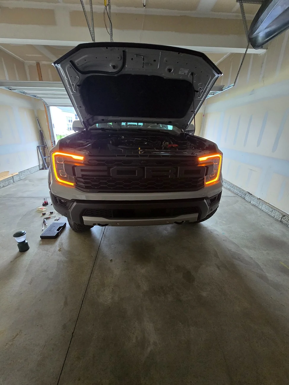

OK, this my second install of Signaute Lux Lava DRLs on a Ranger. First was on a 2024 XLT V6. This time was on a new 2026 Raptor.
The first install took about 7 hours. This install a little over 3 hours. Could have been 2.5, but two scrivets were being a pain.
On the second install I did not remove the wheels. Just turned the wheels to full lock the opposite direction and had plenty of room to hold back the liners.

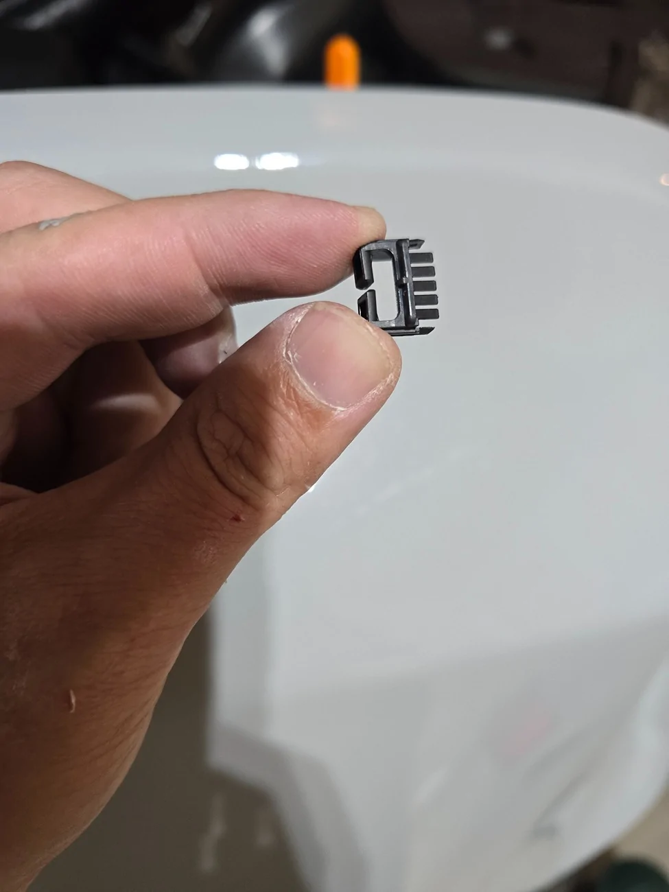

Oh, and the dreaded black clips aren't really a pain. If you pinch them at the top and pull straight back they come right of. Same with the re-install.
