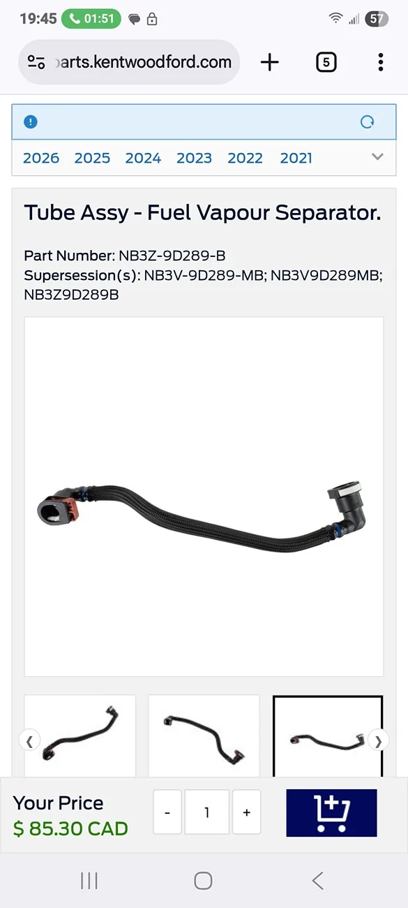

Welp, I was step 2 on swapping out my air intake, and I flicked a red retainer safety clip to another universe... took like 30 minutes looking for the dang thing. No dice. Install video needs to say gentle remove the clip!!! 😂😂😂
Anywho, can anyone help me try to source the red safety clip shown in this picture. You'd be a freaking life saver.
I hope someone can help me 😅 Got some time since I dont daily my truck.

Ypu may have to use a circlip for now. In the nuts and bolts aisle at the ardware store

I’d bet that that clip is used on other models and years of vehicles. I’d check with your local ford service dept and the local repair shops in your area.

i wonder if you can just pull one off a junkyard vehicle too? stuff that small, my junkyard doesn't even charge me for when i put it on the desk to pay

i cannot believe i found that part number, ha ha ha. i thought for sure they would charge you for a whole new hose
Genuine Ford CV6Z9A317D Vapor Hose Retainer Clip | Genuine OEM | 1 Year

@25BlackRaptor
Gonna name my second baby after you

@25BlackRaptor
I can confirm because I did that same thing. This part number is correct.
