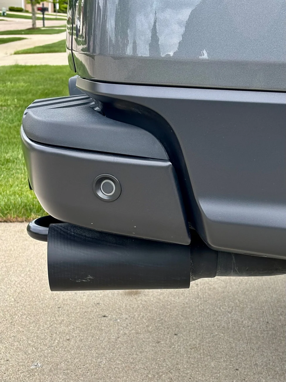

Probably 3.5 inches. I test fitted it and figured out exactly how I wanted it to sit then cut the minimal amount so that the oem exhaust wasn’t too visible inside the tip. Just used a hacksaw and didn’t need to remove any exhaust clips.
I’ve don’t a lot of mods to the truck and the exhaust tip and tinted side markers were probably the best bang for the buck visual changes I’ve made.

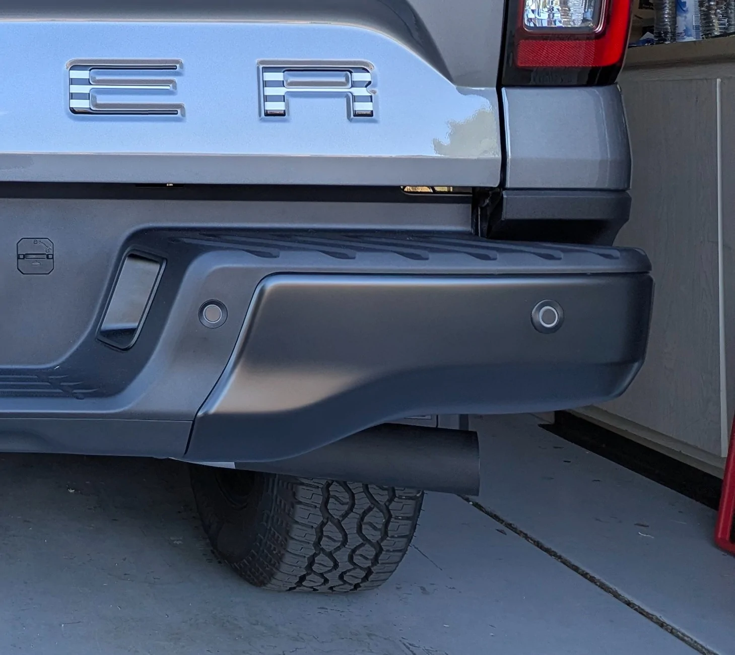

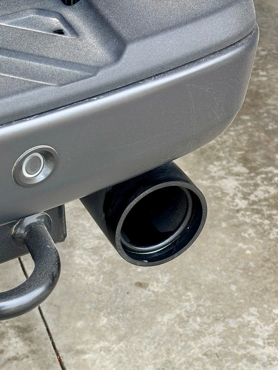

I get it, but I couldn't find any other exhaust tip for the ranger because of the unique size.
High temp silicone tubes, 3.5"ID off eBay. Just apply liquid detergent to exhaust and push on.
These have been on since Feb with no problem.
I wouldn't have thought to do that but now I know. Cheers.

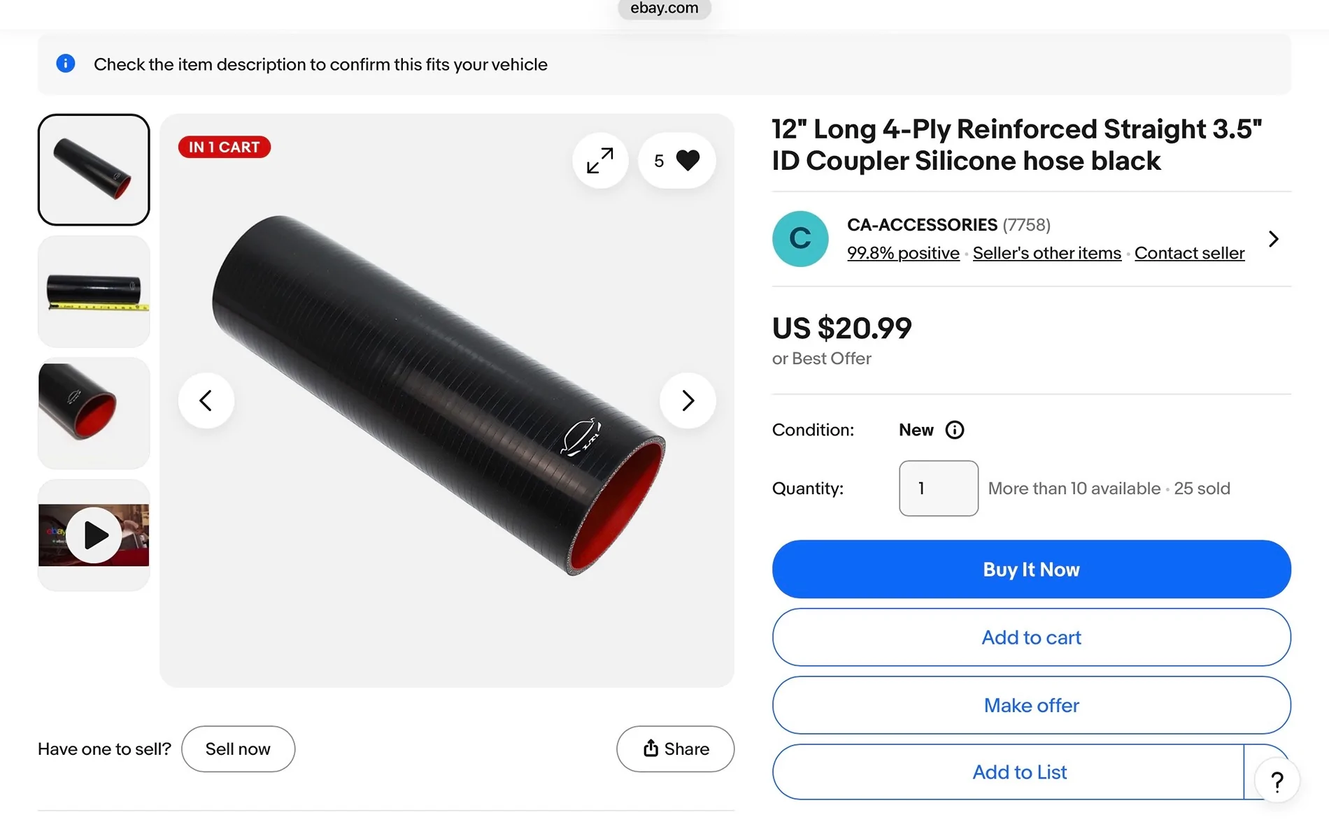

That is really slick! Are there any differences in tubing quality, for example is this OK?: You could get two 6” covers from this….
https://www.ebay.com/itm/164961329905

Do you worry about the tips rusting due to trapped moisture? It does not look as if you drilled drain holes on the bottom. Thanks.
John Davies
Spokane WA USA
I would recommend the high temp silicone tubes. For the small difference in price and not having to cut it's not worth the risk.
I thought about drilling drainage holes but didn't. After 9 months there are no signs of corrosion.

That 12” one I linked to is rated to 500 degrees F. For the $10 I would save by not buying two 6” ones, I am perfectly OK with cutting it in half, and putting the “good” ends to the rear where they show.
