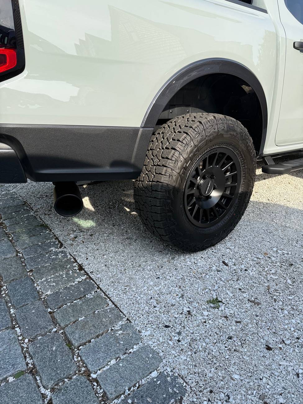

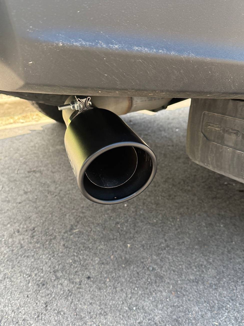

Received my MBRP tip yesterday and can confirm that it fits over the factory tip almost perfectly. I’ll post a pic after I have a chance to get it installed, i.e. when I have time to cut off the factory tube.
https://www.mbrp.com/products/t5196blk

looks good, is that price on there site for a pair or single? anyone know if it fits the oem RR

That‘s the price for a single tip

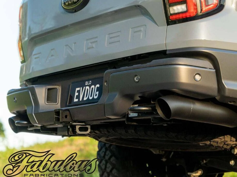

Will that fit a RR? I think because the top gets wider it wouldn’t fit over it. Could be wrong though
when i clicked the link it says it wont fit a 25

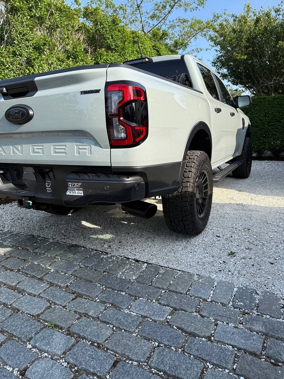

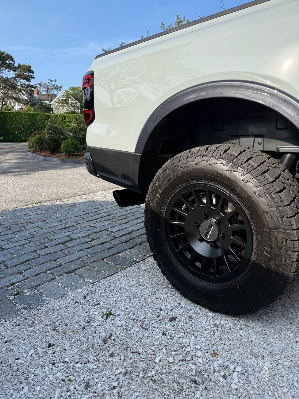

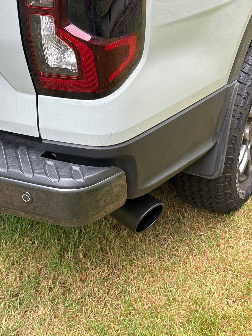

After a couple of misfits because our 2024 Ranger with 2.7 had an OD of 3 1/8 " tail pipe, bought this Ford Performance one from Summit Racing. M-5260-BCT1, about $150. Bought a cheaper MBRP one off Amazon for F150 years back but black finish started peeling off after 1 month. Perfect fit over tail pipe, i did cut off a few inches of tailpipe with saws-all since did not want to see the factory tail pipe and kept it back near the clamp. Real heavy duty and nice black chrome finish for a Cactus Gray Ranger. Easy 10 min install. Still looks new after 9 months.

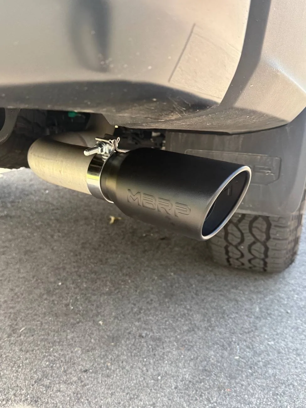

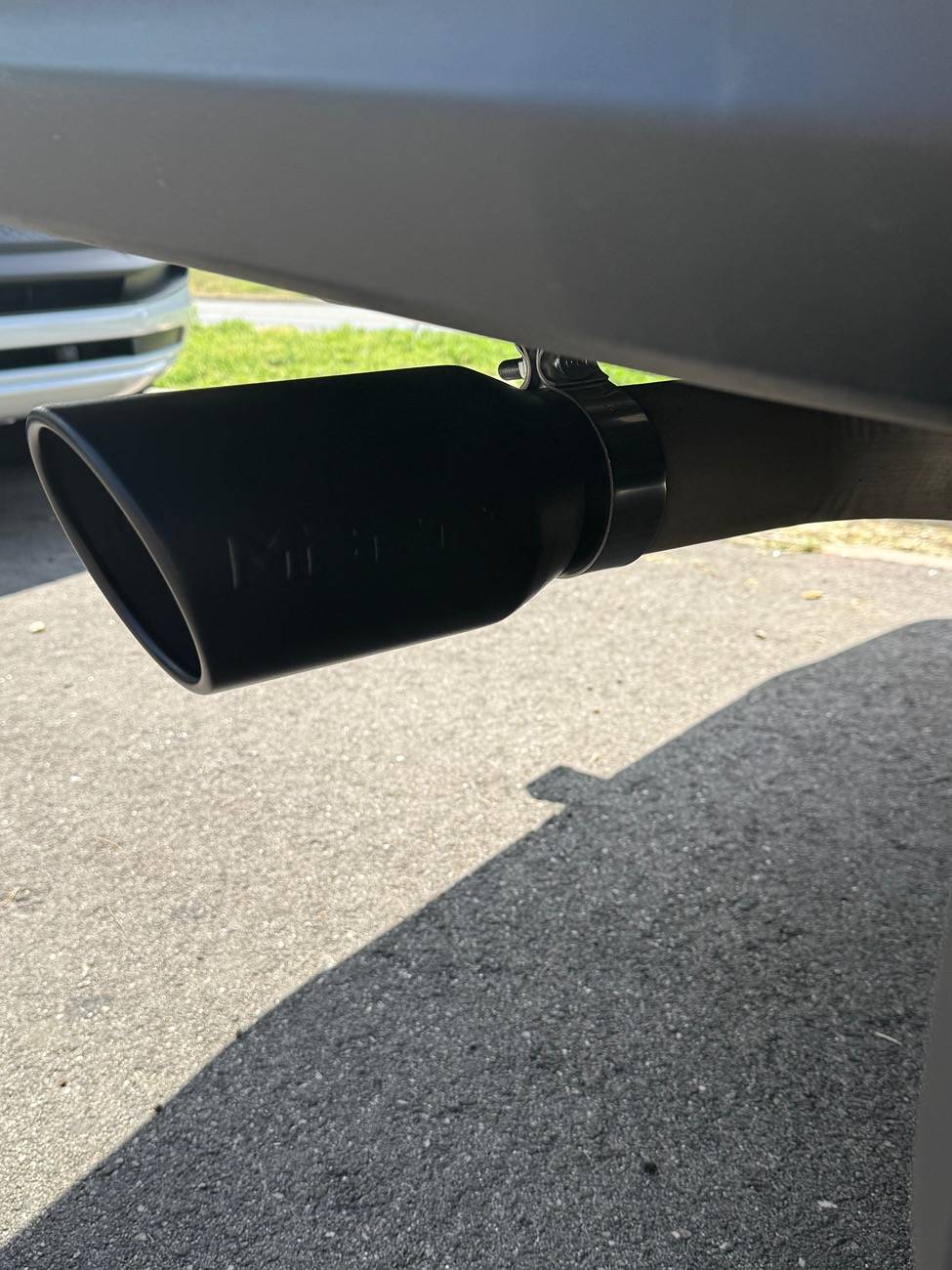

I just installed the MBRP tip and it fits great! I still need to trim off the OG tailpipe so that it's not so visible, but that'll keep until my exhaust pipe chain cutter from Amazon shows up.

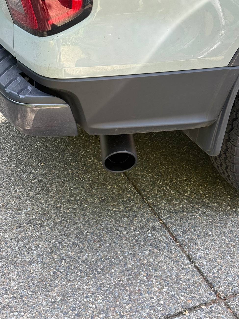

I sprayed my exhaust flat black inside the tip. Barely visible now and if I want to go back to stock, there won’t be any issues.
