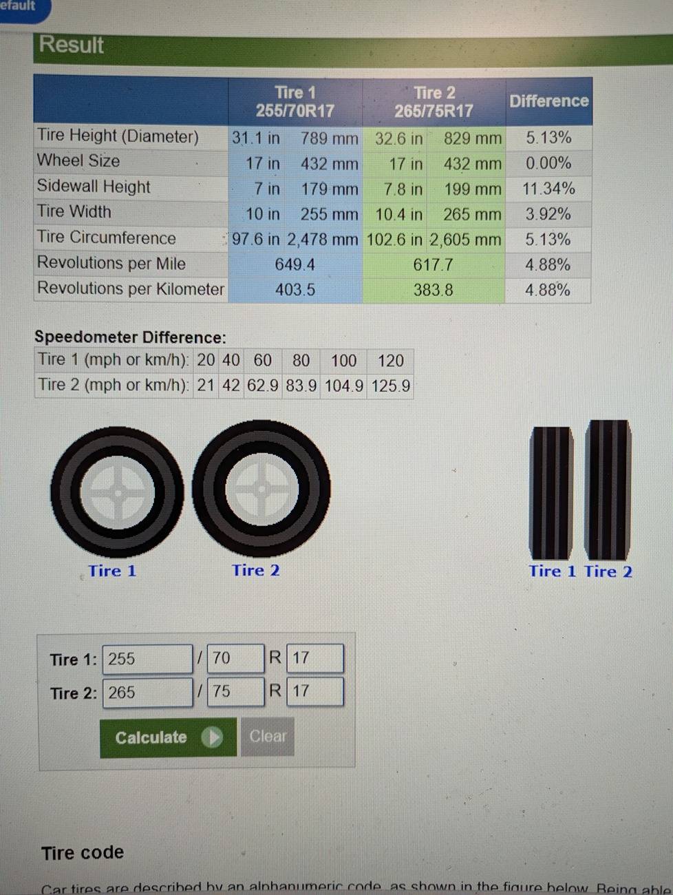

It this the largest tire upgrade on the standard XLT FX4 and OEM rim without lifting and no chance of rubbing? I want higher and wider. Thoughts.
Ford Ranger New Tires - Which size? PXL_20250407_220643528

if you look at my prior post here, I do think that is the largest you can add without any rubbing or lift, best I can tell. Not sure who has done it, maybe they can add to this post for assurance.
