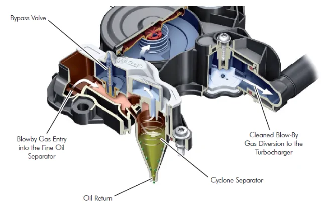

Regarding the VOC's, I don't think a catch can is collecting those on an appreciable scale. All of the compounds you referenced are in a gas form at the temperatures you'll find in an engine bay. And these vapors (and VOC's) are exactly what gets passed back into the intake air for re-combustion, by design.
If we were talking lost quantities of oil that could be detrimental to the engine, returning it to the crankcase might make sense. But vaporized engine oil in the PCV system, while certainly enough to coat intake systems over time, is not generated in large quantities.
This may be true for this platform, but there are plenty of other platforms that see large amounts of oil in the PCV/CCV system. Regardless of the platform, the OE does actually employ air/oil separators already. Difference is that they usually aren't as efficient as a properly engineered AOS. Take this figure, it's a stock AOS in a PCV system for the VAG platform vehicles.
Ford Ranger Oil Catch Can. Yes or No? Screenshot 2025-08-04 212755
Water is a byproduct of the combustion of any hydrocarbon, gasoline being one of them. As you said, water is also a byproduct of ethanol combustion. However, if water were the only vaporized compound in the crankcase, then this theory would hold water, pardon the pun.
Separating the oil from the air was the focus of my statement. The rest of the water vapor and other HC compounds are allowed to continue on for re-combustion. That's how the system is designed to work, even before you add a catch can or AOS.
There are a lot of claims in those two paragraphs but no real data to back them up. Sure, they sound good, but who actually has the research to prove the claims one way or another? Even if every claim is true, my personal preference is to utilize a condensation-based system to remove the VOCs, even if that means I don't catch all the oil. If an AOC system helps you sleep better, by all means, spend the money. It certainly can't hurt.
All of the discussions seem to come down to this. You're going to seek out the truth you desire. All of the information is out there. Countless studies, papers, research data, it's all out there. If it just comes down to a personal preference, there is nothing more to be said.
I think you meant that last comment to be somewhat of an insult to the theory behind condensation-based vapor separating systems, but there's a little more to most catch cans than a thin wall of aluminum. But again, if a soda can catches more VOCs than an AOS system, then send me your empty beer cans, please.
I mean, it's a pretty simple theory, no insult was dealt. I just think you are giving your catch can more credit than it deserves. Like I mentioned before, the temperatures in an engine compartment are elevated above the point where these VOC's will stay a liquid. And no, an AOS won't catch these things, because they are allowed to pass through and be re-injected in the combustion path. Just the way the OE designed them to be.
