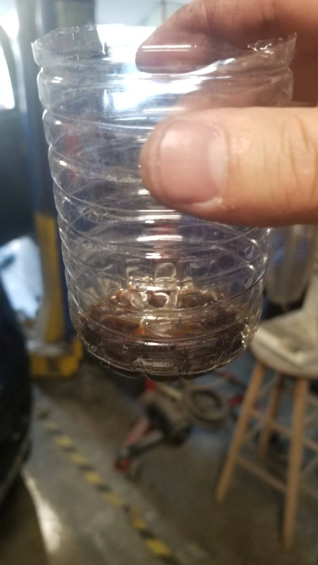

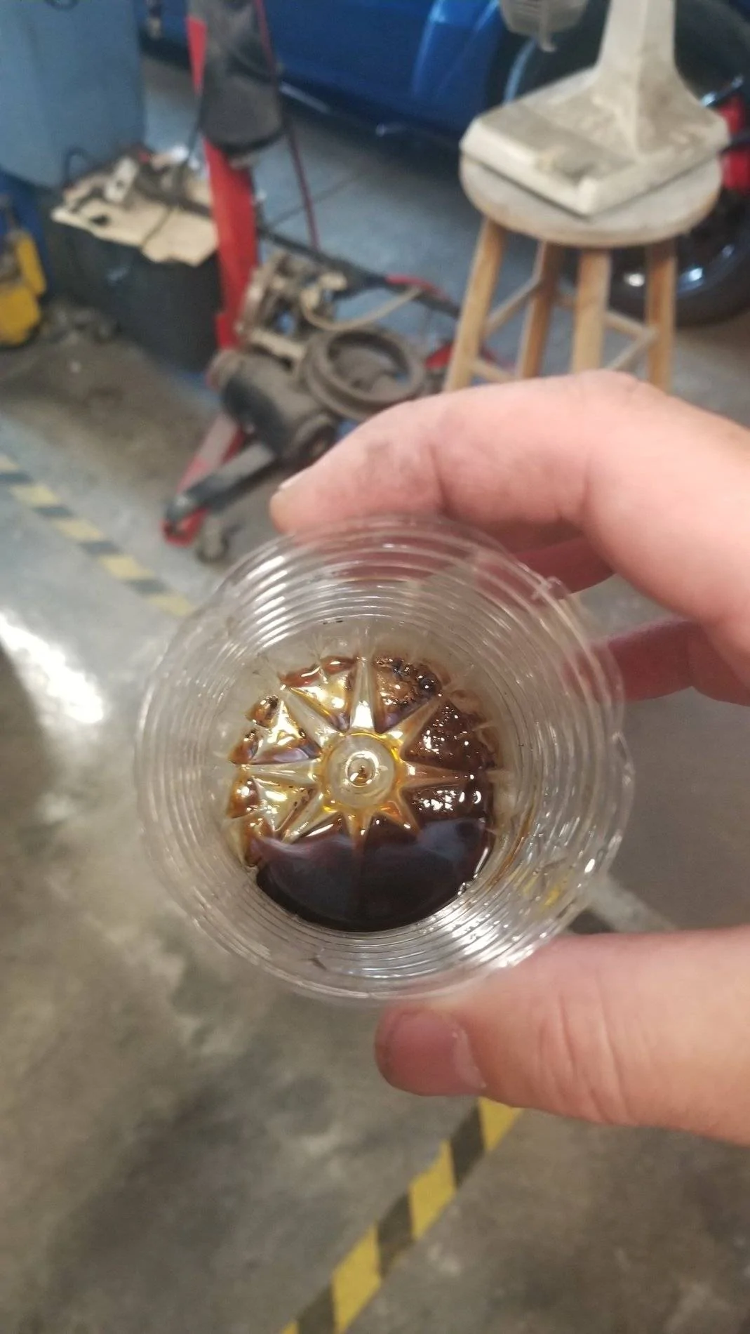

Here's what I caught in about 3000 miles. It's pretty much just oil. Not cold enough for condensation in southern California.
Just curious, which can?

I don't think that's a small amount at all. That's a lot coating you intake and valves and burning off.
Ambient temperature has little to do with crankcase condensation, It occurs much more as the result of very short trips with time between to allow temperature fluctuation.
Thanks for the photos, I see they are open to interpretation especially as to the effect of the volume produced.
Do you think you caught it all? If not, what percentage would you suppose?
If that oil had made it all the way to the intake, considering that it too is designed to separate oil, how much of that oil would have been returned to the crankcase?
What type of driving have you done?
Do you think that different driving habits produce different results?
How much oil over how long will produce enough deposits on the intake valves to affect performance?
Has anyone considered or studied the effect of the EGR strategy?
I have not yet met anyone with the complaint, on any EcoBoost, 3,4 ,or 6. Has anyone here?
I realize that would only be anecdotal, but it might at least add credence to the issue, provided some of the above questions were answered.

The post can side is pretty dry. So, it catches almost all of it. Anything in the intake goes right into the combustion. There's no way for it to make it back into the crankcase. I do mixed driving for around 30 miles round trip. And a trip from LA to Phoenix and back. Either you're pulling it in through the pcv or the "breather" side when under boost. I've routed it to catch on both. So, if you drive it harder you'll probably pull more through. I'm pretty light on the pedal despite being mod heavy. I'm of the thought that an engine should not have oil introduced into the combustion at any point. Spending less than $90 on the one I put together is more than worth it.
I agree, any amount is bad, it's just a lot less they you typically see in most videos and reviews for similar mileage runs
