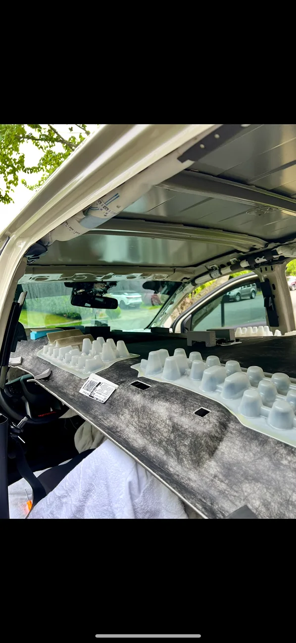

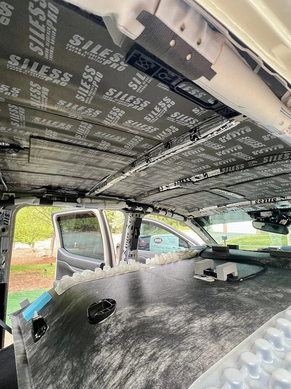

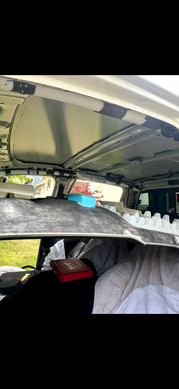

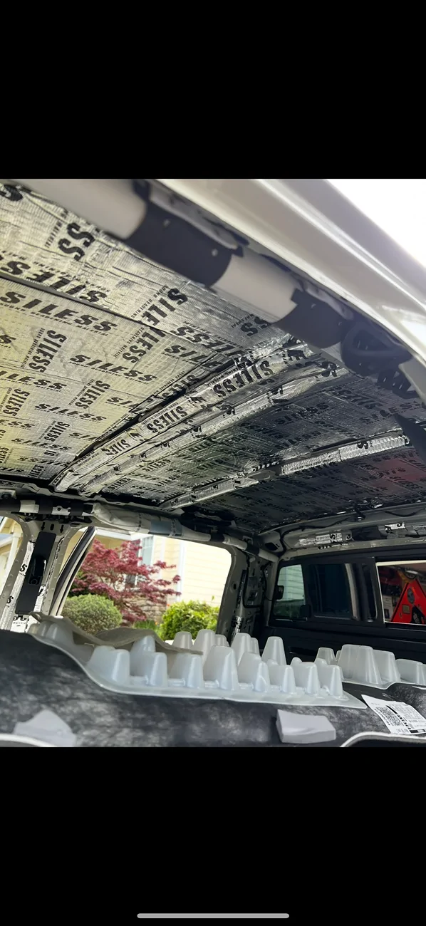

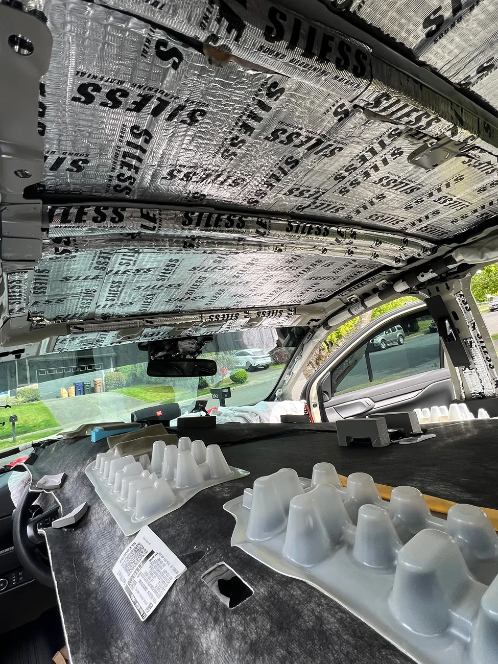

Time to sound deaden & heat deflect the roof! Did it myself couple months back. Worth its weight in GOLD! Both for sound (roof is beyond tin can-ish) and heat dissipation. Dropping the headliner isn’t as bad as it’s made out to be if you’re careful & methodical (about an hour each way). One of the best things I’ve done to the interior along with SD’ing the doors as well. Both the doors and the roof have 2 differing layers applied. The 1st being 120mm foil backed mastic then multiple layer hybrid over top. Did it over a couple weekends. Gets you familiar with the interior of these trucks.
