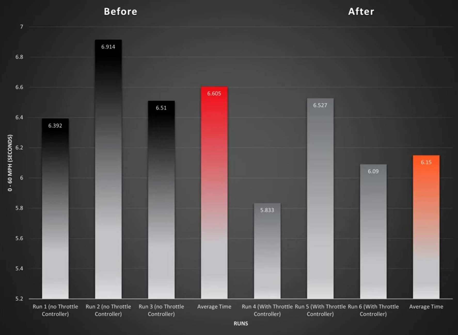

They absolutely do work and anyone who tells you otherwise doesn't know what they're talking about or doesn't know how to use one properly.
Ford Ranger Pedal Commander Screenshot_20250427_150519_YouTube
Lmfao. A graph with absolutely no context. What vehicle?. What altitude?. Parameters. Who tf cares. Bet you sell em overseas 5o chumps.
