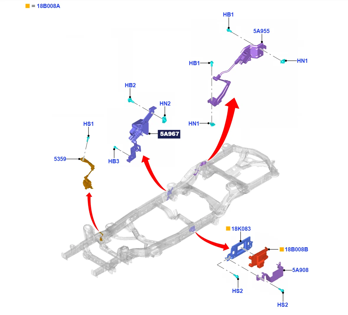

So, what's the purpose of ride height sensors? Does it adjust something in steering or suspension, or is it just for automatic head lamp adjusting?
Ride height sensors are a super important part of the dynamic suspension and computer control - with a broken or F'd up one the suspension modes, steering modes don't work and your ride will be all F'd up.

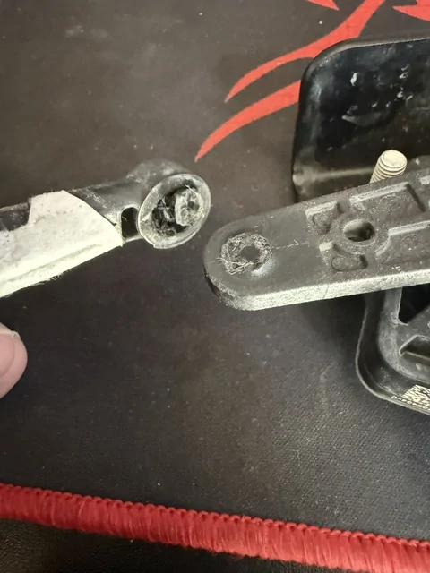

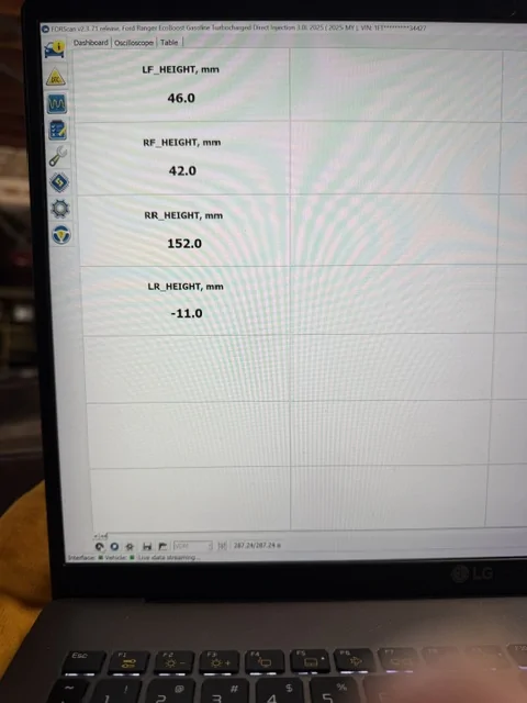

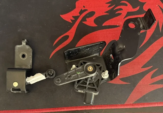

So I did the 2:1 spacer lift on my 2025 Ranger Raptor. I did the front myself and all came out fine. I was too busy with work to do the back so I paid someone to do it. I then got new 35" K03's mounted on Bronco Sasquatch wheels I picked up. All good so far.....I then went to set the new ride height VDM in FORScan. When I went to do this it showed some crazy settings for the rear (see photo) and threw a bunch of errors and now I have a service error on the dash. Long story short, I found the culprit. The right rear ride height sensor got broken somewhere between the guy I paid to do the rear spacers and Costco mounting the new wheels/tires. Not sure who to blame. So. I am stuck buying a new sensor (Pt# MB3Z5A967G) at a cost of $180. My anger at Ford stems from the fact that the FU*KING arm on the sensor is made out of PLASTIC!!!! WTF!?!?!?!?!?! This thing hangs pretty low on the truck and is susceptible to damage and being plastic sure doesn't help (see photo). I just got back from the Ranger Raptor Assault in Utah and even asked those guys "why the hell is this made out of plastic"? They simply said, "those Ford Engineers can be a little crazy"
What a nightmare.! Hopefully the part will be here by Friday and I can get back on the road with the VDM set and all working.

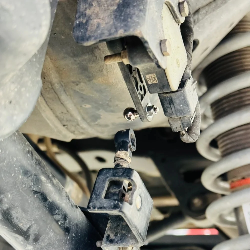

Why dont you just replace the ball stud with a stainless unit?
GOAT Ride Height Sensor Pivot Ball Upgrade
Note that Ford already uses a steel ball on the lower part of the sensor arm.
To install that you drill out from the back side the molded in pivot ball and thread that one in.
In order for that to fail, the entire arm would need to snap rather than just the ball stud.
Btw maybe someone in the US makes the same thing or you can find the ball stud size and order one.
Heck maybe 1/5th scale RC ball studs might even work for upper links, you can find stainless ones at hobby shops.

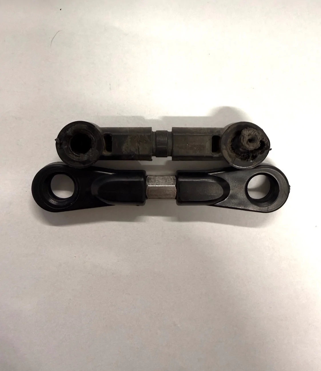

Do you have a calipers you can measure the ball stud diameter with?
Might be worth saving the broken one and installing a ball stud in it for a spare. Thats basically what im recommending.
But as others have said, ive yet to see one break during use. Its always because people doing lifts forget to disconnect them so far! Id make the mechanic reimburse you, he should have been diligent enough to know that, all Raptors have ride height sensors now and many other vehicles do too.

Ya, thanks for the info. I actually not only ordered the metal ball kit from GOAT yesterday but also ordered new extended arms from them that is made for a Raptor with a 1” lift in the rear and 35” tires. I’ve already ordered the entire replacement sensor assembly from Ford. I had over $85 in points from when I bought my ProCal Tune from Ford so the part is costing me approx $100. I will have the metal ball kit and the arms if this ever happens again. I wish I could blame the mechanic and make him pay but I have no proof. I’m pretty sure that’s he is the culprit but live and learn. It could have been Costco too. IDK
So now, any future work I have done or any place I take my truck for anything, including the dealer, I will point this out prior to letting them have the key; Including taking photos before.
