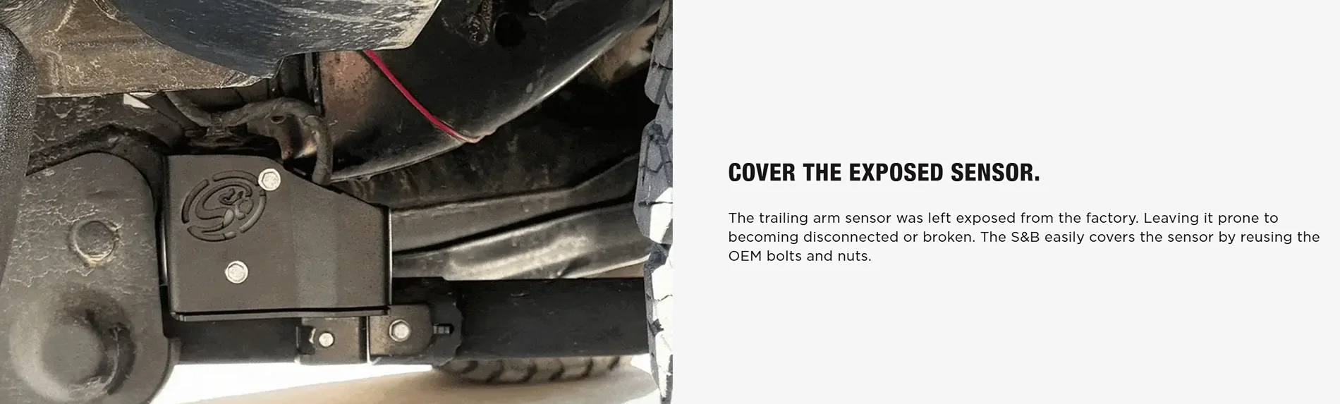

good insight! I am very curious to any and all that have the sensor cover if they have broken theirs or even heard of one breaking due to off-road driving… I don’t doubt the possibility, but the only evidence I have seen of a failure is the buckleup video driving it through a Florida swamp and it detached.. or am I thinking of a different sensor?

The location of these suspension sensors is almost as idiotic as the trailer light/brake plugs.
First upgrade I did after buying mine & researching these things was the armor for the sensor.
Now I just need the confidence to cut into my plastic trim to relocate the trailer plugs.
