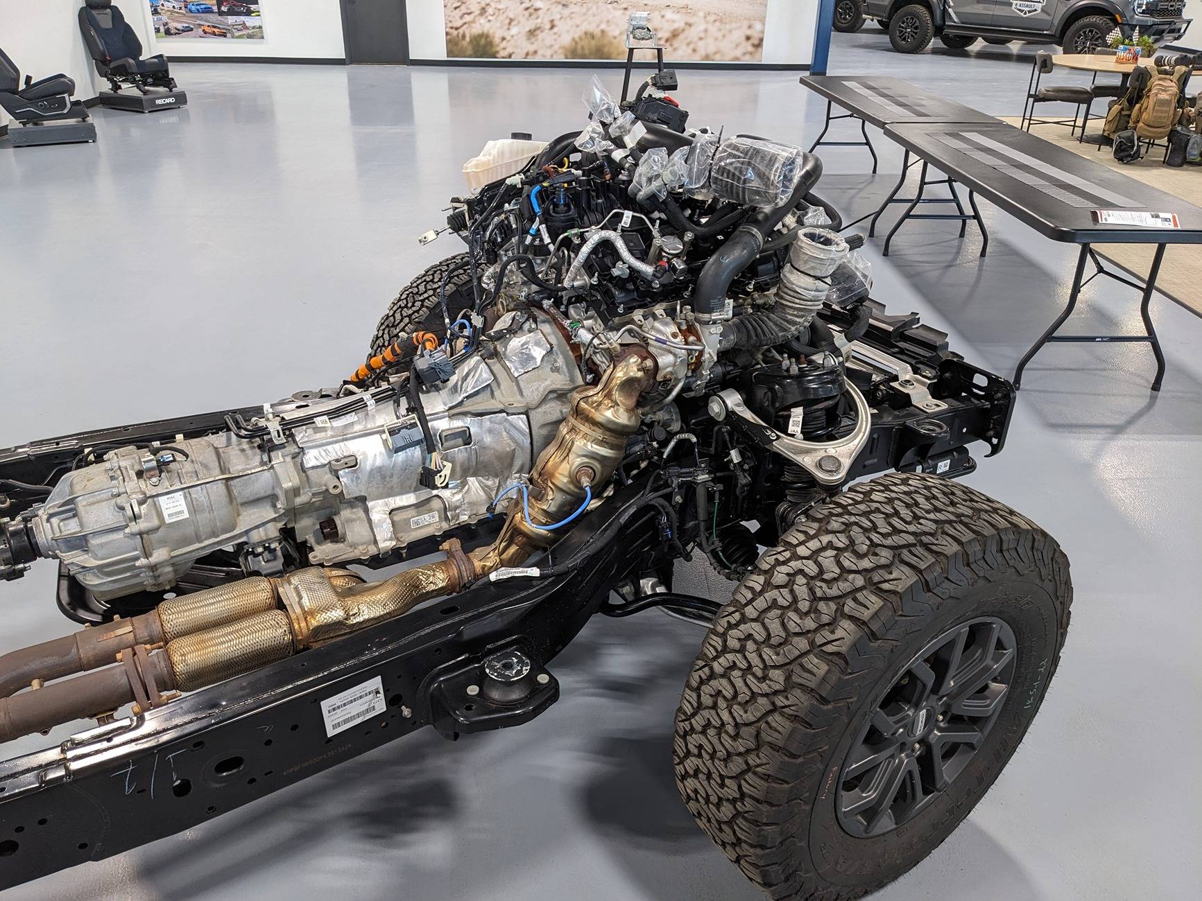

I did the same parts catalog exercise and all signs pointed to DI only. You can't tell by looking under the hood without a borescope, credit to @Bmadda for taking pics. When I was at Raptor Assault a few weeks ago they had an RR chassis in the lobby, so I snapped some pic, no port injectors..

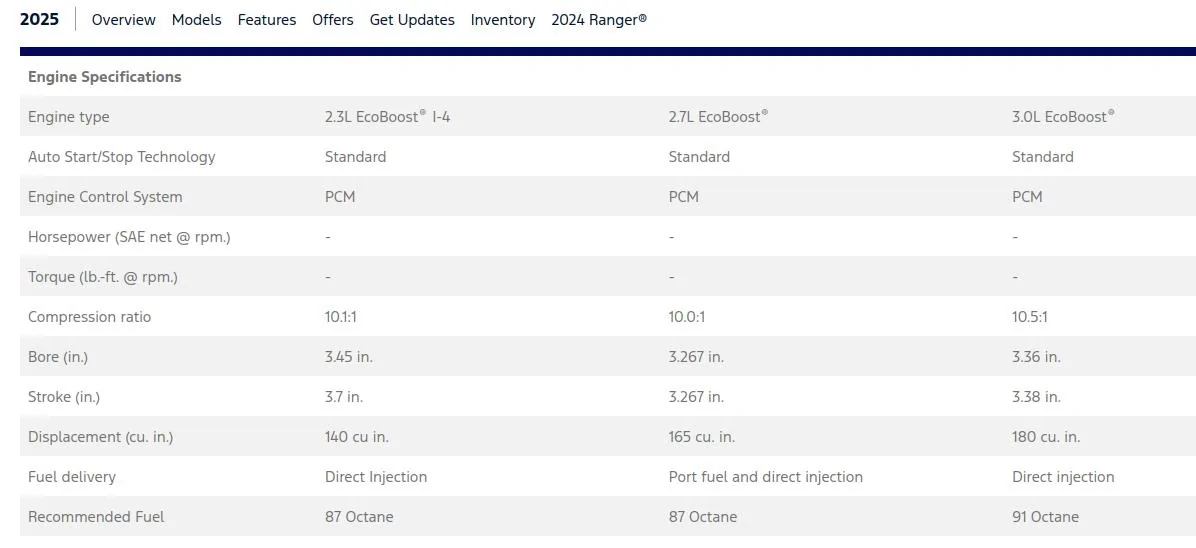

I got this off of FORD 2025 ranger specs about the injection:
I'm sorry about that. This is correct. The 2.7 is both direct and port injection.
