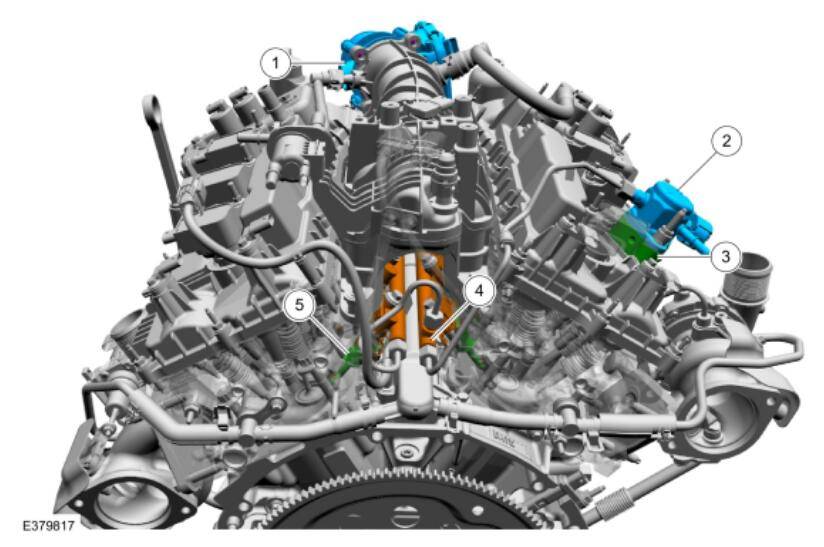

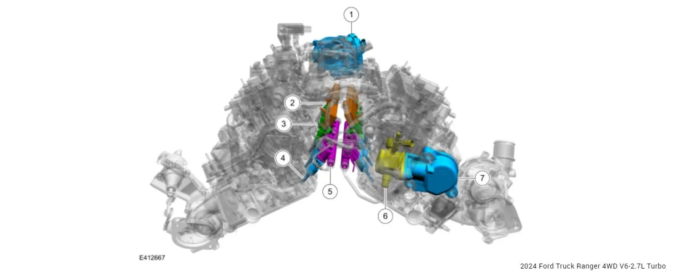

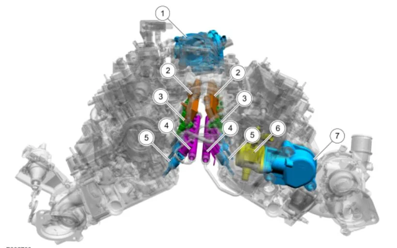

Parts manual pics 3.0L vs 2.7 (which is where the confusion started)

What I posted above is the fiche for my VIN. The 2.7 Pic is for a 22 Bronco. Neither Braptor nor RR has the port/DI. Just pop your hood dude!

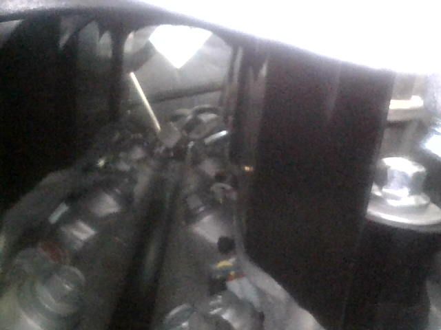

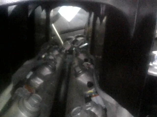

appears that Ranger with 2.7L has DI and port. RR does not tho, and neither does Braptor
Ford Ranger Port and direct injection rngr27fuel
Actual pics underneath my manifold from borescope...count em!
Ford Ranger Port and direct injection 20240920121247
Ford Ranger Port and direct injection 20240920121255

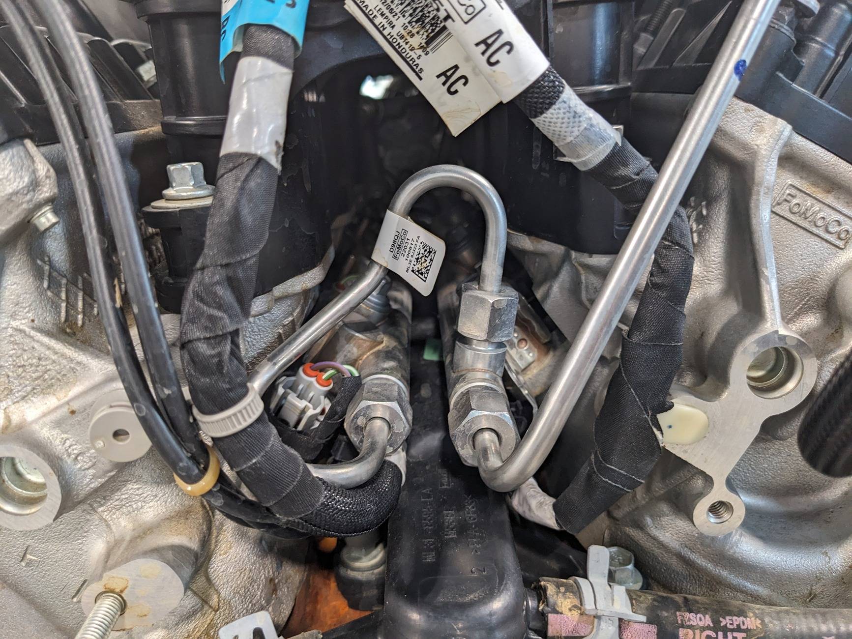

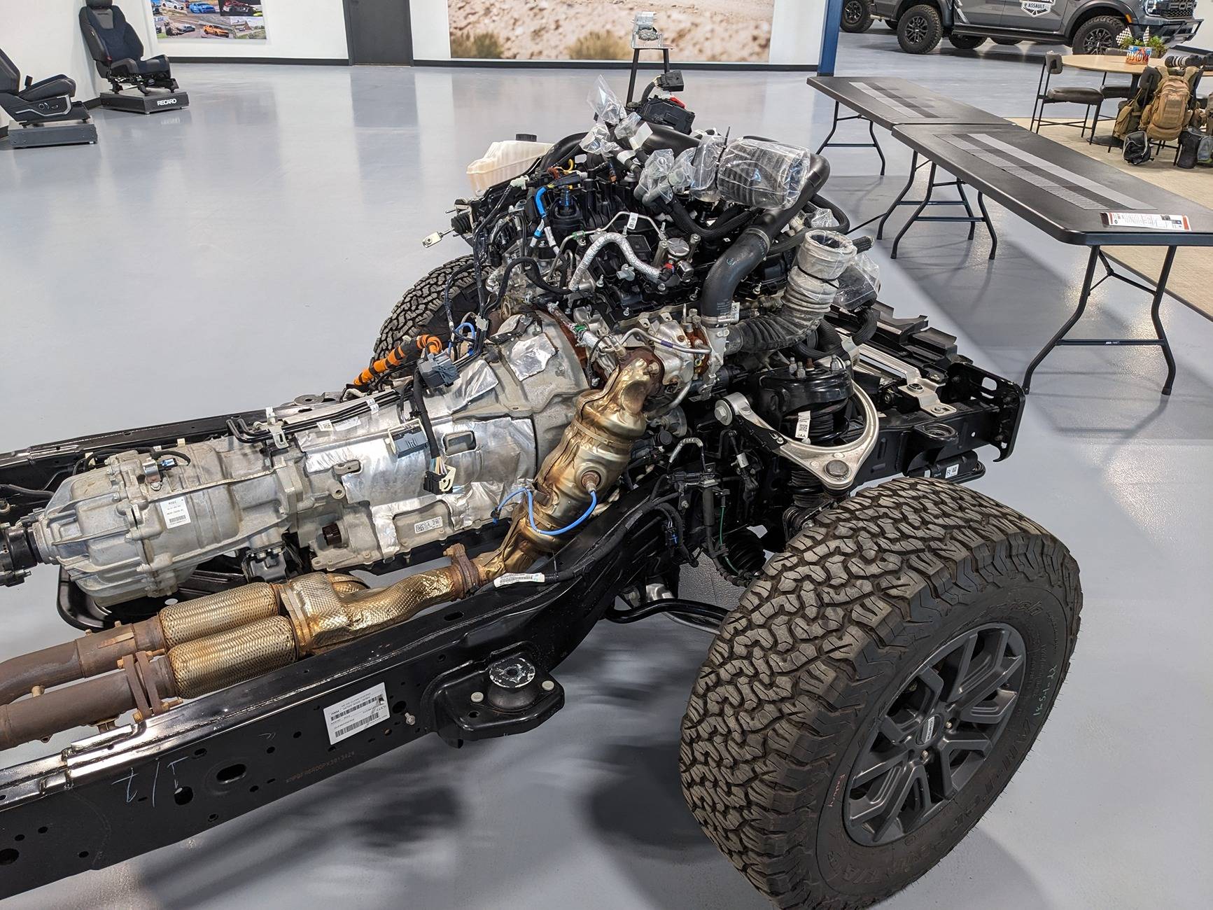

I was in denial for awhile too, but unfortunately the 3.0 in the RR is DI only. It is frustrating that Ford has let this typo persist for so long.
I did the same parts catalog exercise and all signs pointed to DI only. You can't tell by looking under the hood without a borescope, credit to @Bmadda for taking pics. When I was at Raptor Assault a few weeks ago they had an RR chassis in the lobby, so I snapped some pic, no port injectors..
