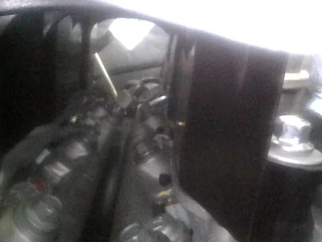

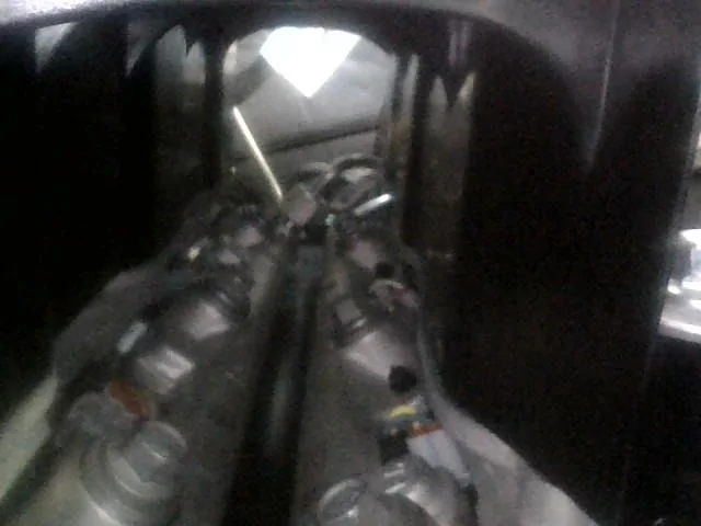

I would like to see photos because this is a downgrade ford made from the 2.7 engine and the 3.5.
I had the idea that the 3.0 exoboost would be a reliable work horse. . And missing Port injection, probably Will make it a low reliability engine.
Are there know cases of carbon built up?
Here is the thread these are from I did the heavy lifting for you! 🤪

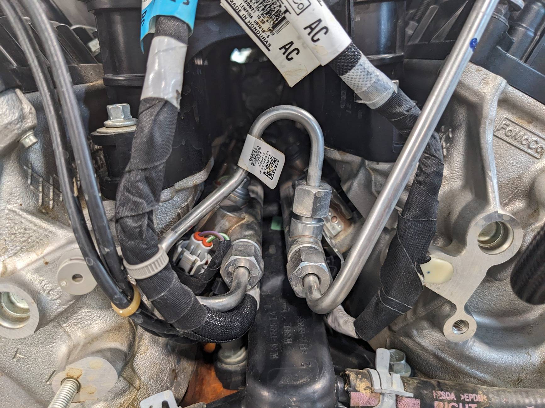

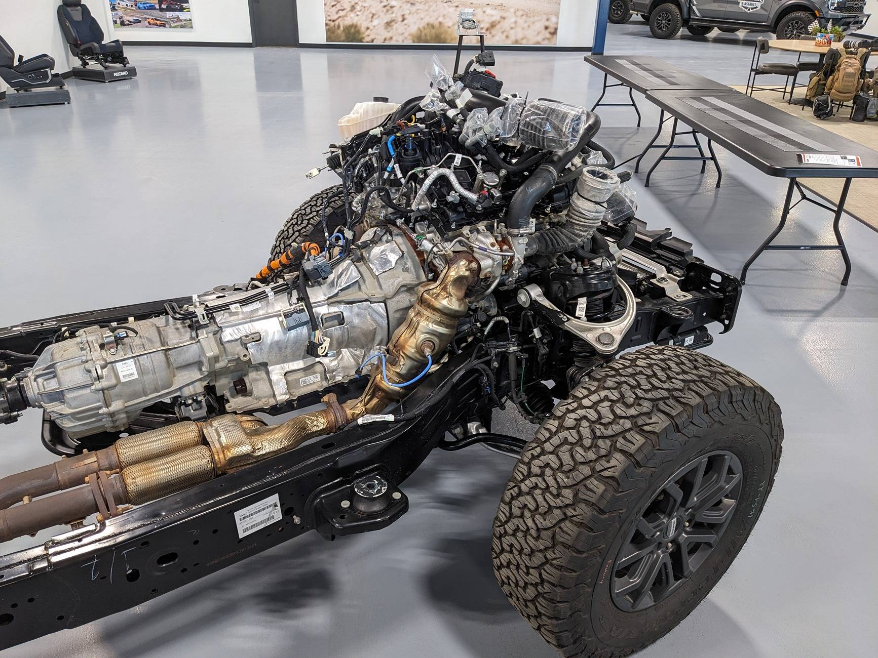

Iam a bit speechless having in consideration this engine is in production since 2016 and there is not an exploded diagram of the engine, and other information based on technical information. .also engine revisions etc 😱
There are exploded diagrams check this old post it’s all in there.
Direct and port injection.

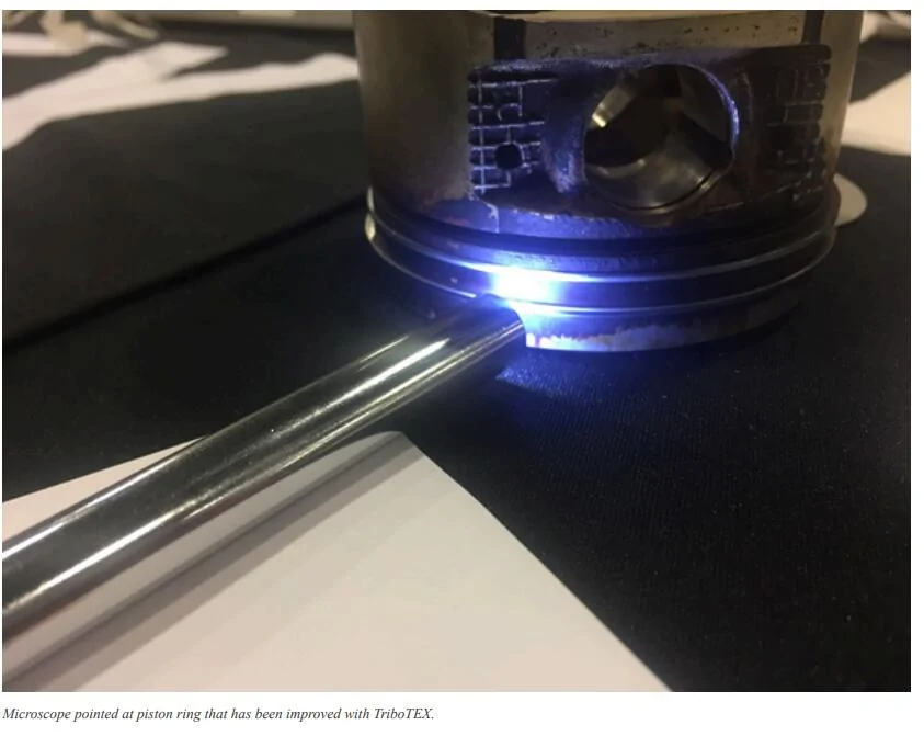

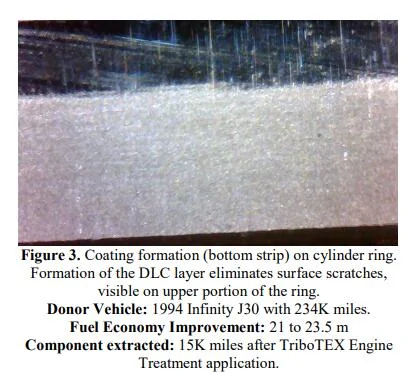

Going to make my plug again for In Situ DLC films: Informational - Science / History Behind In Situ DLC Coatings for ICE and Transmission / Gearbox Applications | Ranger6G - 2024+ Ranger & Raptor Forum, News, Owners, Community (6th Gen)
It's a well proven fact that that synthetic MSH forms on piston rings and enhances ring seal and achieves a traction coefficient of about 0.01, which is the theoretical lower limit of lubricity:
Ford Ranger 3.0 eco boost engine intake valves and direct injection! 1755779481392-qt
Ford Ranger 3.0 eco boost engine intake valves and direct injection! 1755779489724-mv
Almost all of your oil vaporization occurs in the upper cylinder group where the oil lubrication of the cylinder walls is very limited. The oil is also not replenished as rapidly as it is in the journal bearings because there's no continuous pressure behind it, it's just sprayed under the pistons and on the walls as a byproduct of oiling the wrist pin and cooling the piston via oil squirters if so equipped.
So that's where nearly all your vaporization occurs and it's also where over time, as the rings wear, more oils get past the rings into the combustion chamber. Vaporized oil 1. dilutes fuel octane and causes the ECU to retard timing 2. Poisons your catalyst 3. Cakes the intake valves. 4. Fouls plugs and finally 5. Over time can cause stuck rings that no longer float in the grooves due to excessive sludge buildup (do a search for Valvoline's oil test between synthetic and blended oils in two Ford Explorer 2.3L EB's, there's substantial difference over time).
That's why I 1. use only OE style paper air filters as they have better filtration to avoid caking the intake valves and upper cylinder groups with fine dust 2. use synthetic oils as the synthetic base oil has lower vaporization rates than blended base oils 3. Use TriboTEX In Situ DLC films as part of regular maintenance to promote ring seal, reduce ring wear rates and reduce localized friction heating at the ring / cylinder wall contact points, which further reduces vaporization (as well as blow-by on cold starts) as a multi-pronged strategy to mitigate GDI intake valve buildup.
Finally, maybe at longer intervals, maybe 50k to 100k, periodic intake valve cleaning. 99% of this stuff you can do yourself as part of regular maintenance.
