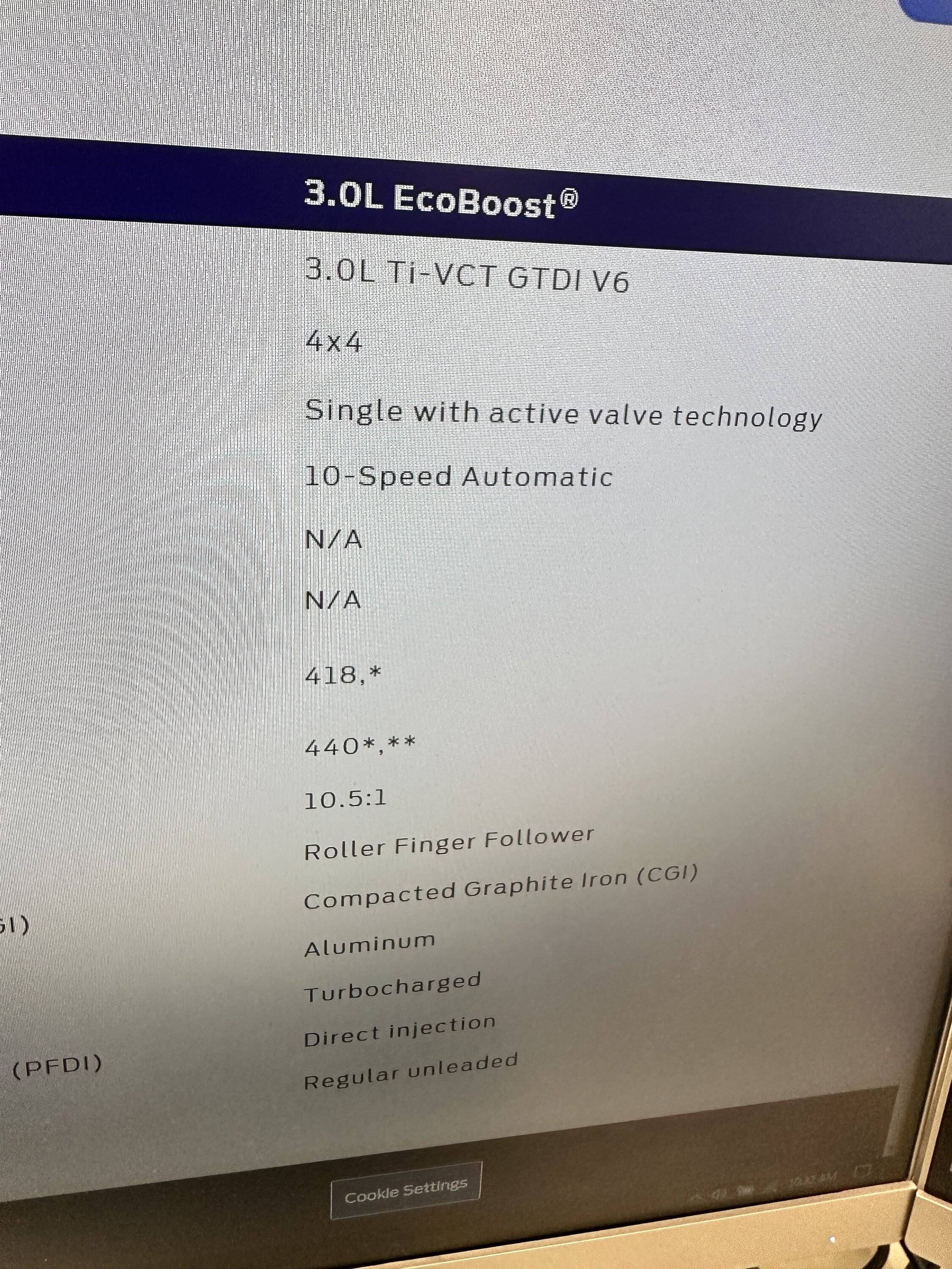

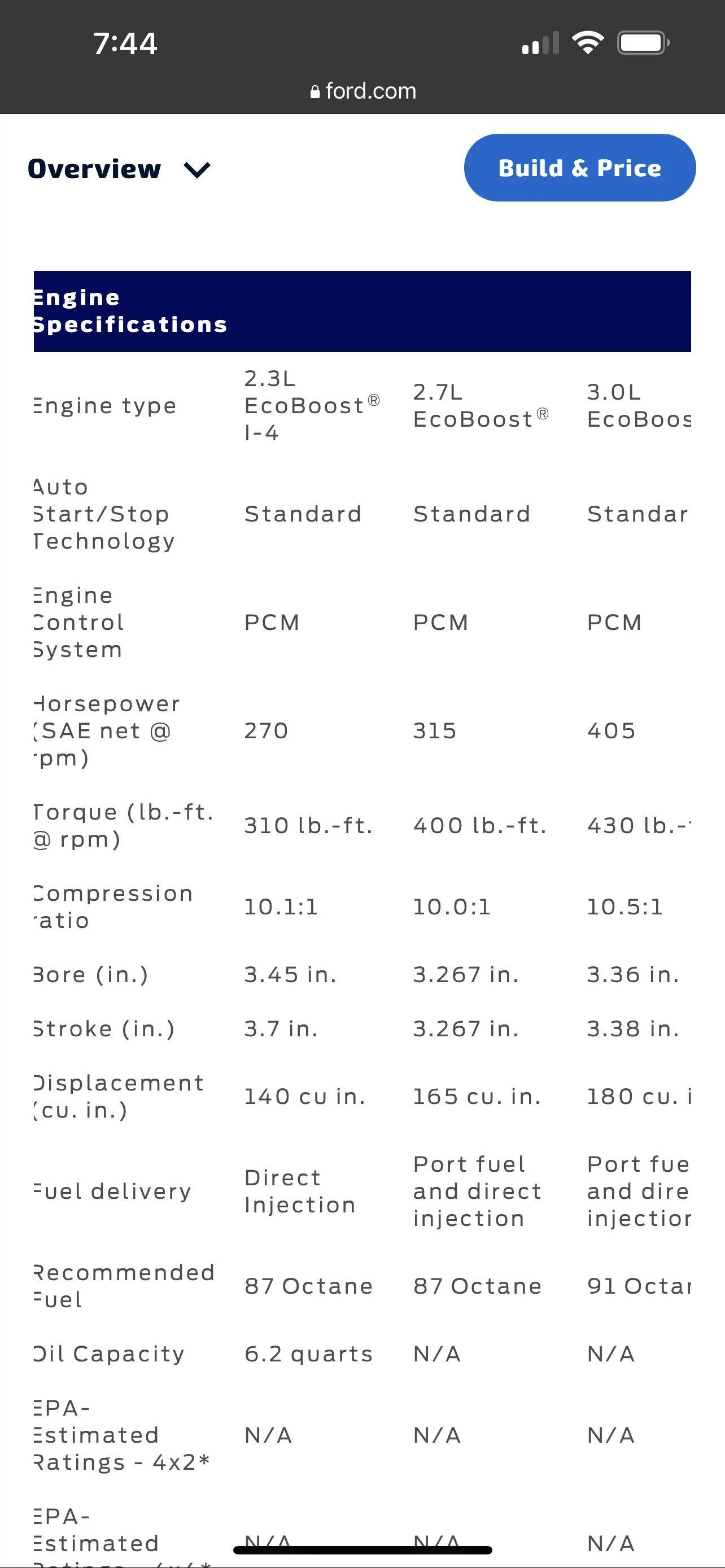

Because the part number is the same between the di heads and the di port fueled heads. Honestly, you cannot be this unintelligent. Having a single design is always less expensive than having (evidently) at least 3 designs that accomplish the same thing.
We know the following for certain: there was a substantial change to the head design on the 3.0l nano between its inception in the Lincoln lineup to its installment into the bronco raptor. The head is a completely different casting between the damb and rff valve actuators. The inclusion of port injection on a head that not only has di, but already has port injection prep built into the casting would be a trivial process change at longblock assembly. It makes more sense for Ford to consolidate the design into a single product rather than continue to have at least 3 variants of the same displacement engine with the same name.
How does a DI head differ from a PI head? If they are different how can they have the same part number? Are you talking about casting numbers instead of actual part number of the finished head?
Just asking as I got lost somewhere along the conversation.

There's different ways to implement Dual Injection. Some companies double up on injectors, so there the direct injectors that spray fuel right into the cylinder and there's a 2nd injector for each cylinder placed right at the end of each intake tract (port) and they use either / or depending on RPM and Load conditions to maximum benefit.
Some companies like Subaru, use 5 injectors for example on their 4-cylinder engines. There's just one single injector in the intake manifold further upstream shortly after the throttle body and its only purpose is fuel washing of the intake values. The other four go right into the cylinder like all other DI. That method is certainly cheaper and less complicated, but ONLY provides that singular benefit of cleaning the intake valves via fuel washing.
The dual injector method where there are two injectors per cylinder provides multiple benefits: 1. Fuel economy at lower load and rpm conditions and 2. fuel washing of the intake valves.
