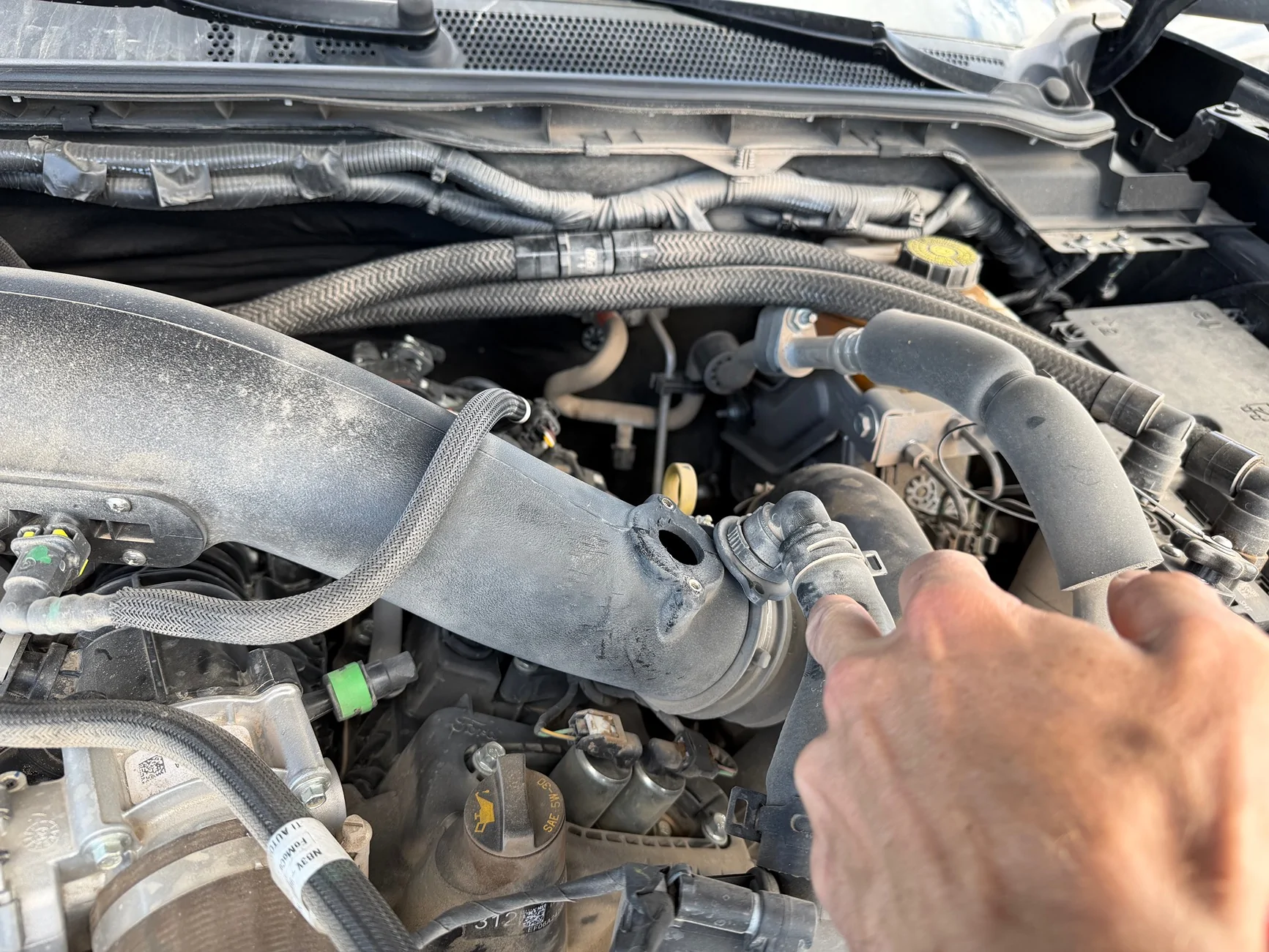

Hey did you ever perform the smoke test? I stopped by @Goosetuned at TRR and he told me to watch the boost level after 3000rpms. I saw it hit 17psi on the start of the long course. Then by Saturday I thought I blew a shock or something but the BOV was so loud… after running the third (mid length, and most fun) course, I popped the hood and noticed this:

Those plastic bits stink when raptoring the raptor. Look at the Process west crossover. IT's the best
