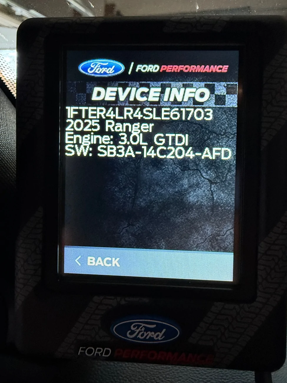

Hey, I know this has been posted before ( I can’t seem to find it). I had my procal installed at the dealership just after break in on my 25 RR , so this is the first time I have pushed the truck but I noticed everyone saying they are getting 24-25psi of boost, the most I have gotten is 17, and before anyone asks it has been installed for 300+ miles, my question is it installed and if so properly? Thanks in advance

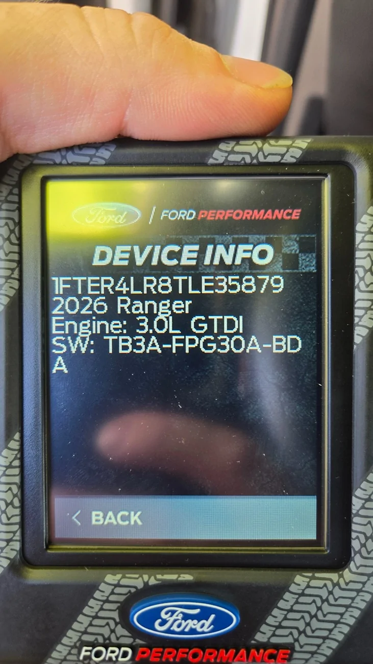

I assume you have the programmer? Plug it in and read the ECU version. There will be an "FP" in the middle indicating the tune is installed.
Something like SW: RB3A-FPG30A-JF

My guess is they didn't bother to read the instructions and just plugged it in.
You could do the flash yourself but if you want to be damn sure to keep your warranty I'd take it back and make them fix it.
this. looks like the stock file.

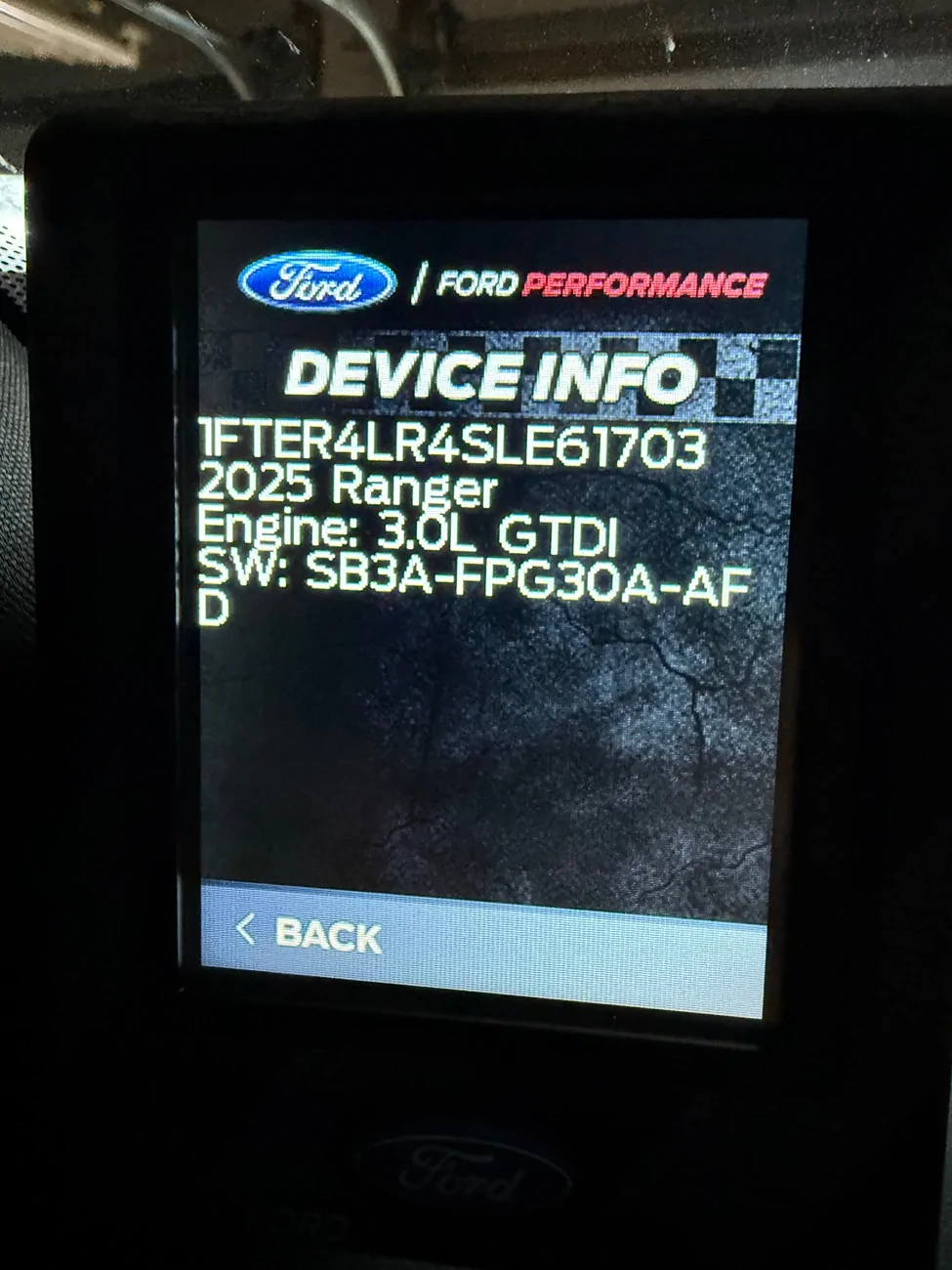

Going to try and install the performance tune and see what happens

Yes, that looks more correcter... :rockon:
