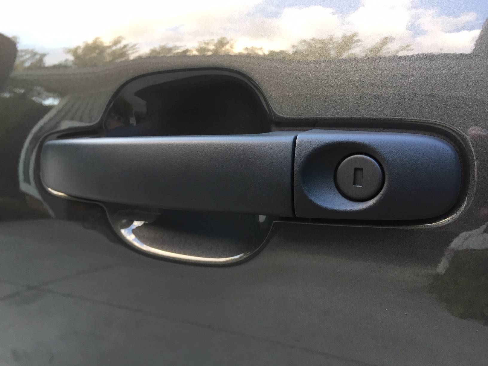

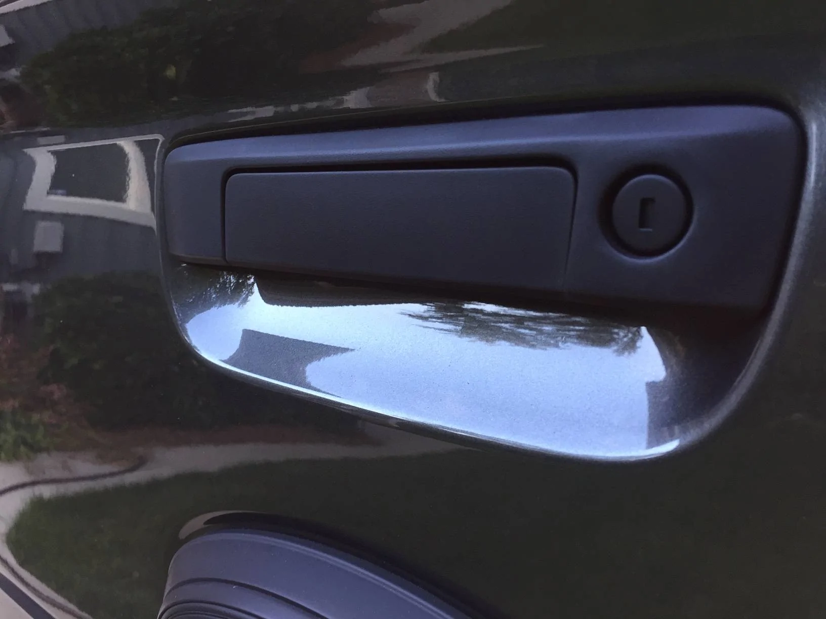

That nasty unfinished bright key hole is dead...once you've noticed this bright spot (that you'll never use), you'll never un-see it...clean it with acetone, mask and paint flat black:like:
Driver door:
Ford Ranger Project Msfitoy V3.0 1Iq0r2
Tailgate:
Ford Ranger Project Msfitoy V3.0 bk48L0F

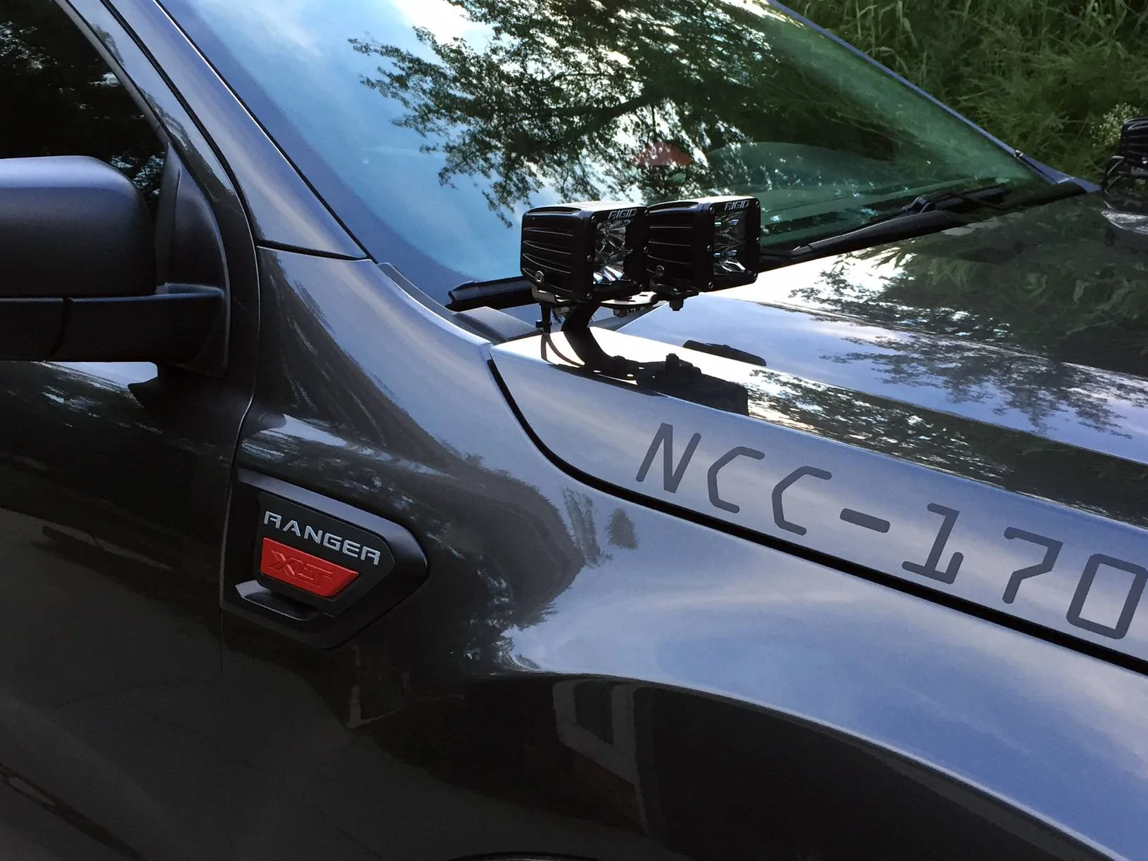

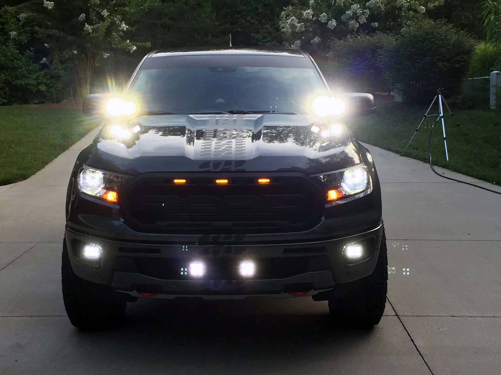

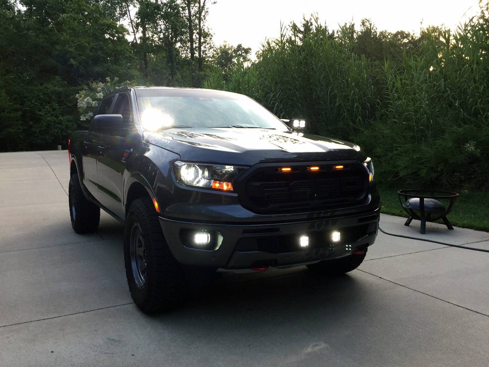

And the LED pods are complete...two pairs of Rigid spot and flood up high, Procomp spot in the grill and Diode Dynamics in the headlamps:like:
Ford Ranger Project Msfitoy V3.0 1mJnxSX
Ford Ranger Project Msfitoy V3.0 ySHUcBa
Ford Ranger Project Msfitoy V3.0 63cTcl1

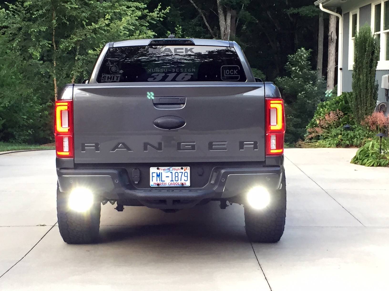

And trail floods to cover the rear...I'll have them amber lens later...
Ford Ranger Project Msfitoy V3.0 eArd42f
Side floods on the list after I manage a Diamondback with RTT racks and rock lights should complete the lighting...

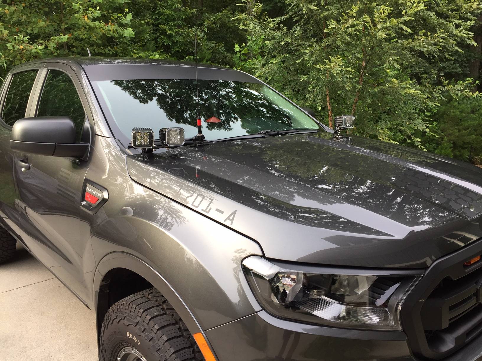

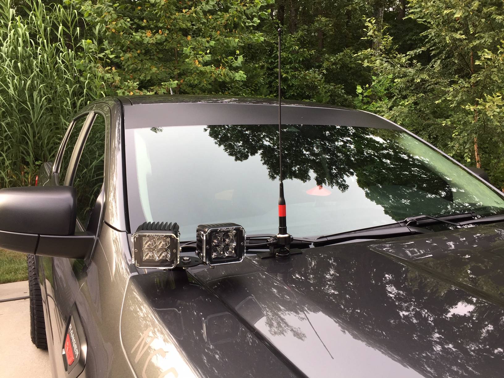

Eibach Pro Lift coming tomorrow and I can't wait! I'm working on getting my shortwave licence and in the mean time, the antenna has been set. Now I need to sort out how to get the coax cable head through to the cab in a smart manner...
Ford Ranger Project Msfitoy V3.0 mHKbtyM
Ford Ranger Project Msfitoy V3.0 8Id88QV

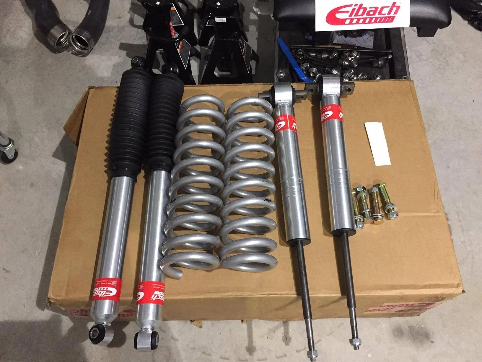

I've been a very patient boy...and so far, I am not disappointed...3 month after my order, the Eibach Pro Truck kit is in my garage:like: :)
Ford Ranger Project Msfitoy V3.0 9jUuAVP

My front struts should be in Thursday. You lifting to the max adjustment?
Msfitoy
Msfitoy
Sid
Mar 5, 2019
1,964
918
North Carolina
2003 MINI Cooper S Modified
Big Toy Designer
According to the instructions for the Pro Kit (which is poor and none specific to Ranger), they recommend using the lowest ring which would provide 3" lift or second ring providing 3.5" lift. The fourth and fifth if a no go with Eibach spring and would damage the suspension. I'm going with 3".
