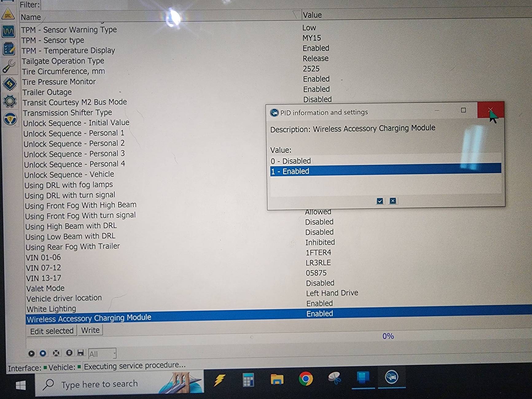

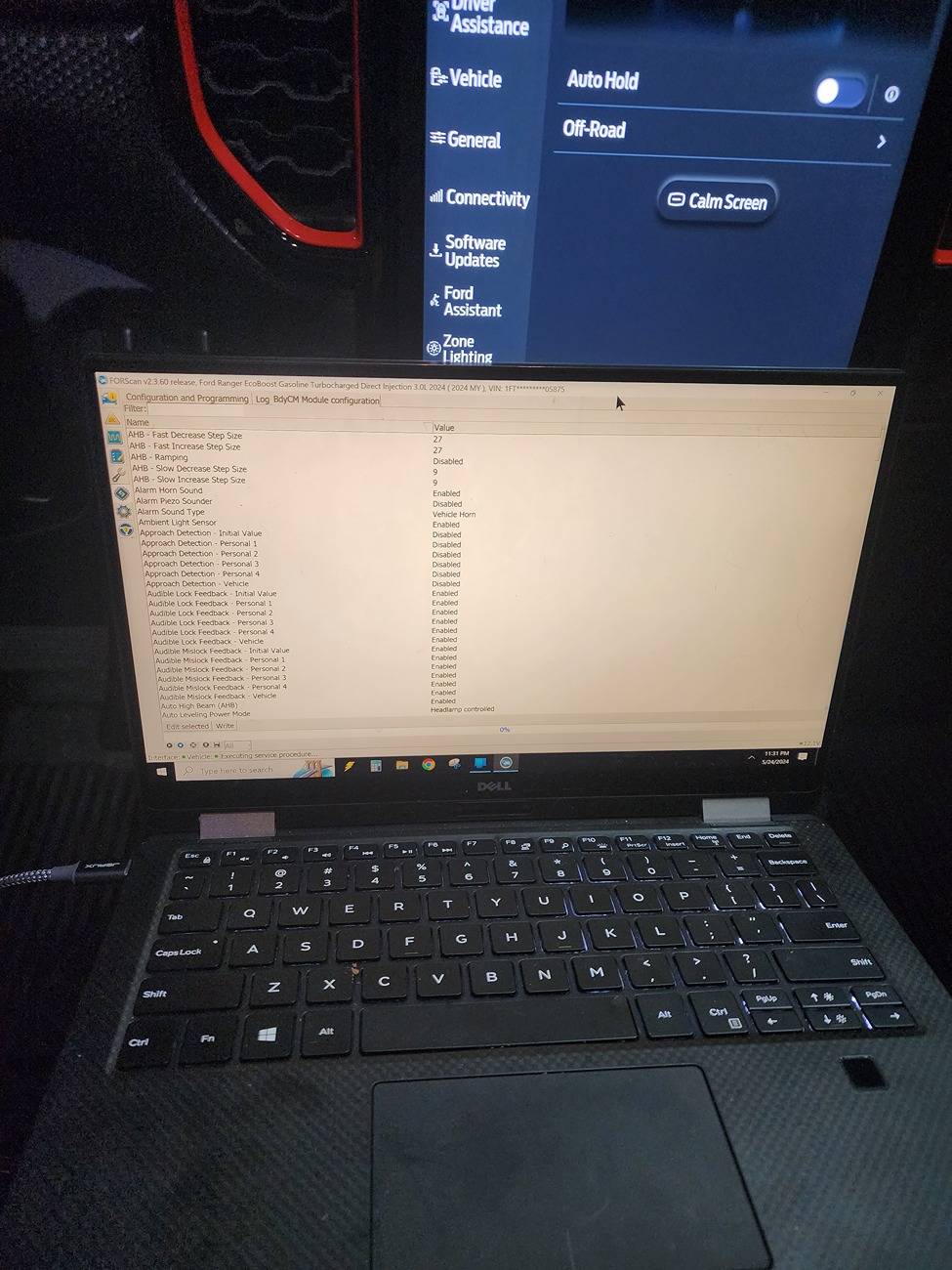

Couldn't get Android Demo to work. Couldn't establish a connection. Don't have a BT OBD2 dongle so used the USB cable I used for the laptop but no dice. I have a Samsung Galaxy S22 Ultra so not sure if it's a phone issue, cable issue, or app issue not recognizing MY24 Ranger.
I did get the laptop to read modules and tested a write to allow fogs on with high beams- that worked so I'll look at doing other changes later. A lot of stuff on the modules including AS/S and chimes but I've read newer models aren't successful at disabling some of those things. But it's in there for anyone who wants to try.
