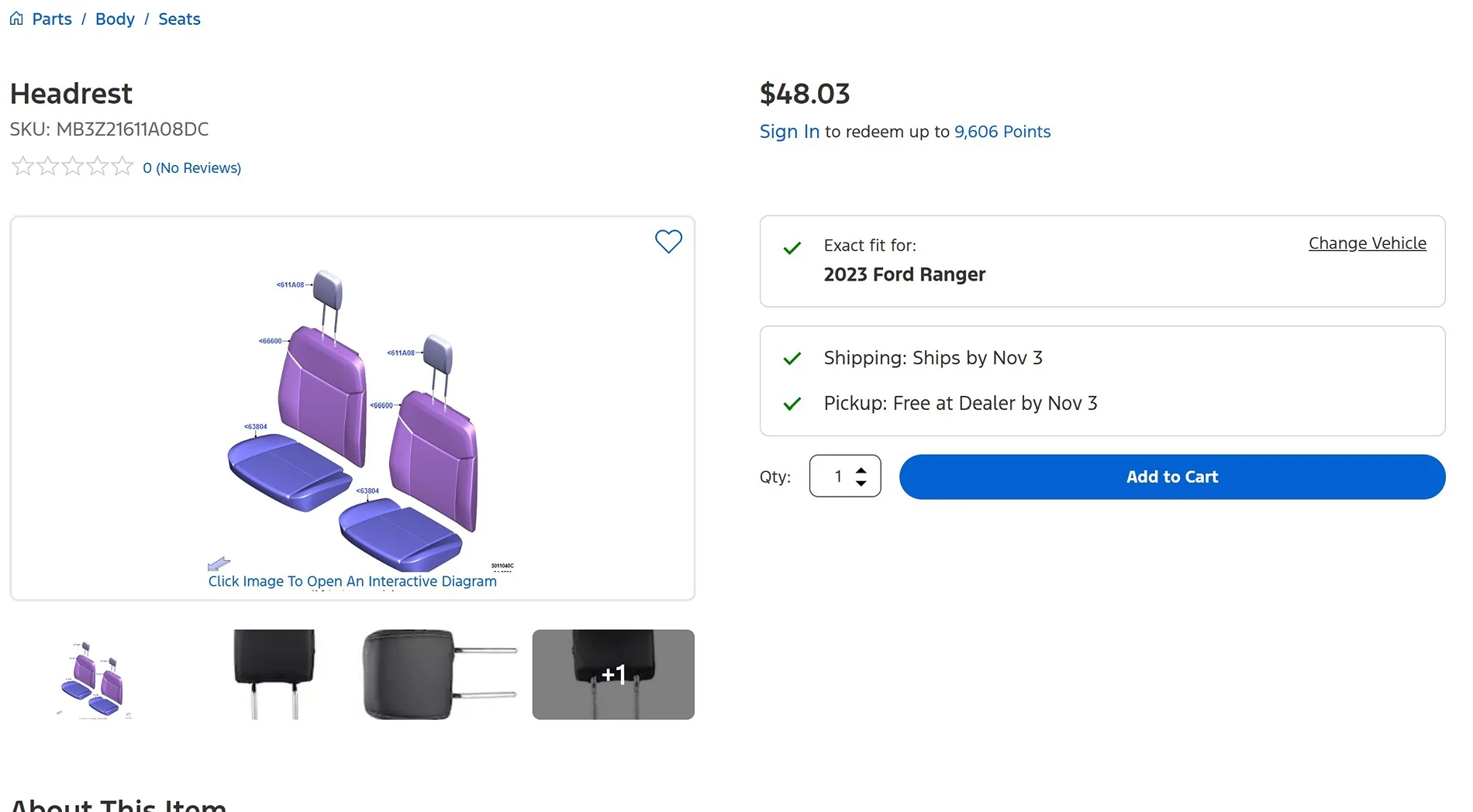

Even with the part number stated above, my dealer couldn't tell anything about the item besides that it is a headrest. Is the MB3Z21611A08DC leather or fabric? What is the color?

MB3Z21611A08DC is leather
Here are the headrest options for the 5G Rangers … all variants.

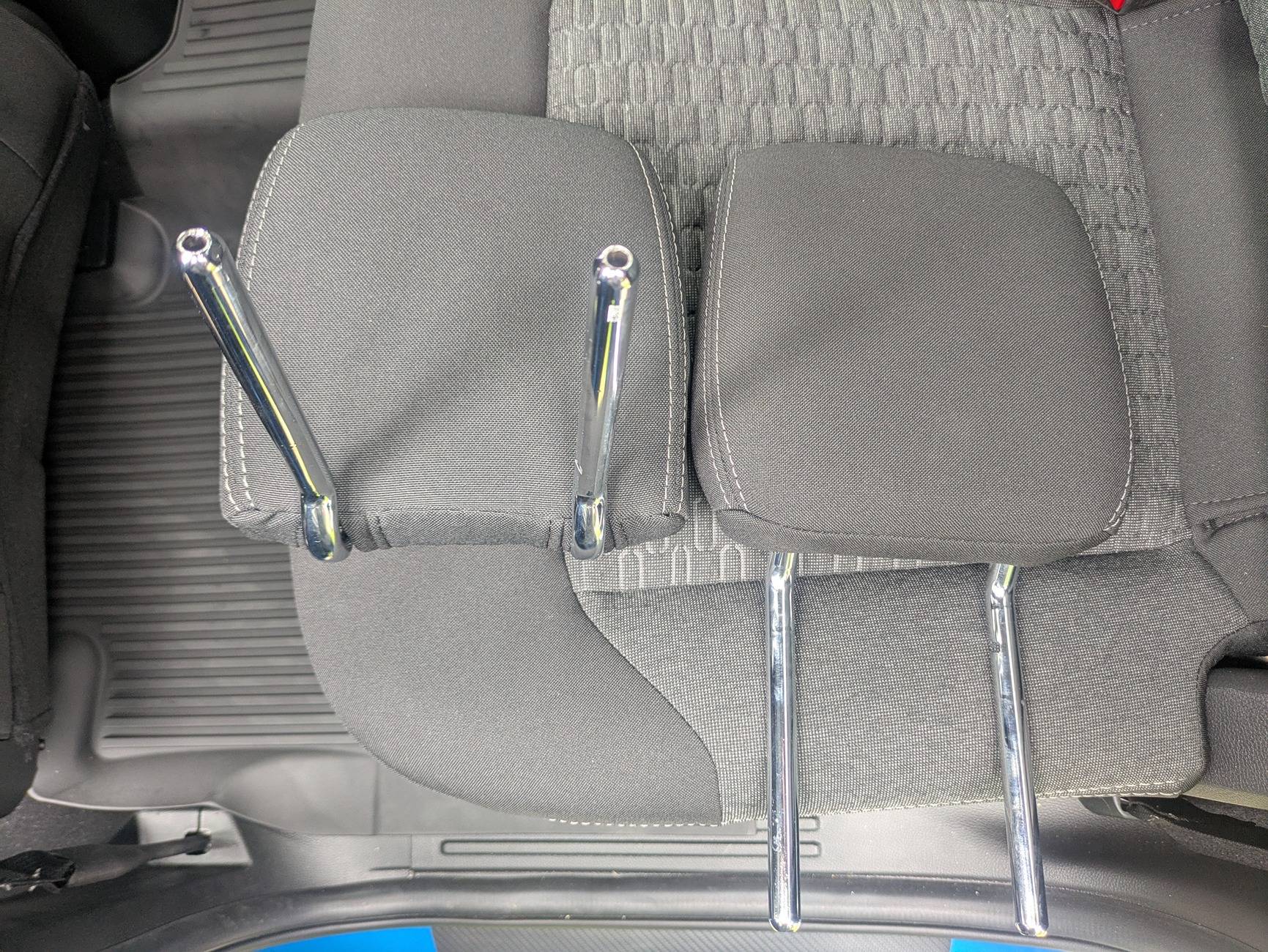

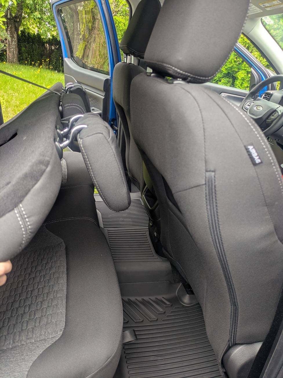

Picked up the 5G Supercab headrests today - ebony cloth matched perfectly. When folded, you'd have to be very reclined in the front to not have it clear. Stock rests (and whatever recline I'm at) were ~2.5" forward from full back that gravity would drop the seat. Folded 5Gs had another 1.5" clearance - so gain up to about 4" total if you are leaned back enough.
Fronts fully back, you can also remove the folded 5G's without having to lift the rears up at all. Only juts in a hair more than the center rest.
About $85 (CAD) landed at my local dealer for the pair.

Yes, I have installed the 5G rear leather folding headrest in my 6G Ranger.
