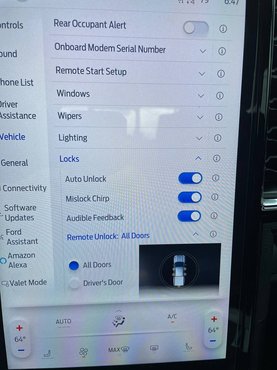

Check under Settings:Vehicle:Locks. There should be a setting in there to unlock all doors with one keypress.
Sorry but I’m away from my truck or I’d give more specific instructions.

I opt for security to just unlock drivers door. There is a setting to unlock all.
I have folding mirrors that unfold with first press with drivers door.
I wait until the mirrors unfold then push it again and the rest will unlock.

There is a setting in locks to choose between locking all doors or just the driver door. One push on my truck unlocks all doors and the tailgate.
you can also set up Siri to unlock the doors and do a host of other commands. There is a whole thread on it.
Ford Ranger Remote unlocking passenger doors IMG_6561

I set mine to all doors when I use the key fob.

Mine is set to unlock all, also
