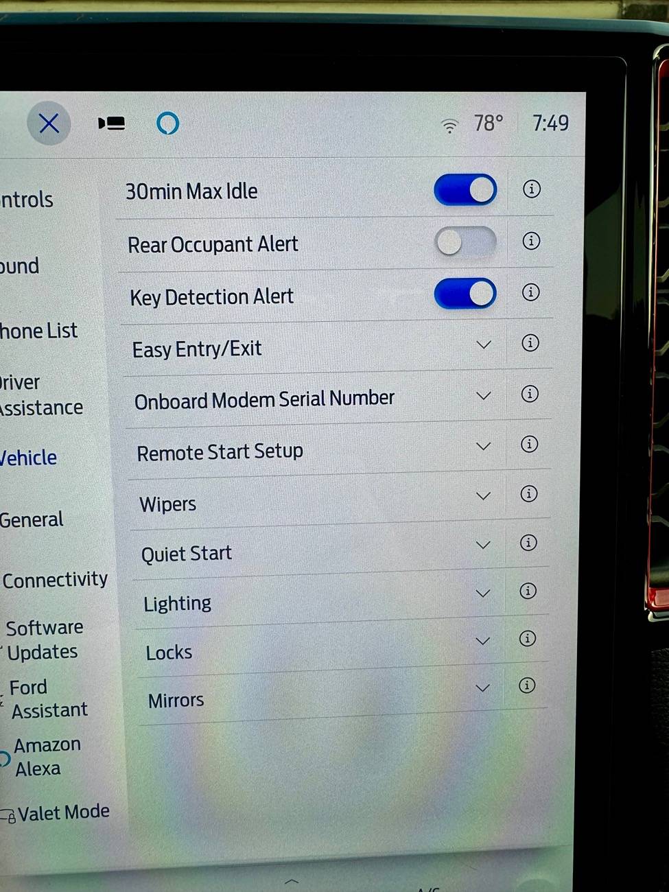

My RR built 8/24 doesn’t have this feature either. Looking at the infotainment screen, when I go to “Vehicle” there is no “Windows” soft key. I’ll take a photo tomorrow.
Mine, built in May has it.

Mine was built on 8/20/24, just for reference.

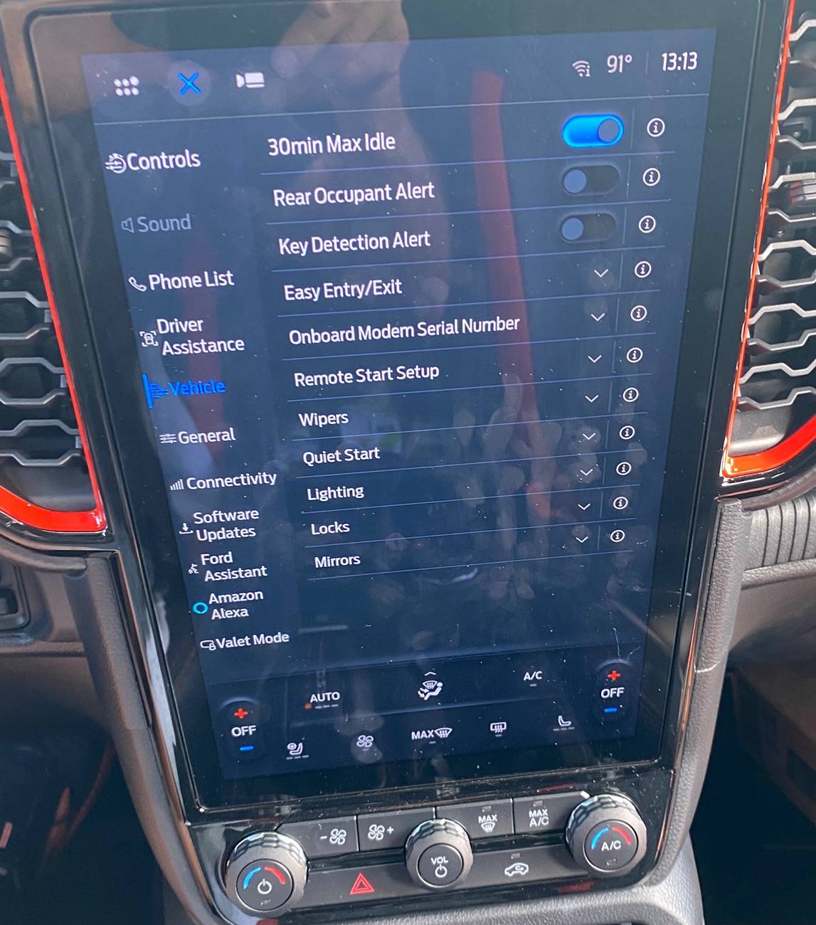

I have one, so I’ll be doing the same. Hopefully I can enable “Welcome Lighting” as well, as mine doesn’t have that soft key in “Lighting”.

So kind of weird, my RR was built 8/21 and does not have the window feature in the infotainment but but…..the loaner I just drive was a brand new 2024 Lariat with regular key and it has it, I for got to snap a photo of the infotainment screen, but there was a Windows opti9n unlike my truck
