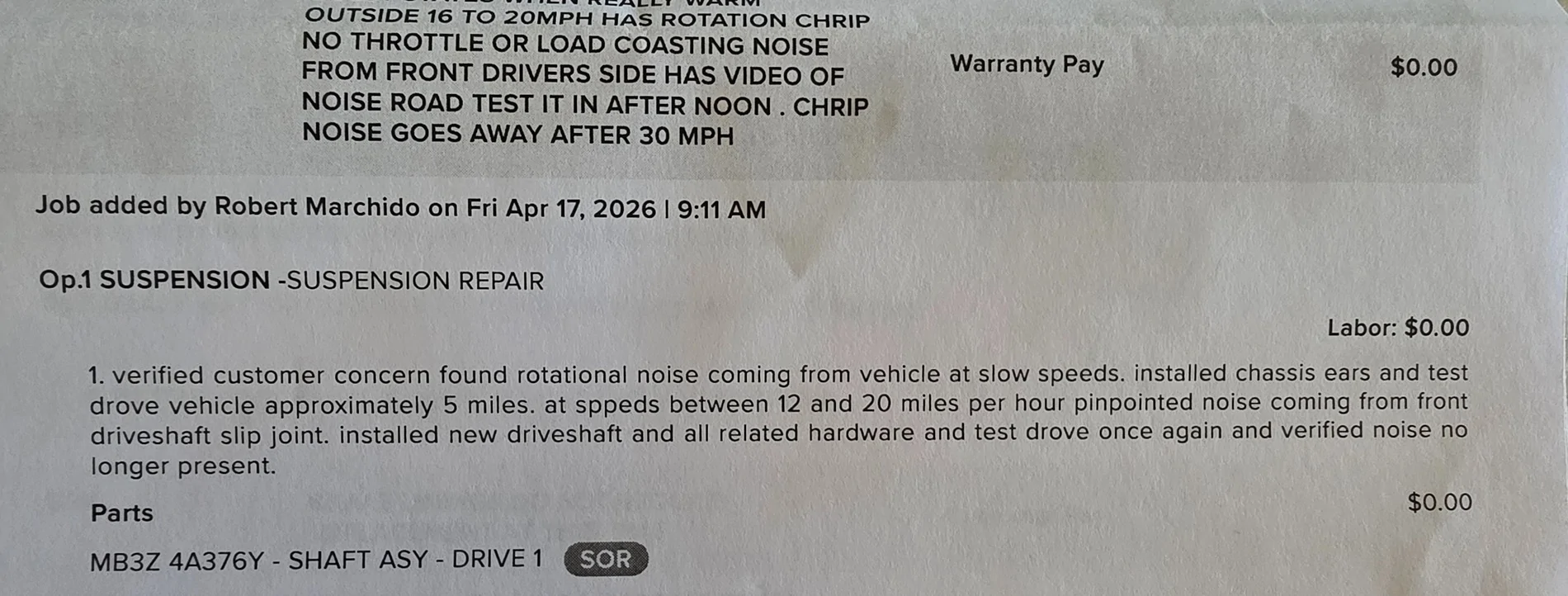

Any update on yours? Did the driveshaft solve the issue? My 24 RR has started making this chirping sound which sound identical to the videos posted on Bronco6G.
So far, its been about 800 miles sound free.
They replace the whole driveshaft for something that just needed grease? What am I missing?
They replaced the whole driveshaft assembly, it was the slip joint causing the sound.
