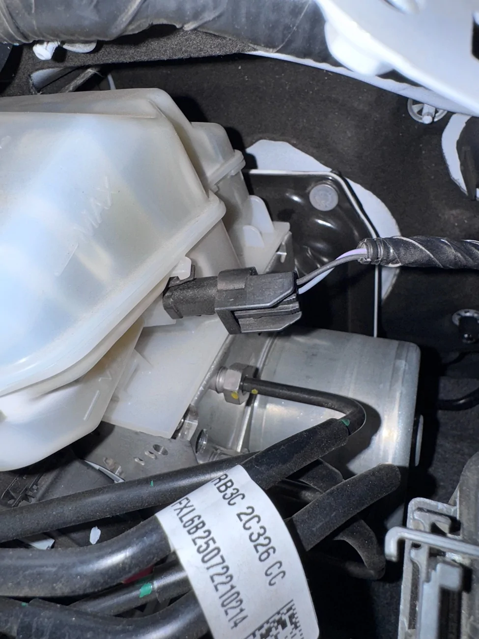

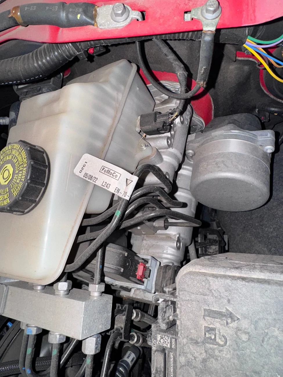

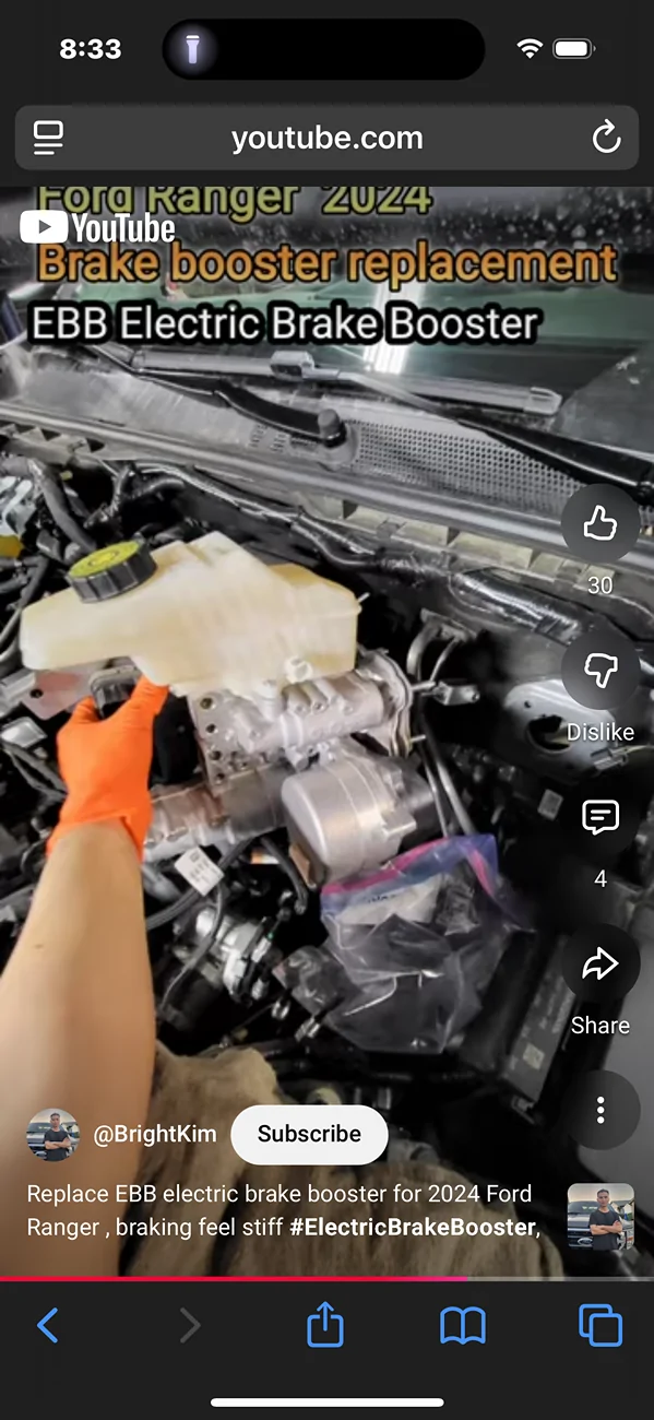

I'm determined to figure this out. I took a picture of my wife's 2022 bronco 2.7, and it has a different brake booster from what I have in my 2025 ranger, and the videos I have posted of both the expedition and bronco raptor both are 2025. I have a hunch this has to do with the newer brake booster. If anyone can comment if they have the older vs newer brake booster, it's going to strengthen our argument to ford that their update has caused an issue with the newer. I've posted the pic of the previous version (red on bronco), a video I found online of someone replacing a 2024 ranger brake booster, and my 2025 brake booster. The 2025 front part appears different than previous model boosters. The sound is coming from that black colored part on the front of the booster for me. Any suggestions or comments are welcomed.
