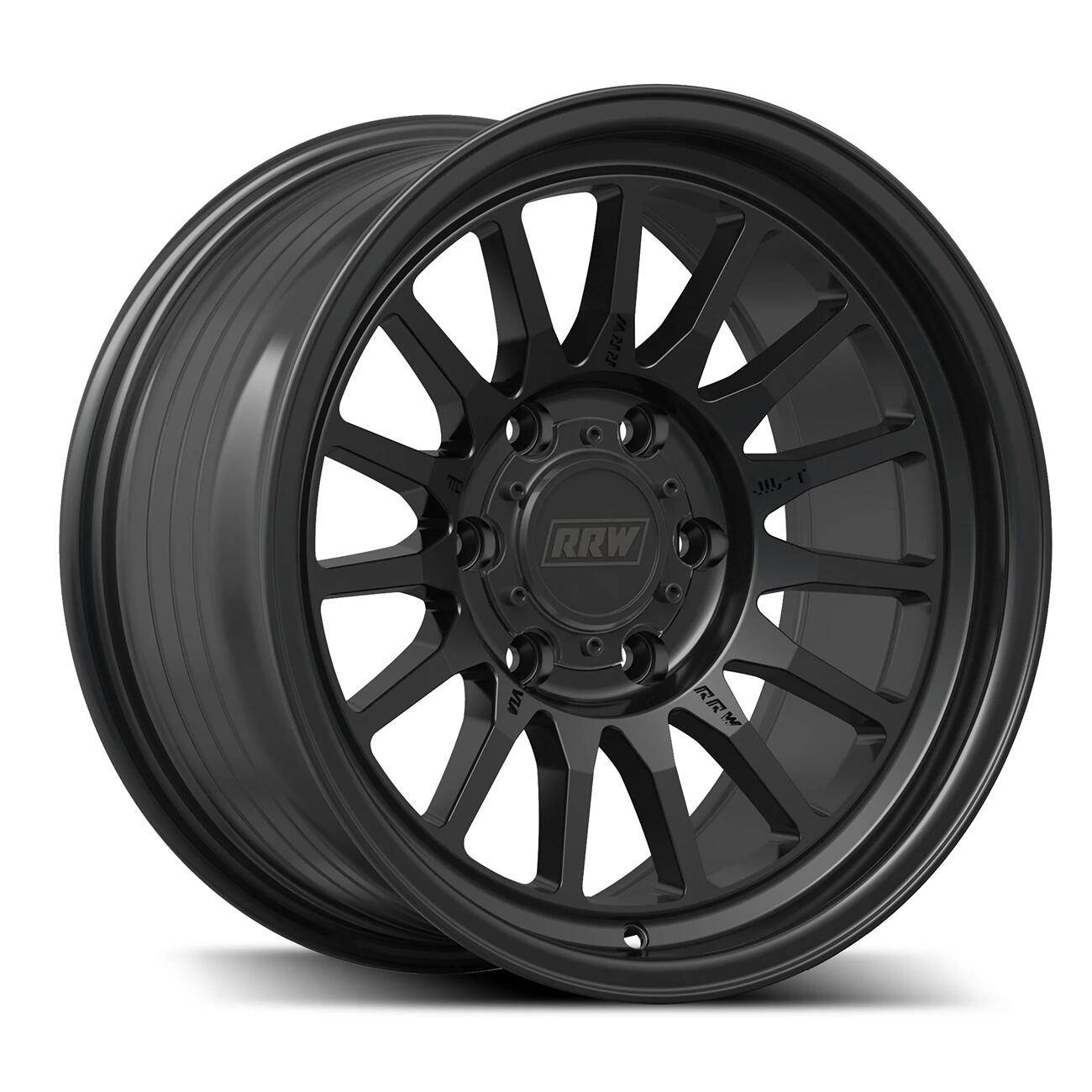

I'm looking at these wheels, nice and clean and huge weight savings at 21.8lbs.
https://www.relationsracewheels.com...rder-rr7-s-flow-form-17x8-5-wheel-matte-black
It states its 95.1mm and hub-centric for the Ranger, however the Ranger runs at 93.1mm?
Specifications
Bolt Pattern: 6x5.5 / 6x139.7
Center Bore: 95.1mm (hub-centric for 4G Tacoma, 3G Tundra, Ranger, Bronco, GX550, Landcruiser 250)
Weight: ~21.8lbs !!!
Load Rating: 2500 lbs
Backspacing: 5.73"
Compatible with TPMS and Extended Thread (ET) Lugs

I'm not running those wheels but the same specs from RRW and the hub bore works fine, it's only a couple MM

Well yeah, if it's bigger of course it will "fit" technically but it is not hub-centric. And it's not big enough to use an adaptor hub-centric centering ring. So it's technically lug-centric. But correct me if I'm wrong because I really like these wheels and want to justify being able to get these. But I'm leaning towards RTR since they are true hub-centric and engineered for Bronco/Ranger with a 93.1mm bore.

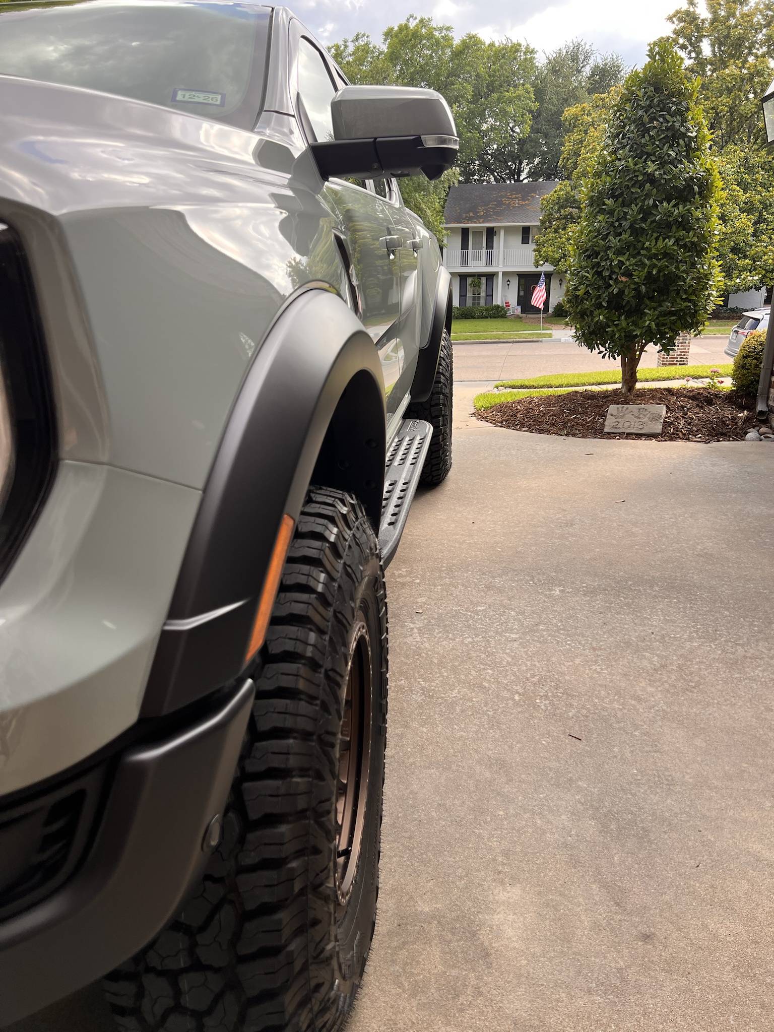

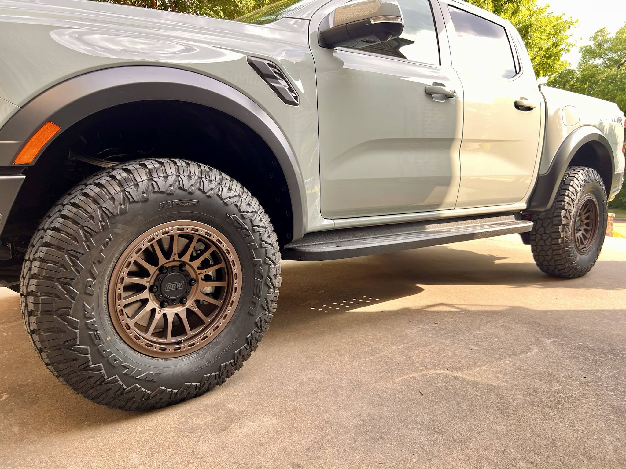

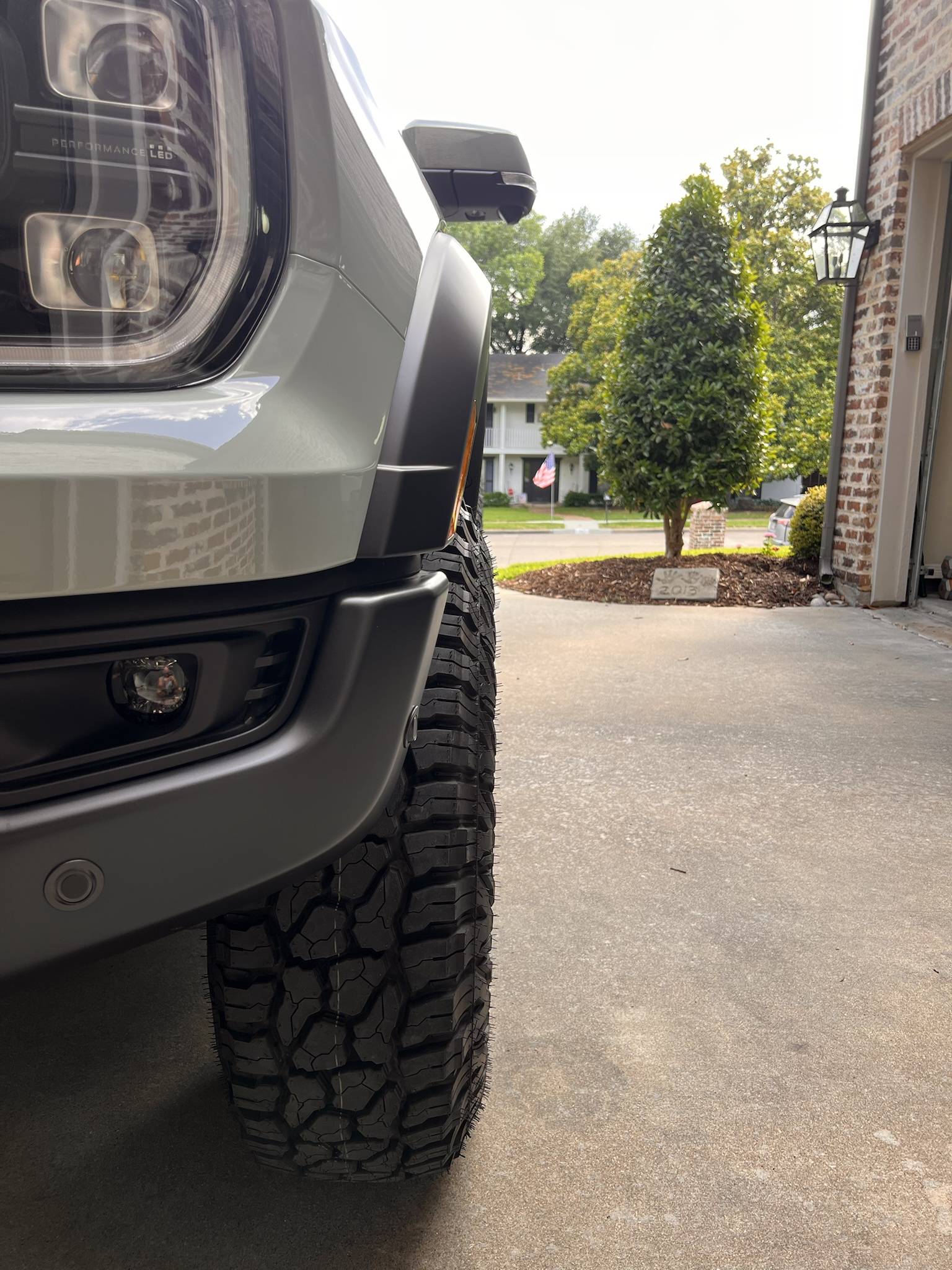

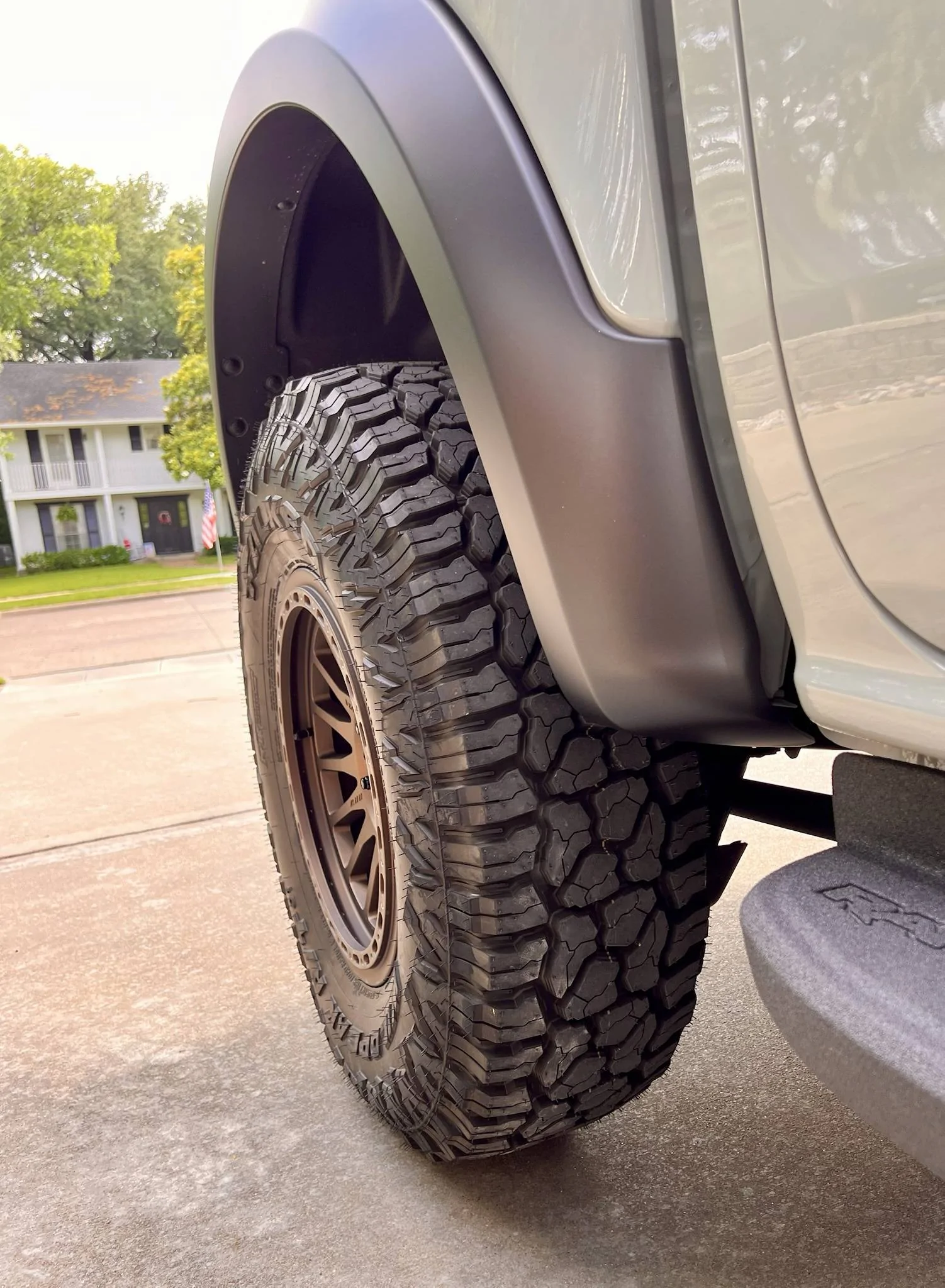

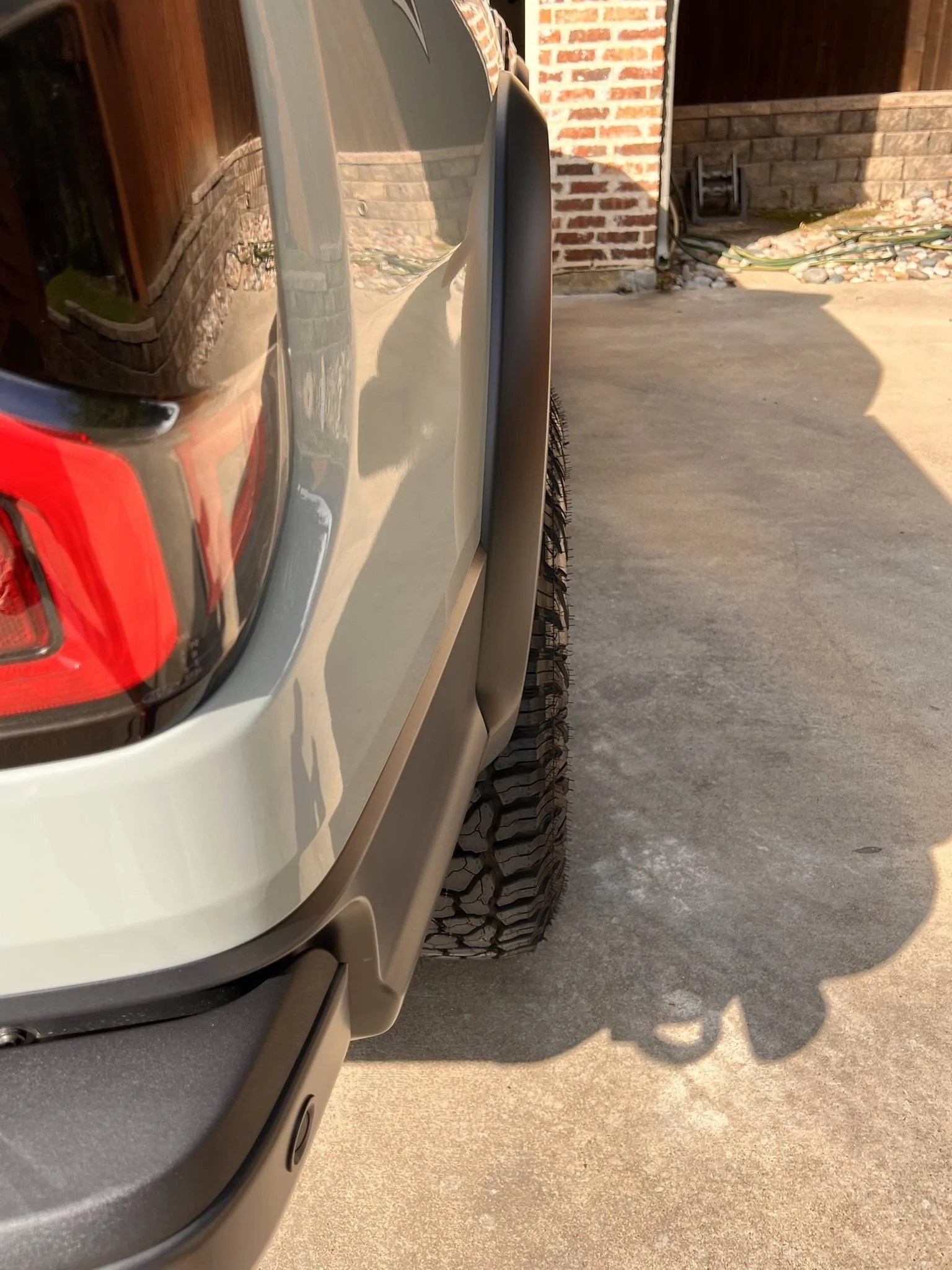

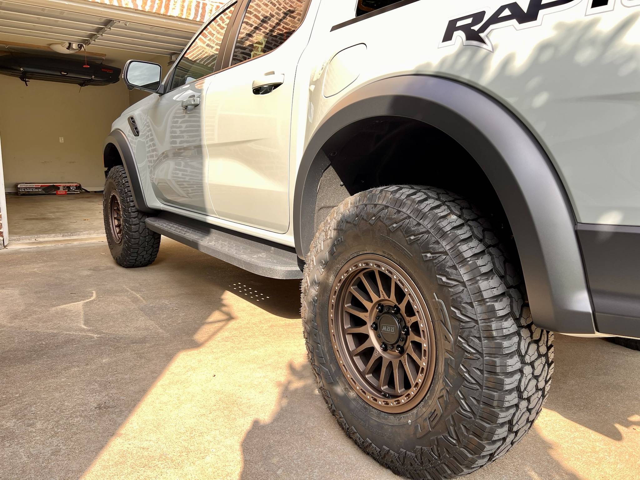

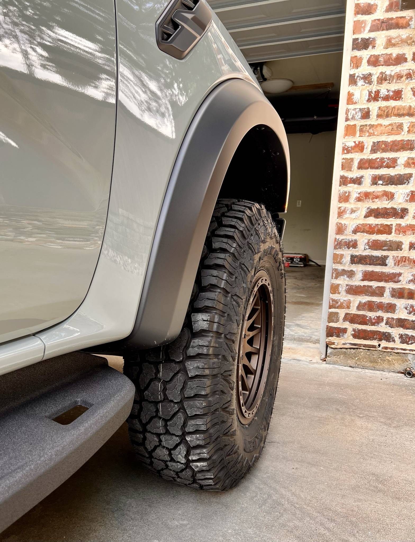

I have RRW wheels with +25 offset on Falken Wildpeak RT01 35x11.50R17. Here are a few pics:

Thanks for the photos. They look great. They don't poke out too much, just right. I love the wheels. I have the Shelter Green and think they'll look great on it. Thanks again
