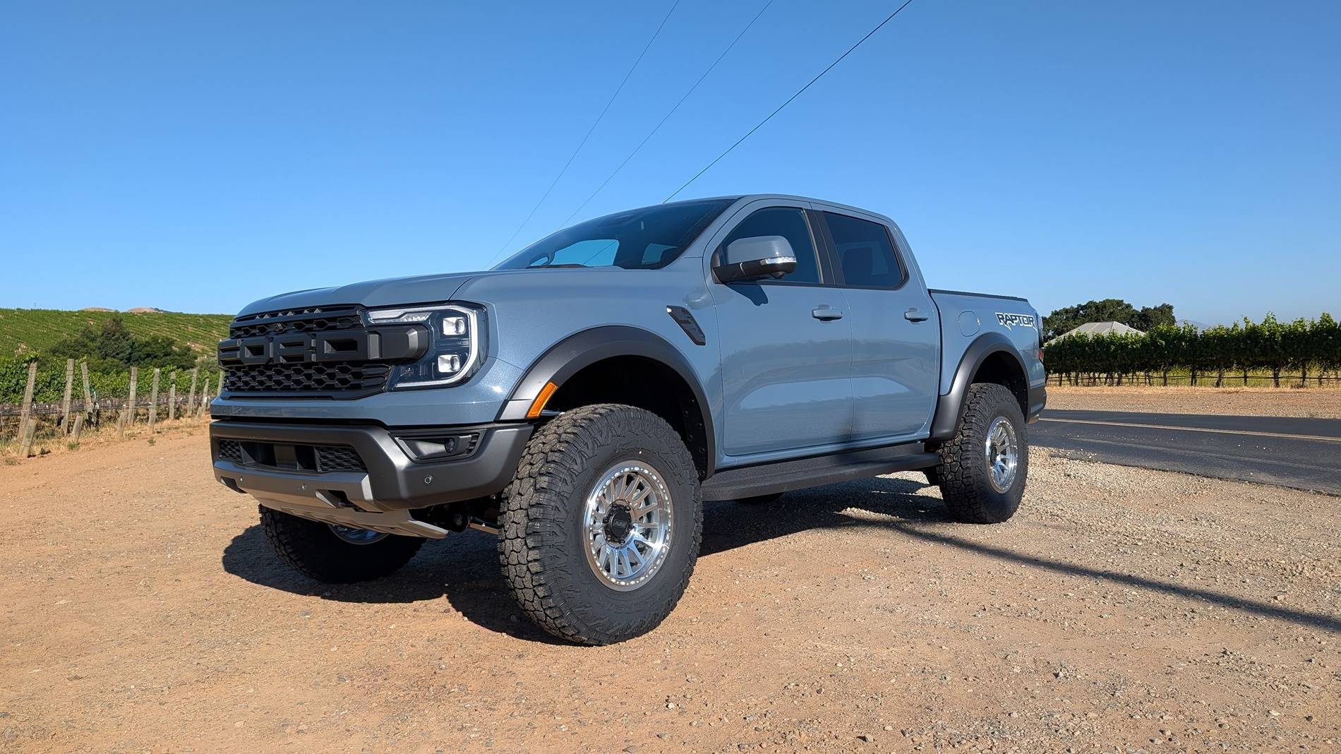

Here you go...
Wheels: RRW RR7-H, +25mm, 17x8.5, Machined Finish with V2 Black Rings (on backorder)
Tires: Falken Wildpeak R/T01, 35x11.5x17, Load Range C
Lift: Hyperco Coils, 2.25" Front, 1" Rear (3/4" or rake)
Tire and wheel combo weighs .04 pound more than stock. :sunglasses: I do not notice any loss in power. Truck still gets up and goes just like before.
Alignment specs are dead on. No need for aftermarket UCA's. Used Forscan to reset the ride height sensors and program the 35" tire size.
Rides much firmer, but hoping the springs settle and the Live Valve learns. I need to play with tire pressure a little too, which will help the firmness.

They look great. I'm waiting for mine, probably another month.

Thank you. Once I get the black rings I think it will again change the look of the truck.
I didn't get the rings. Mine are bronze so I'll see what they look like first

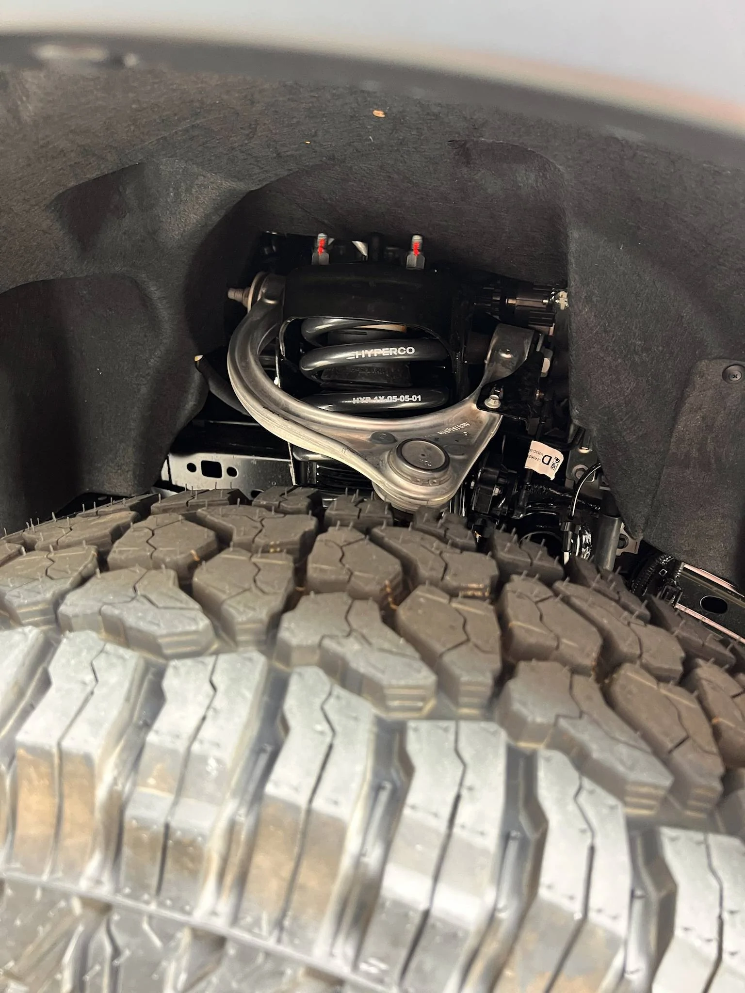

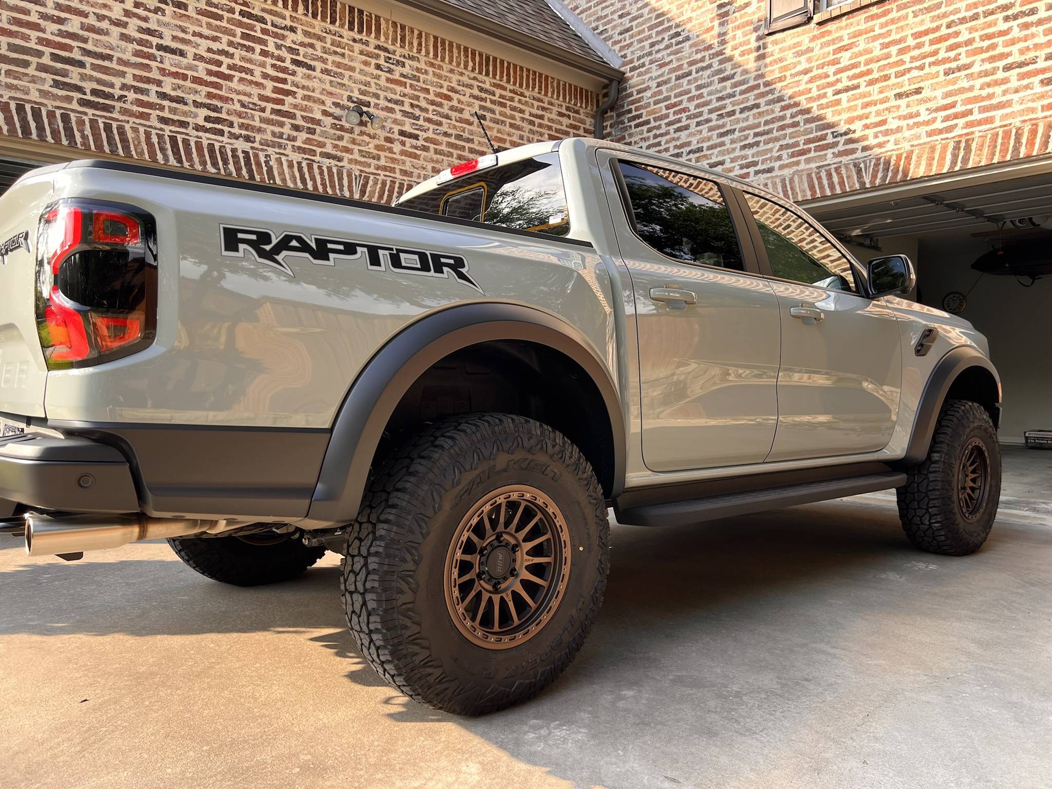

Looks great! You and I have literally the exact same setup except for color. Same wheels (mine are bronze), same springs, same exact tires in the same size.
You have good taste sir. ?
I saw your thread after I ordered everything. Just supported melting the credit card. ??
