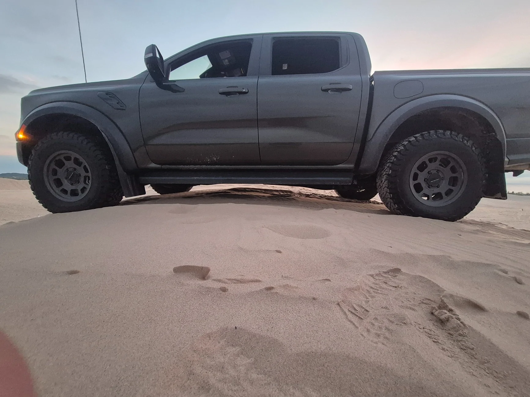

I ran down to 12 psi in the sand dunes just a few weeks ago, pro cal tuned and used all 455 HP regularly! I even slipped a rear tire on the wheel just a bit (had to get re-balanced) due the low air pressure and tons of full throttle pulls on the drag strip (may run 15 psi next time), but it never lost air and I never de-beaded.

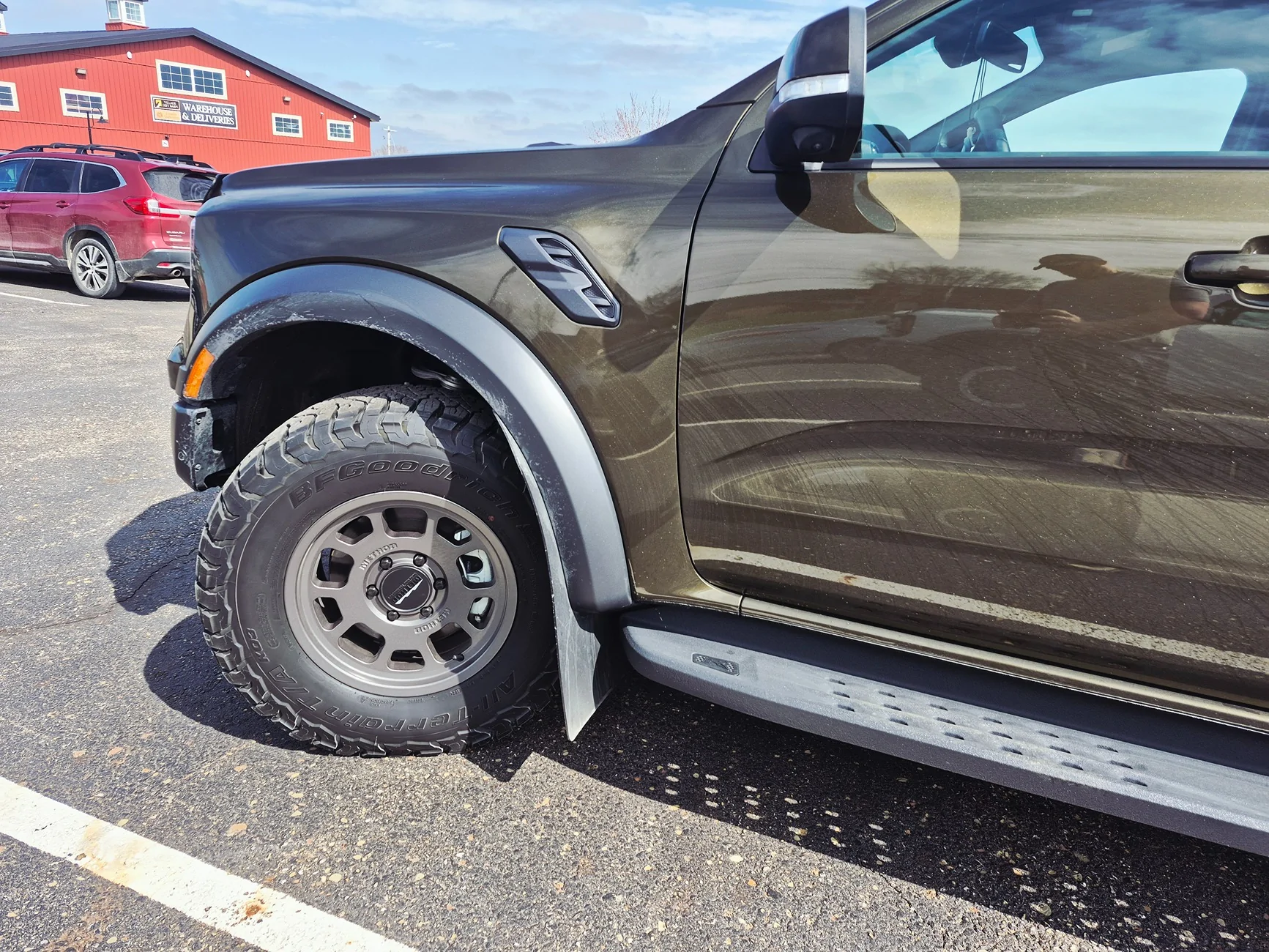

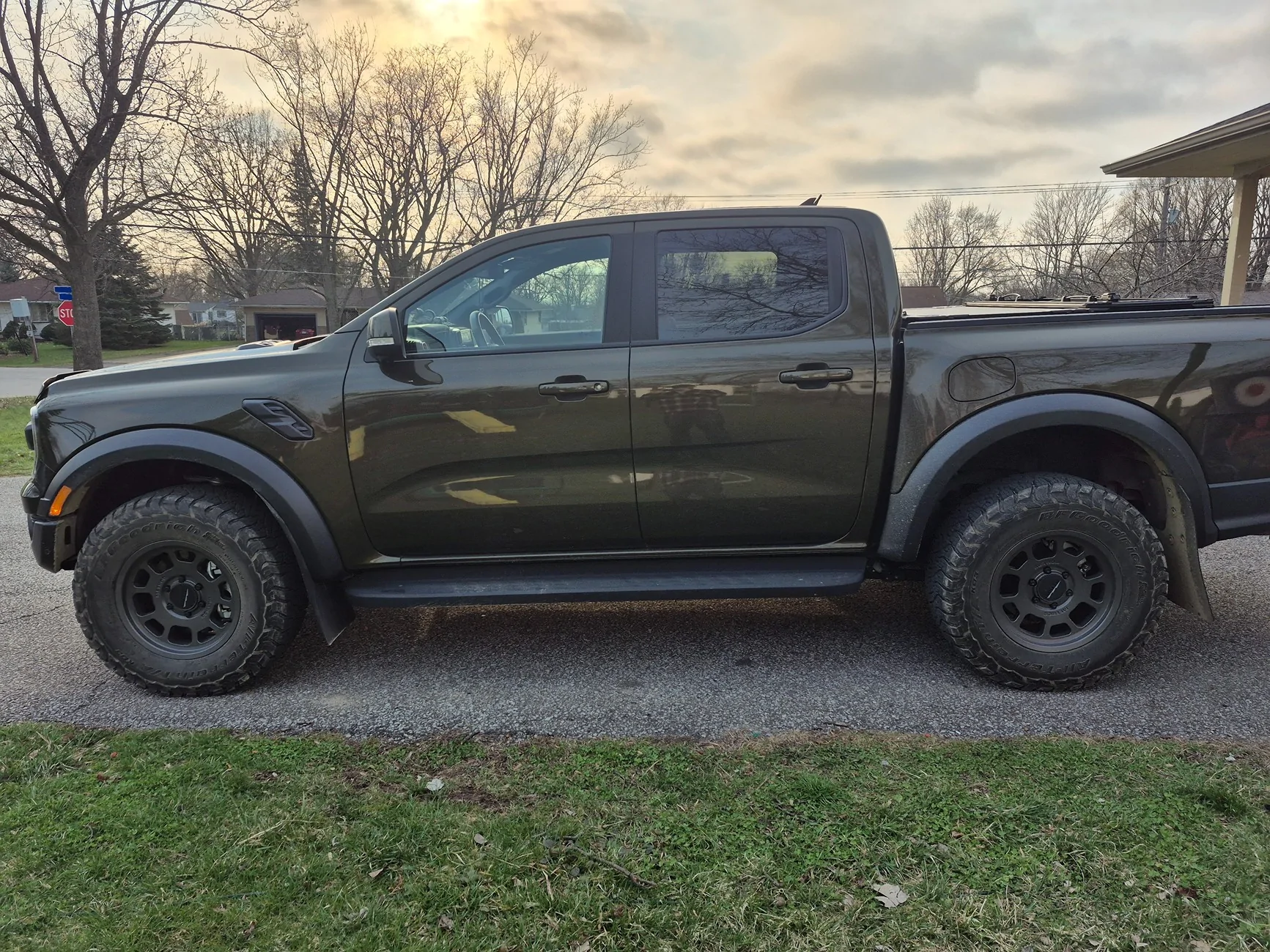

I do think the RTR's look better in some ways, but the Method's, while simple in design, are very easy to clean off, and tend to not hold as much dirt as some of the more complex spoke designs and a very well built for abuse. They are performance wheels first with meaty spokes and rim lips, plus you get the large inner safety hump and bead grip ridges that hold the tire bead at low pressures far better than the RTR will.

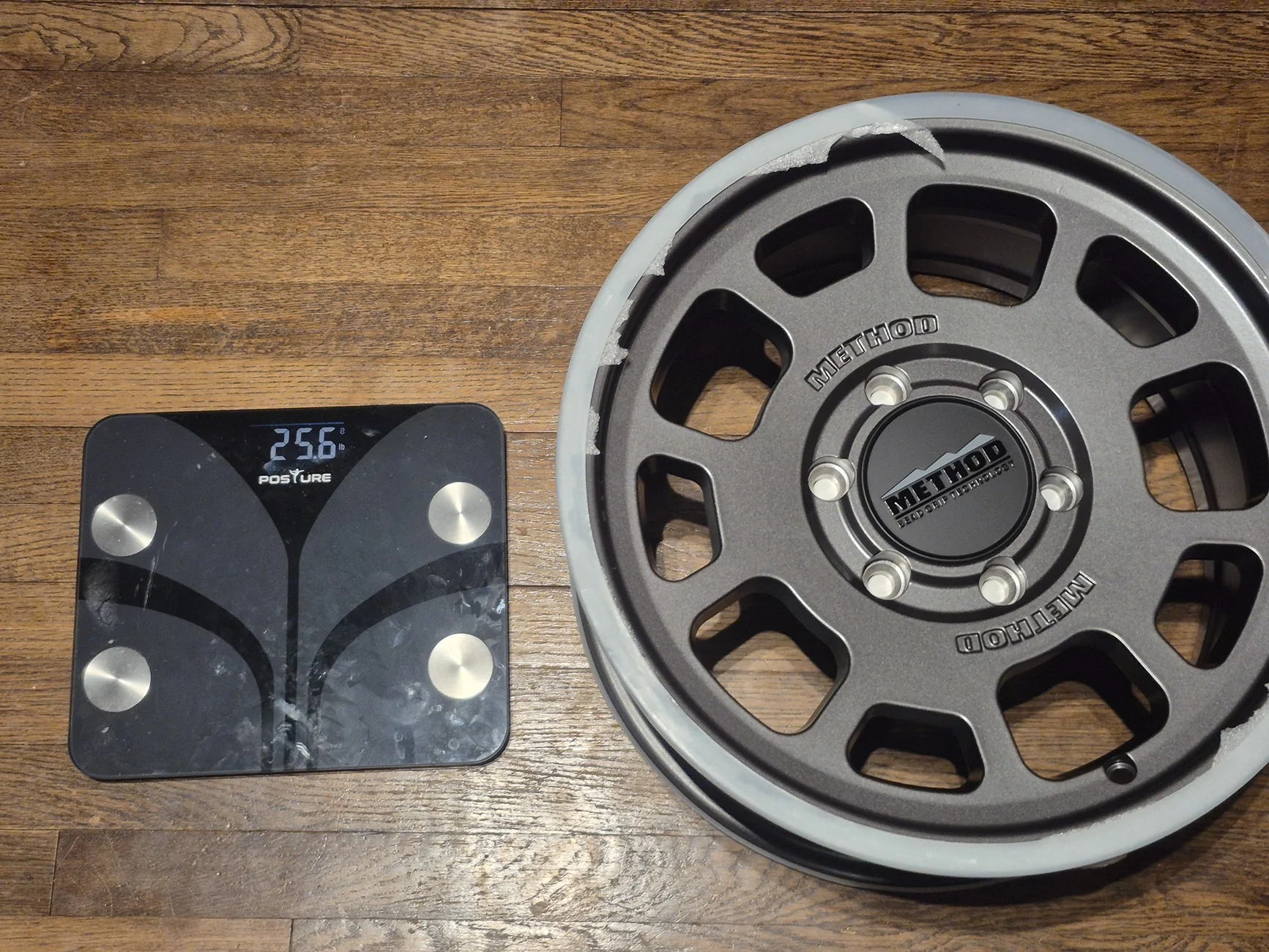

The 705's are pretty lightweight, 25.2lbs per wheel, the 703's are more popular and still reasonable weight at 28 lbs per wheel. Here's my take, when going with lightweight wheels, in off-roading you do NOT want to sacrifice strength for a few lbs.
Your not going to notice the difference between 23 to 25 or 28 lb wheels. Sure, you can tell between a 36 lb OE bead-lock that is like a boat anchor, but if you had started with factory alloys at 28~29lbs, it's less dramatic.
The RR race truck runs MR207 Forged wheels that are 30lbs a wheel, about the same weight as OE alloys and due to class rules, that truck cannot run a tune, it's on factory cal at 405 hp. That's the compromise, not ultra lightweight like a car wheel for smooth track, but not a boat anchor either.
The 705's give you a really good balance of weight vs strength, it's the same alloy and size / off-set as the 703, just slightly different spoke design and only two-color options (matt black and titanium).

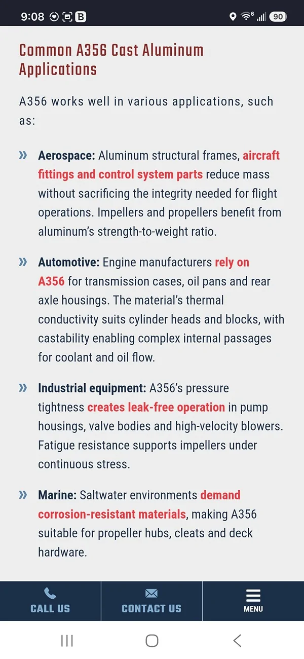

Method is focused on offroad use, be it tucks, SUVs and S x S. Most of their wheels are solid castings made with the high strength aluminum alloy A356 with heat treatment + artificial aging for optamizing strength that is what is commonly known as T6 treatment of alloys.
For reference A356 is a structural alloy used in Aerospace and Automotive for engine block and transmission casings and rear axle housings. Its a very strong alloy. Method also has their MR207 Forged series for race applications with even greater strength.

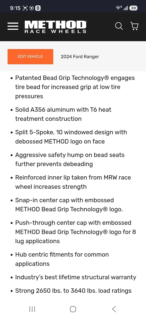

BTW here's some general info on Methods site:
Ford Ranger RTR Evo6 Off Road Durability? 1000023484
At the very least, they are very rugged and durable wheels that I think are better suited to offroad use than RTR.
