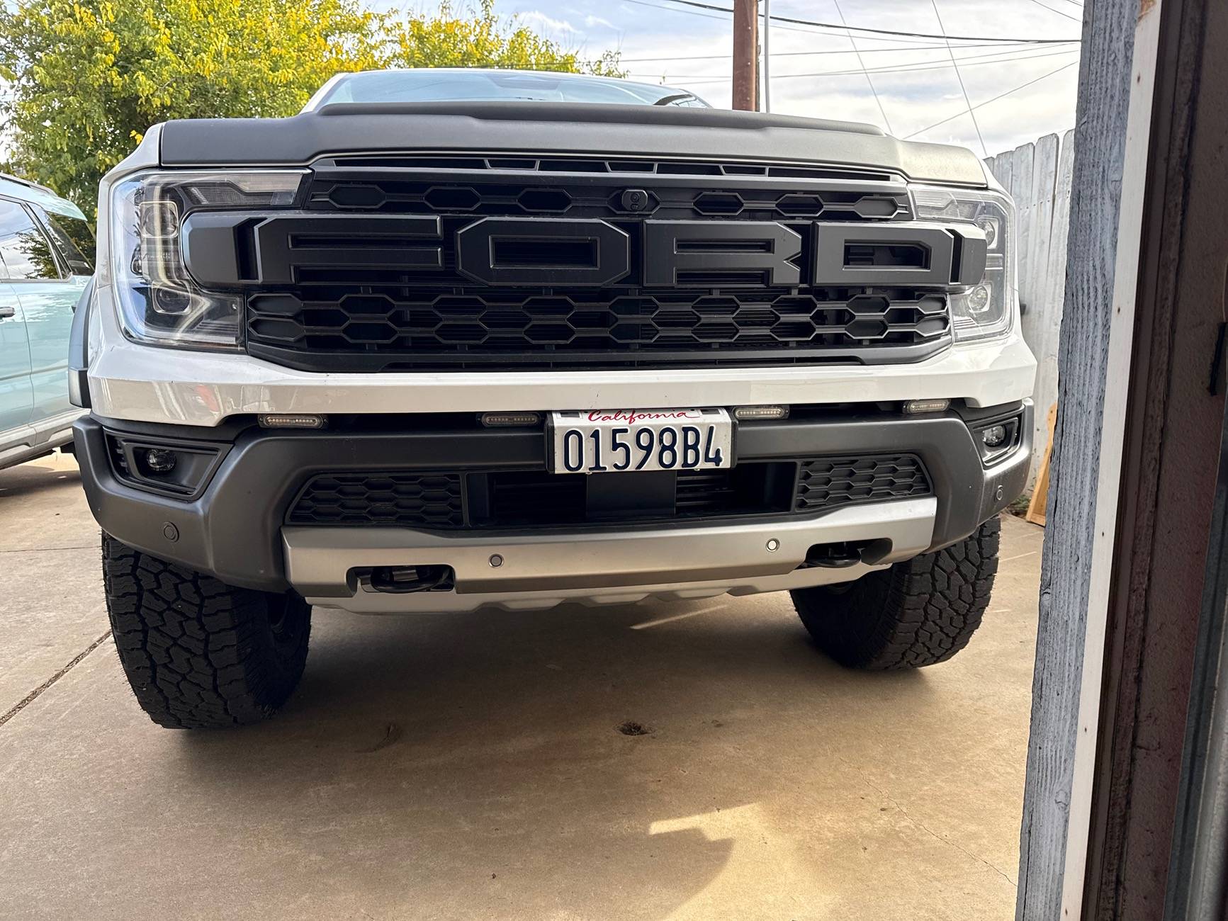

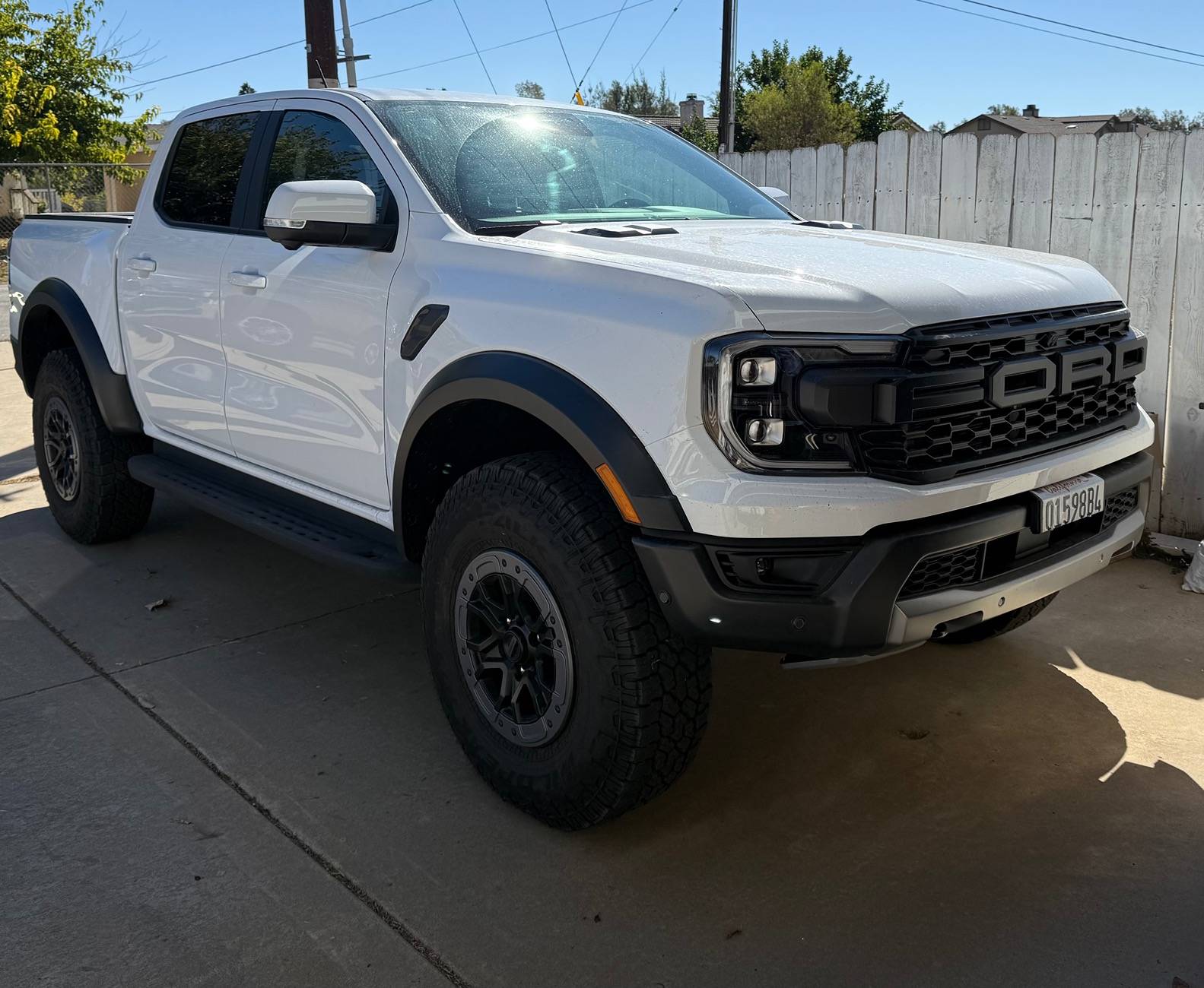

good to know PTYSean as I’ve been seeing aftermarket intercoolers and thinking about if it’s worth it, or just the performance Ford tune and keep the rest stock. BTW I like the rails and rack set up Arsenall11, thought about roof rack but also the rails allow cross bars only when you need them and minimal weight/drag when you don’t need anything. Side note , this is off topic, your front pic reminded me that I didn’t like the front license plate mount so here’s what I did.
Ford Ranger Stock Bumper Winch Plate IMG_2819
Ford Ranger Stock Bumper Winch Plate IMG_2798

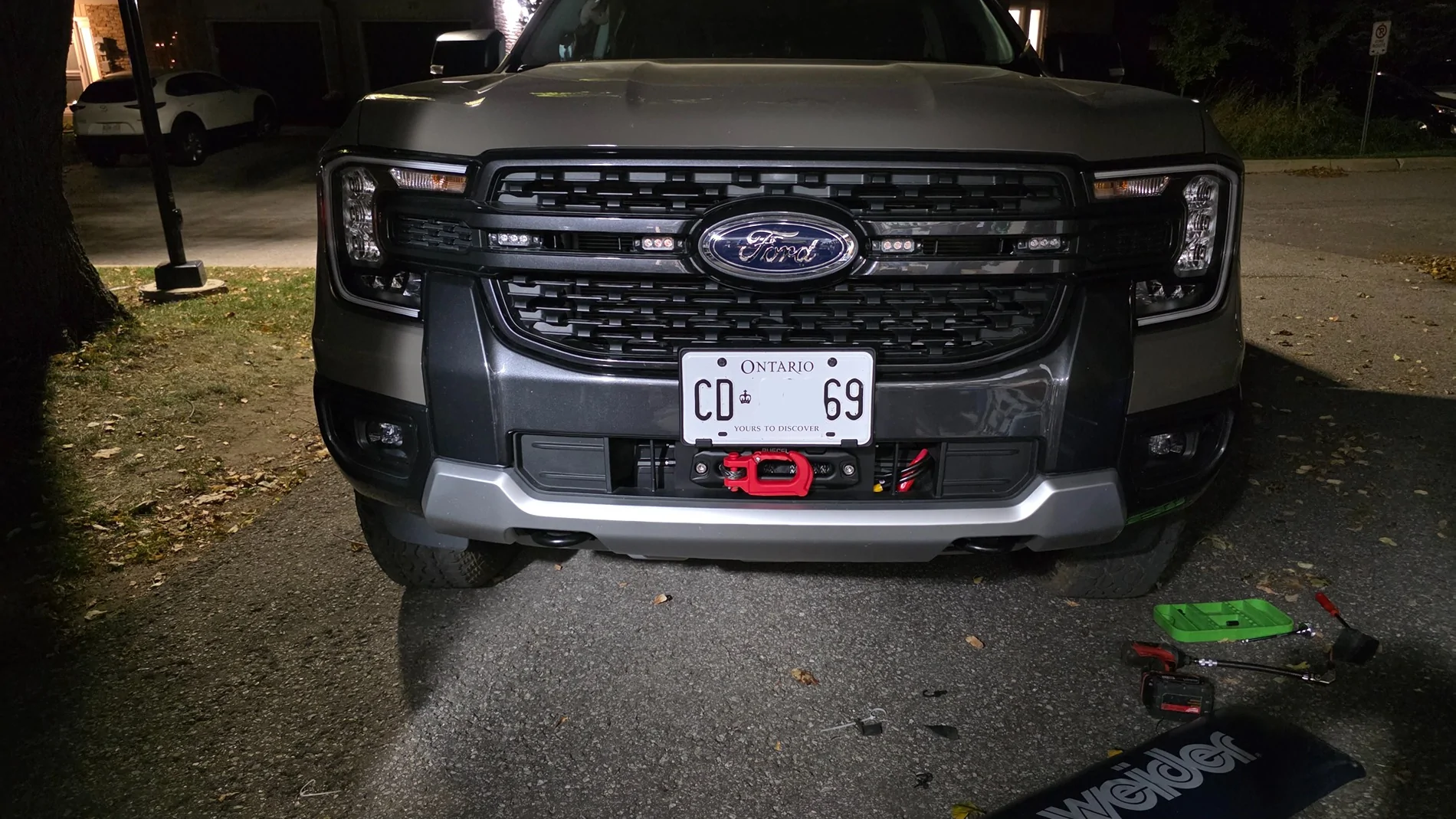

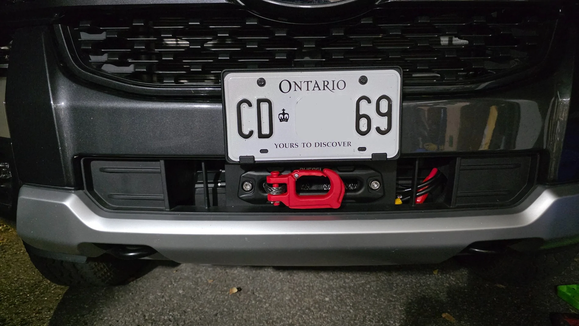

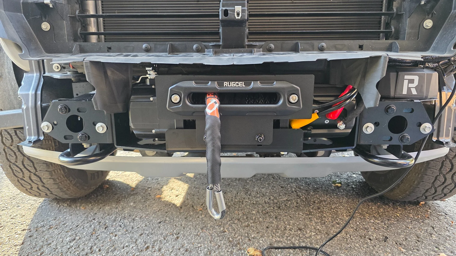

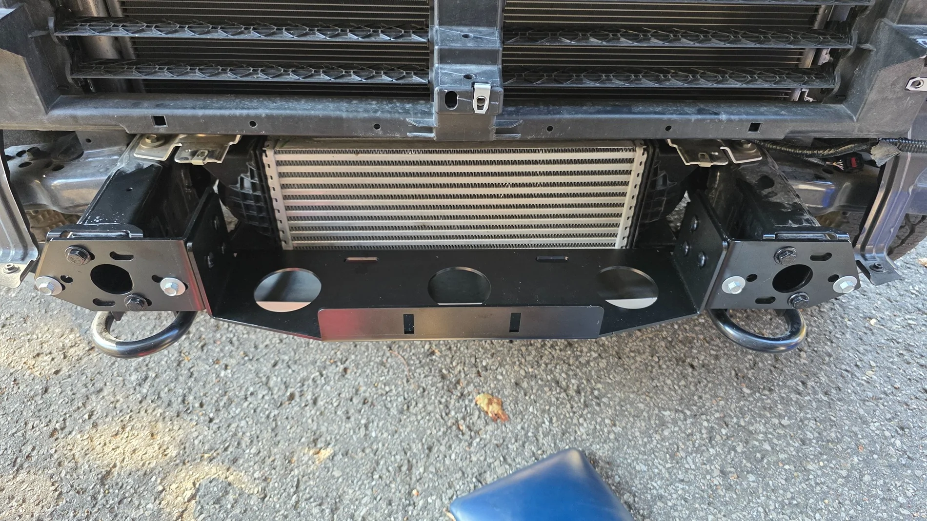

Installed hidden winch on 2025 XLT FX4 2.7L, the winch plate was from ebay, but not the links in this tread, plate came from cali, didnt have to cut the bumper, but had to remove the active grille shutters
Thanks for posting these pictures--especially of the plate without the bumper.
Aren't you restricting air flow to the intercooler though?
