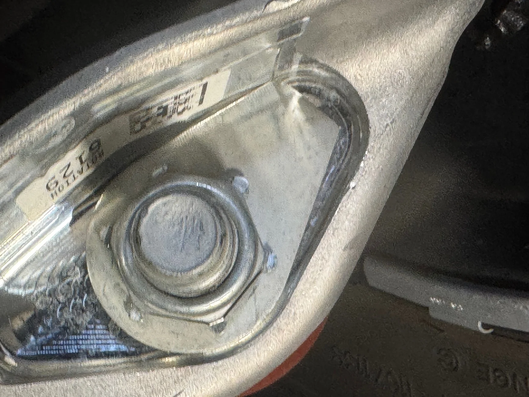

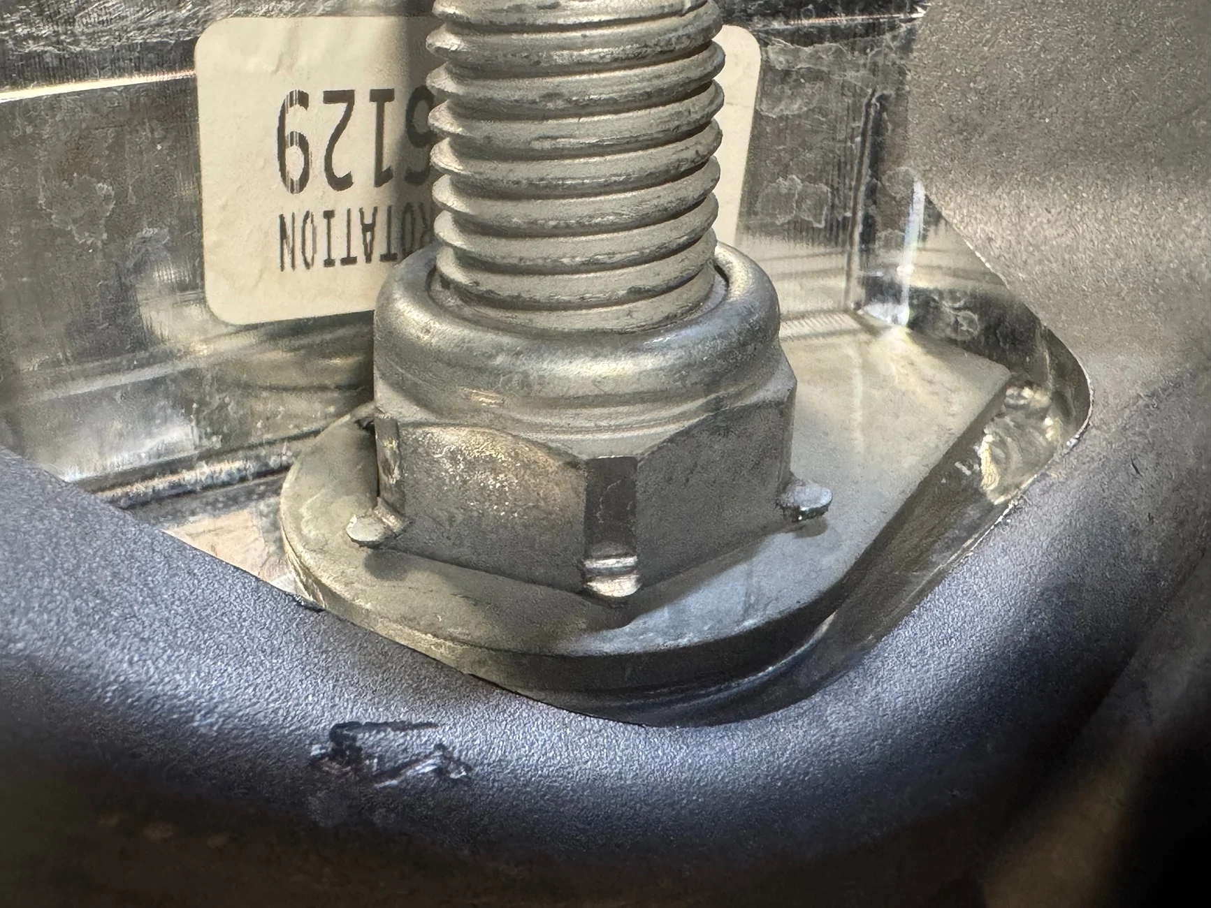

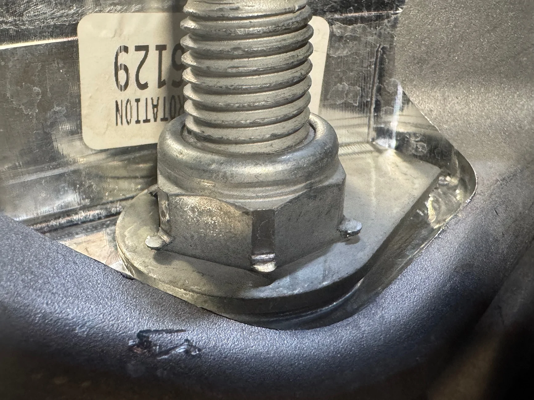

Hey I had a lift installed and noticed the front shock nuts are both installed like this. the wing is supposed to be in the machined surface right??
does anyone have pictures of there's factory, eyes on it or service manual so show it correctly?

I wonder how they tighten those down. I dont think there is enough nut to grip with the tab welded to it. That does look odd.

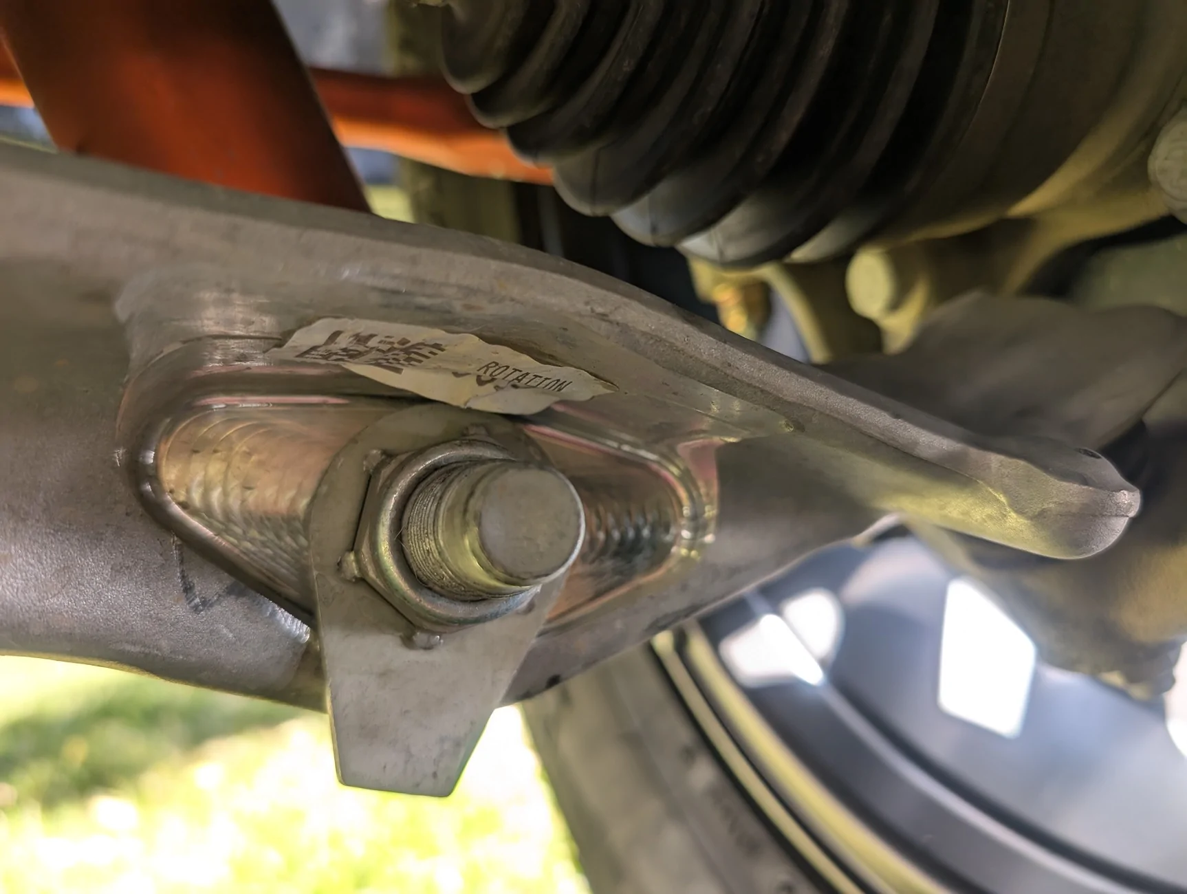

its crooked how it is now and there is marks on arm where it looks like the tab was hitting before this work

NP. Your welcome. But if they tweaked those tabs and now they don’t fit flush with the machined surface you might have a hard time keeping them torqued. Thats not even knowing if their purpose is to spread the load so the aluminum brackets won’t break. There’s a reason it’s not just a flat washer. I would not put them back on my truck.

The tab is only there to keep the nut from spinning during install, it doesn't secure anything.
It's just over 8 bucks for 4 new ones via my local dealer, and considering the tourqe they are supposed to be at, 550nm on front and 475nm rear, I'll just get new ones. probably do bolts aswell, only 65 for 4 of them.
