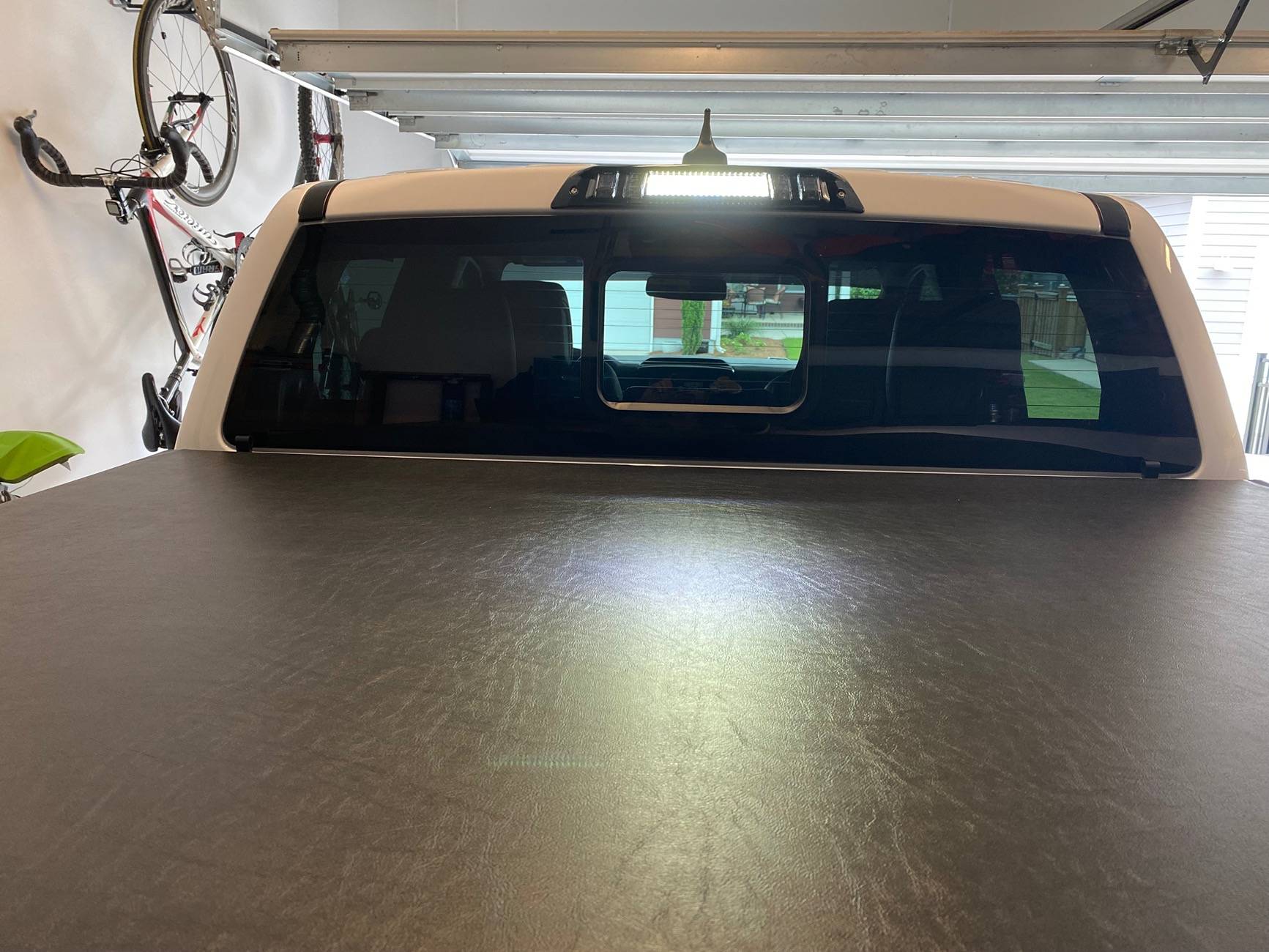

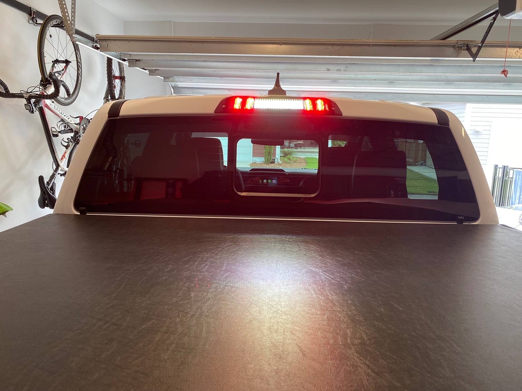

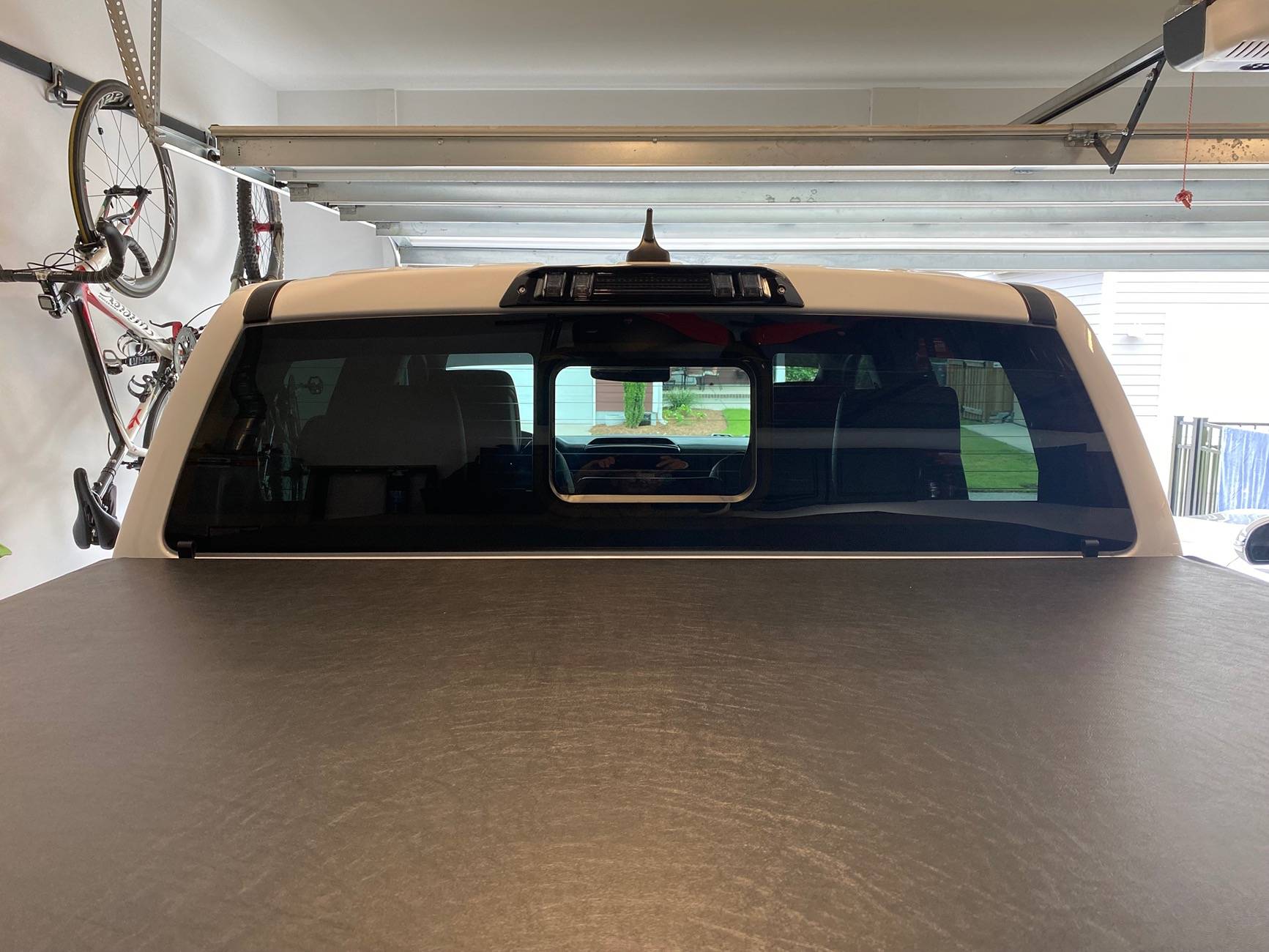

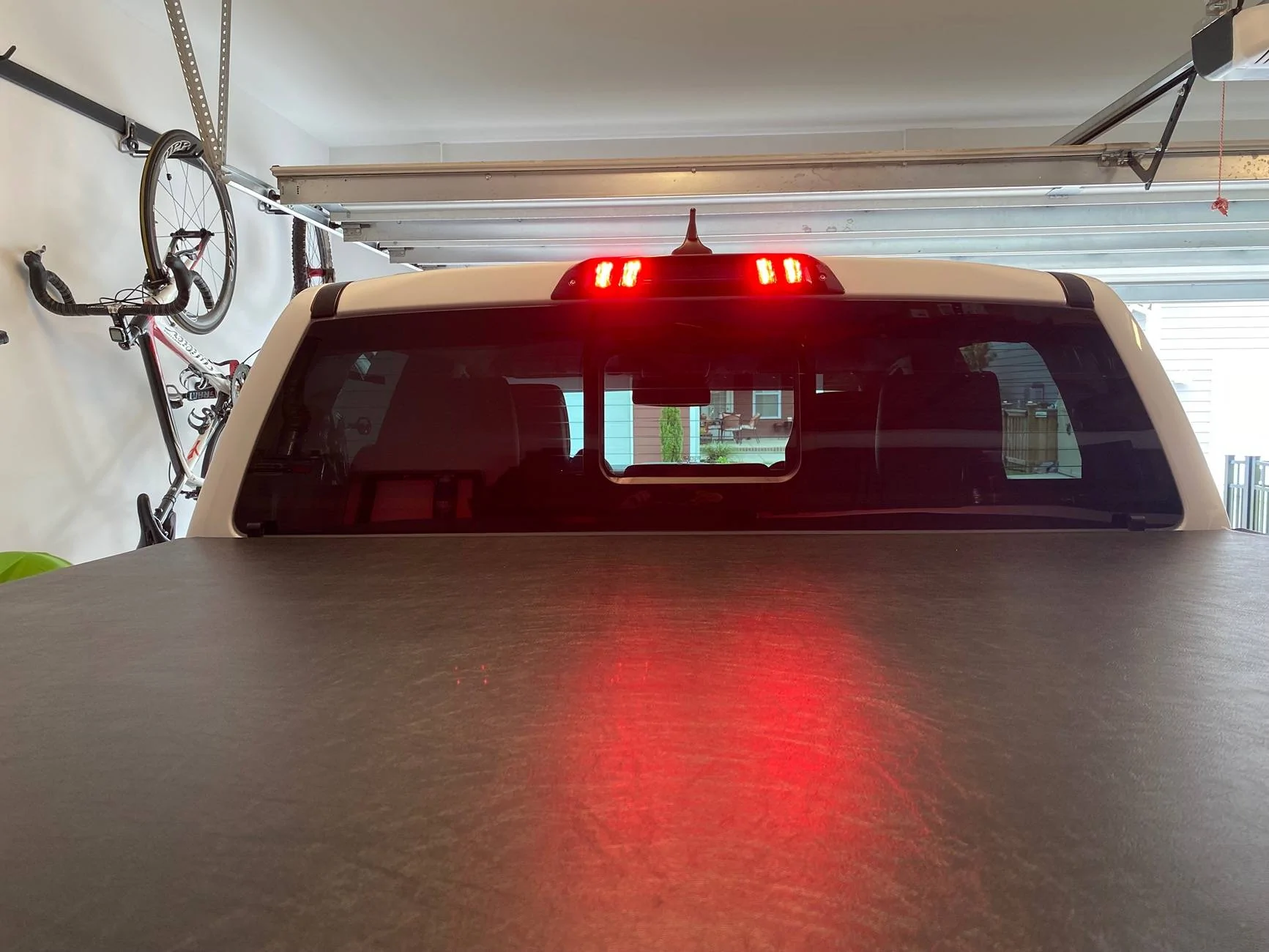

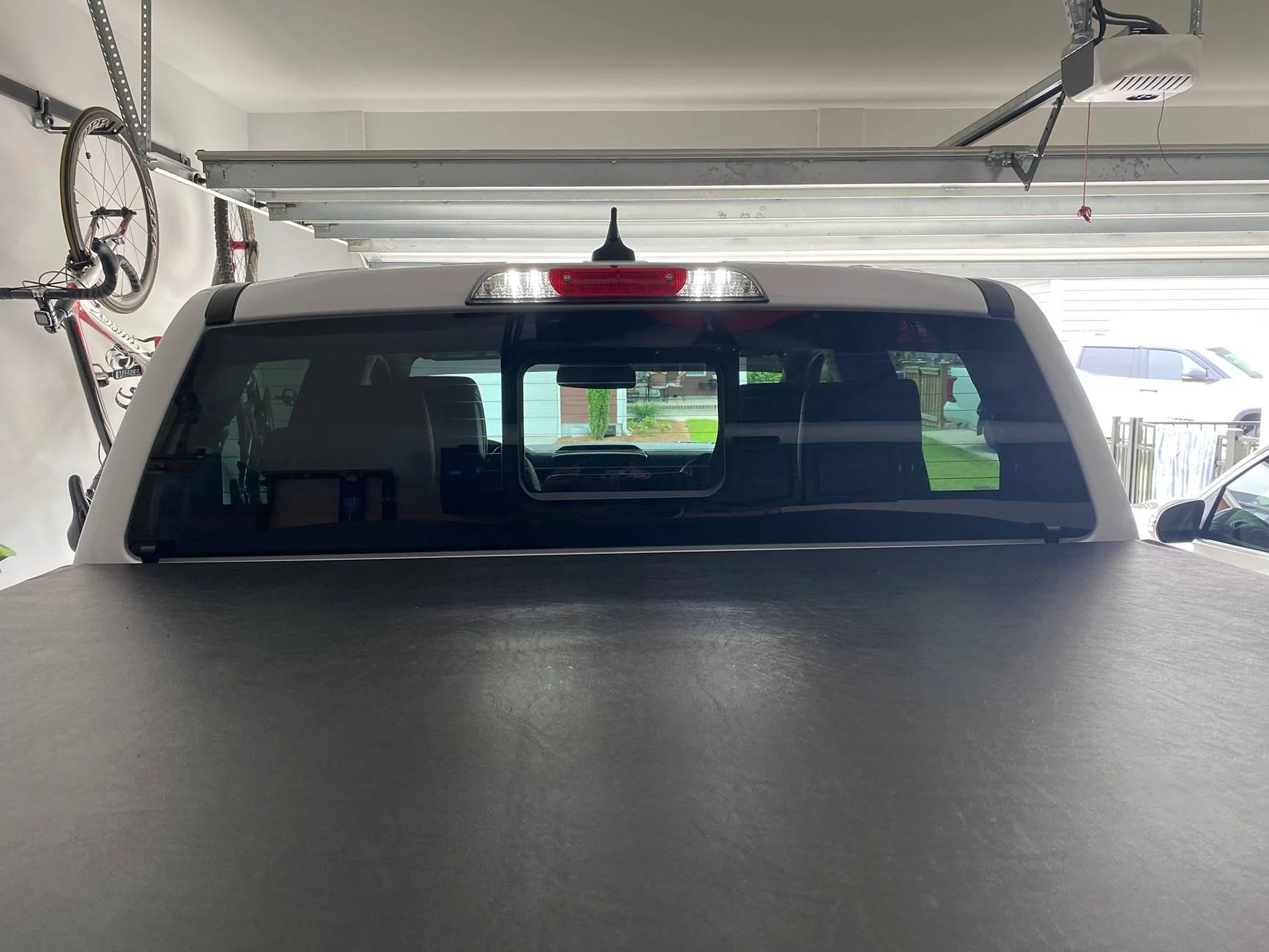

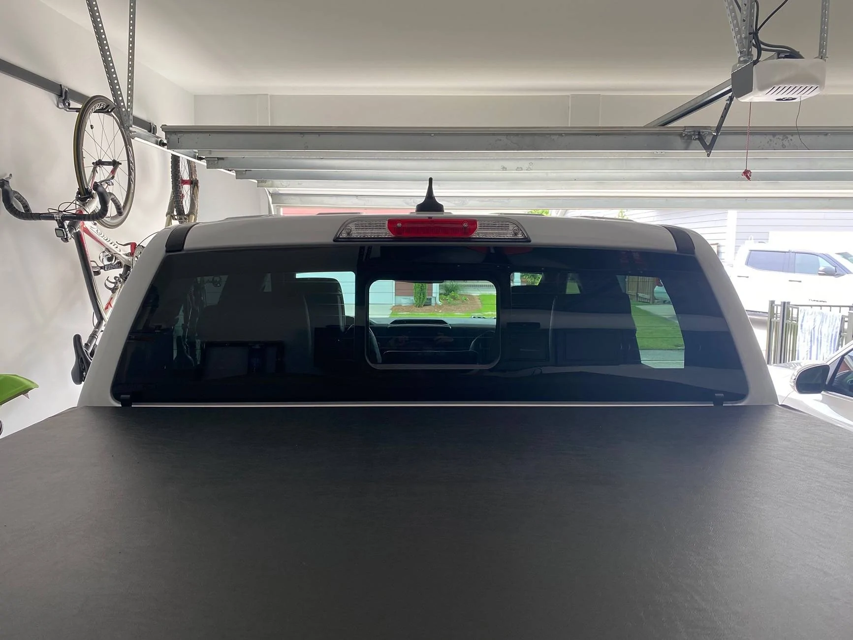

I installed the Morimoto as well, exceptional quality, bright, aesthetically pleasing, and complements the styling of the pickup.
I need that third brake light! Can you share the link of where you purchased it from?

Thanks!
That installation looks brutal! 🤣
It’s honestly not too bad. It feels a little disconcerting pulling on the headliner but it all came together okay. I’d give yourself an hour just in case.

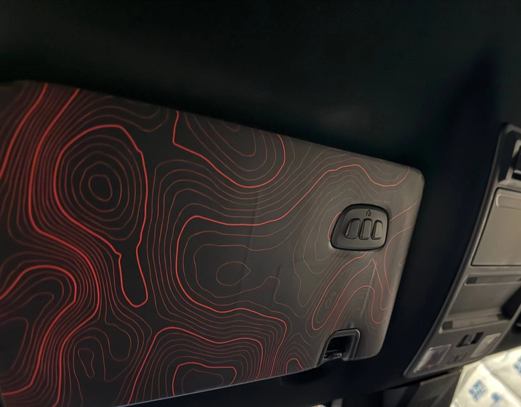

Sticker time:
Excellent stickers indeed, I have them also.
However the vendor will spam your email, even after opting-out of his automatic subscribing. Use a disposable email address.🇺🇸
Mine would have been a lot easier had I known the inside connection of my Raptor is different than the one in the instructions.
Long story short, as to my install, the OEM light was unplugged, the provided connection was utilized, then plug into the light, test, reassemble.
I pulled the headliner down (a pain IMO) per instructions, then found no connection like illustrated in the instructions, I reassembled the headliner, and did as I detailed above.
So….my recommendation would be to unplug the OEM light, and not pull the headliner down if the above works for you, as it did for me.
