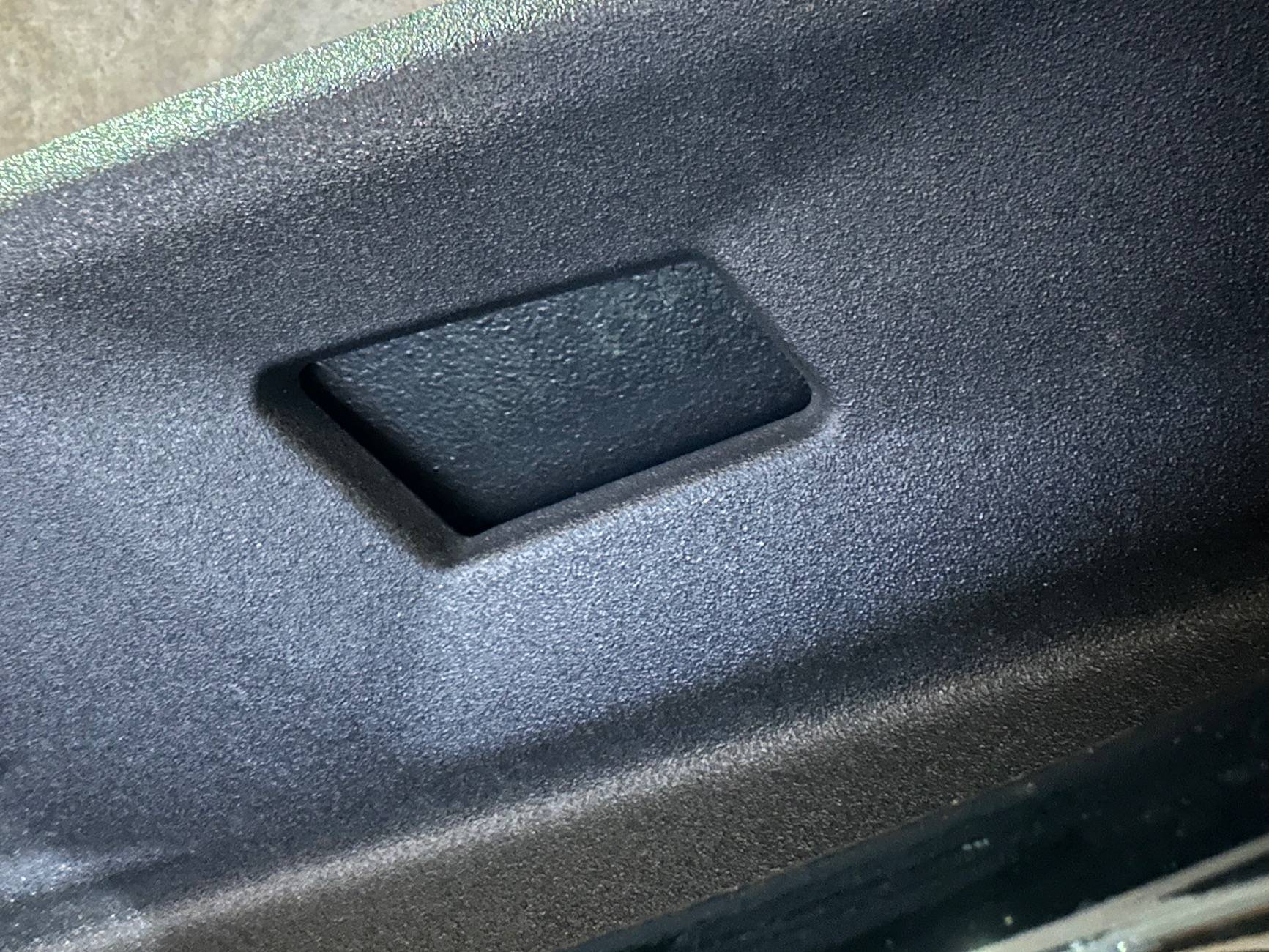

Fabricated some running board drain hole block off plates. It took me about 30 minutes total time to make. I made a template out of cardboard, used some scrap aluminum I had in the garage, DA sanded them and sprayed them with “Raptor” bed liner.

I’m actually going to make another set out of 1/8 inch ABS textured board today and see how those look. Much cheaper than aluminum and no need to spray bed liner on them.

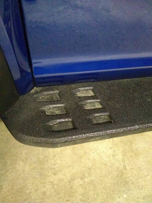

I did something similar when I had my 2017 and 2020 F150 Raptors. I used a thick piece of rubber that was a mud flap from a dump truck. The first pic is from when I was trial fitting it on my 2017 Raptor.
The 2nd pic shows the inserts I run on my Ranger Raptor. They were a little pricey but they look better the home made ones I had.
