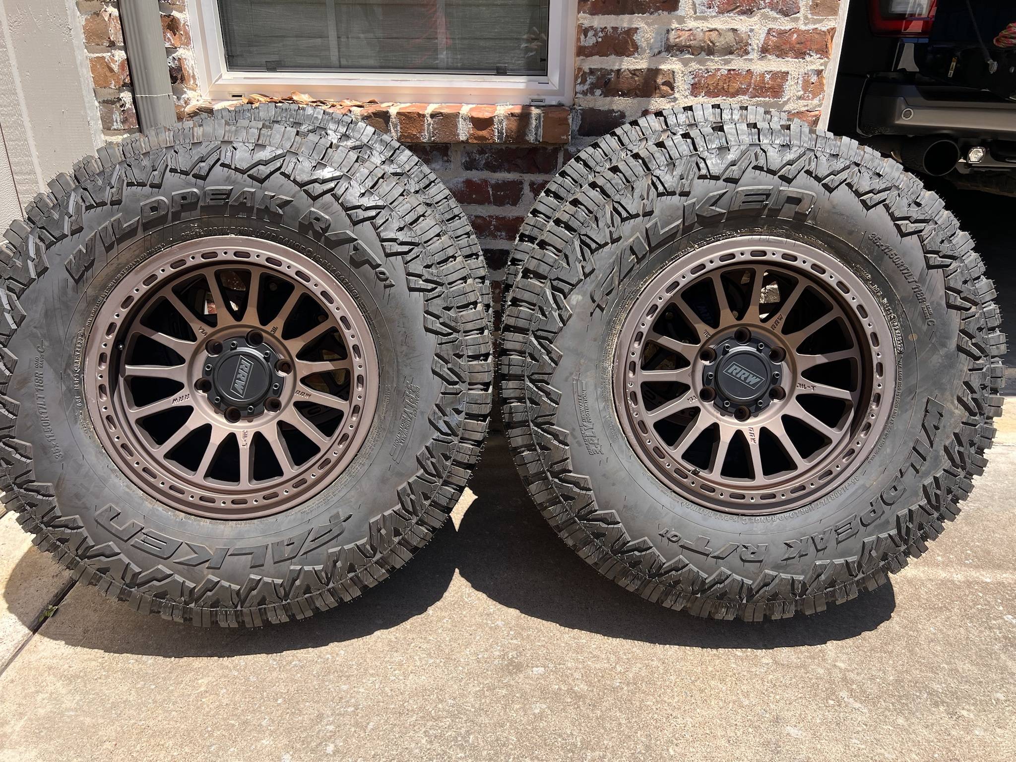

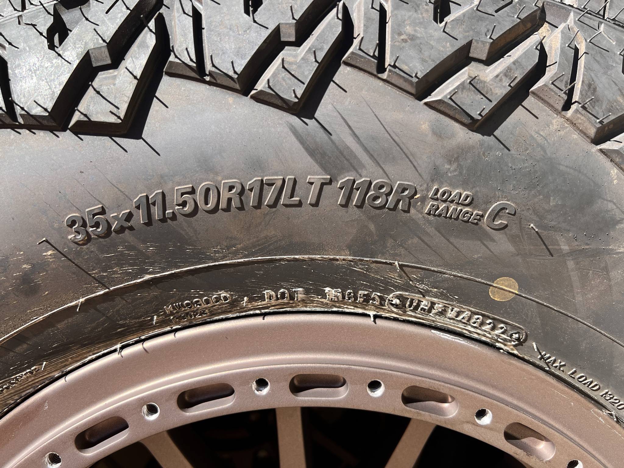

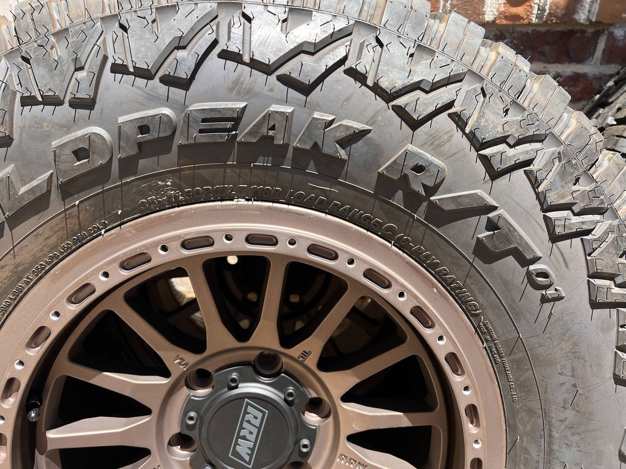

Not installed yet, but got my Falken Wildpeak RT01 in 35x11.50R17 mounted on my Relations Race Wheels matte bronze RR7-H, matte bronze in +25.
Leveling springs will be installed on the Ranger later this week, and these will be mounted up.

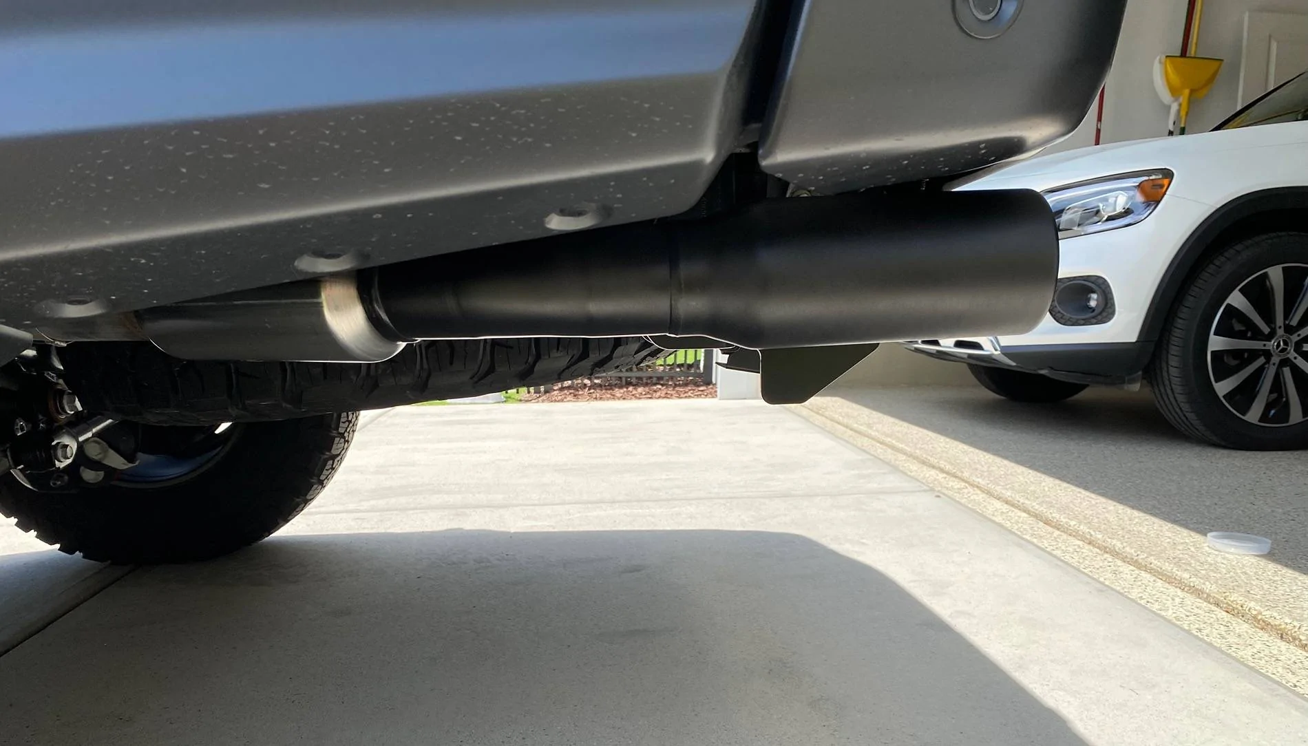

Painted my exhaust outlets. Extremely happy with the new look, should have came this way from the assembly line IMO.
Very nice !
Looks much better!
‘How did you go about it, masking, prep, what paint did you use?

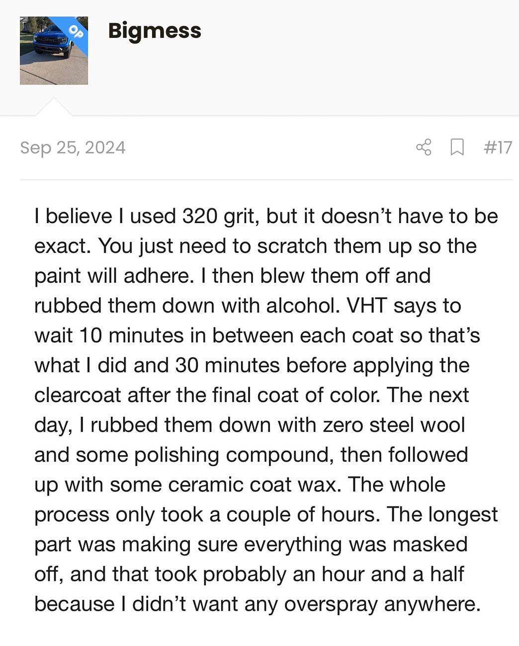

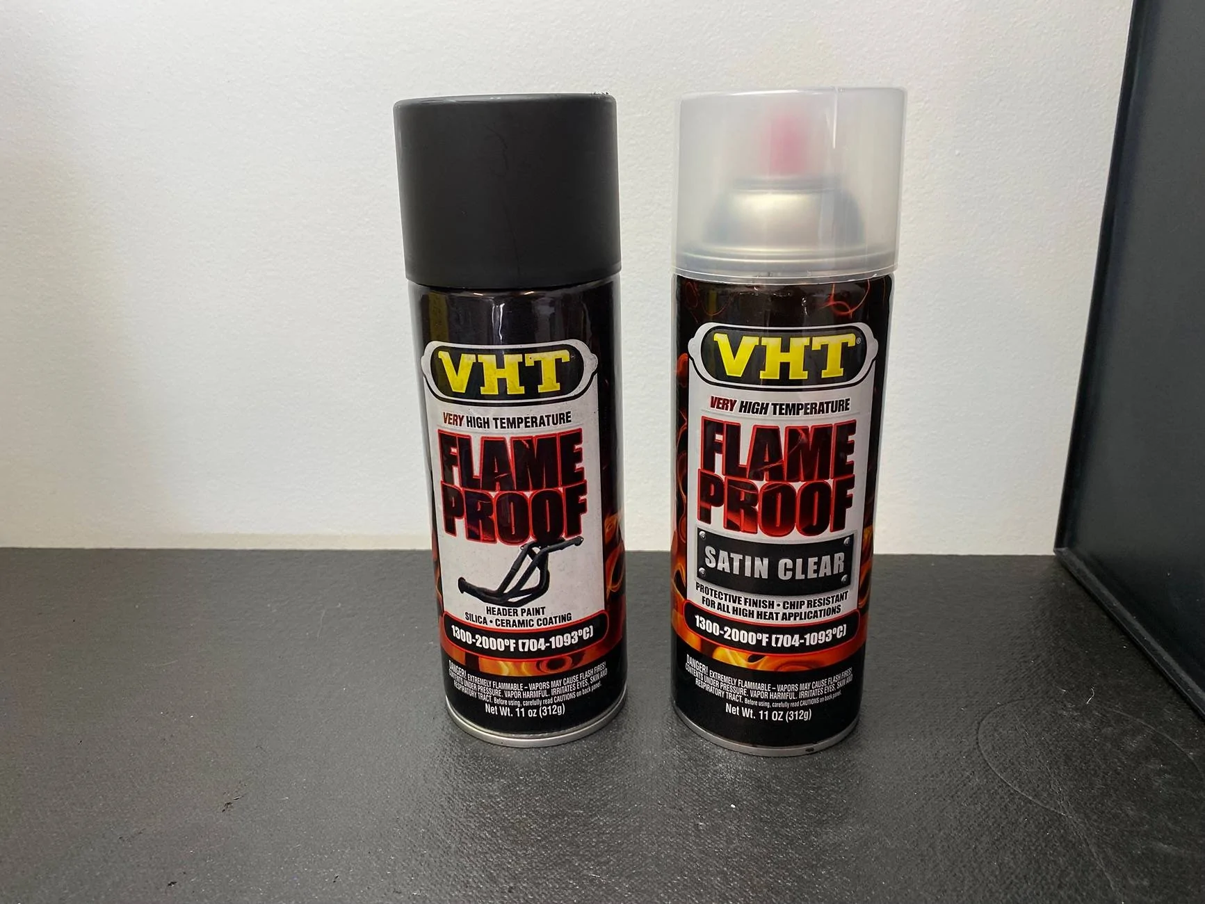

Thank you, they look great in black, should be OEM.
I followed the procedure of another forum member (attached photo). I would recommend waiting 24hrs after the final coat of clear before polishing.
Easy process, unbolt the rear exhaust hangars, use a block of some sort to hold them in place (it’ll be obvious when they’re loose).
Masking takes awhile, but I’m anal.

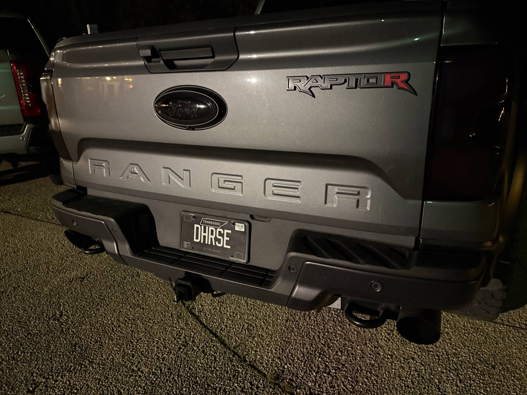

Received my new drop hitch from Temu. Supposed to be light weight and still tow up to 5 tons.
installed but haven’t gotten a chance to test it yet.

That looks pretty weak. Might not be, but Temu vs Harbor Freight, I'll take HF every time.

Interested in pics after you mount your tires and wheels. Looking at the same tire for mine.
