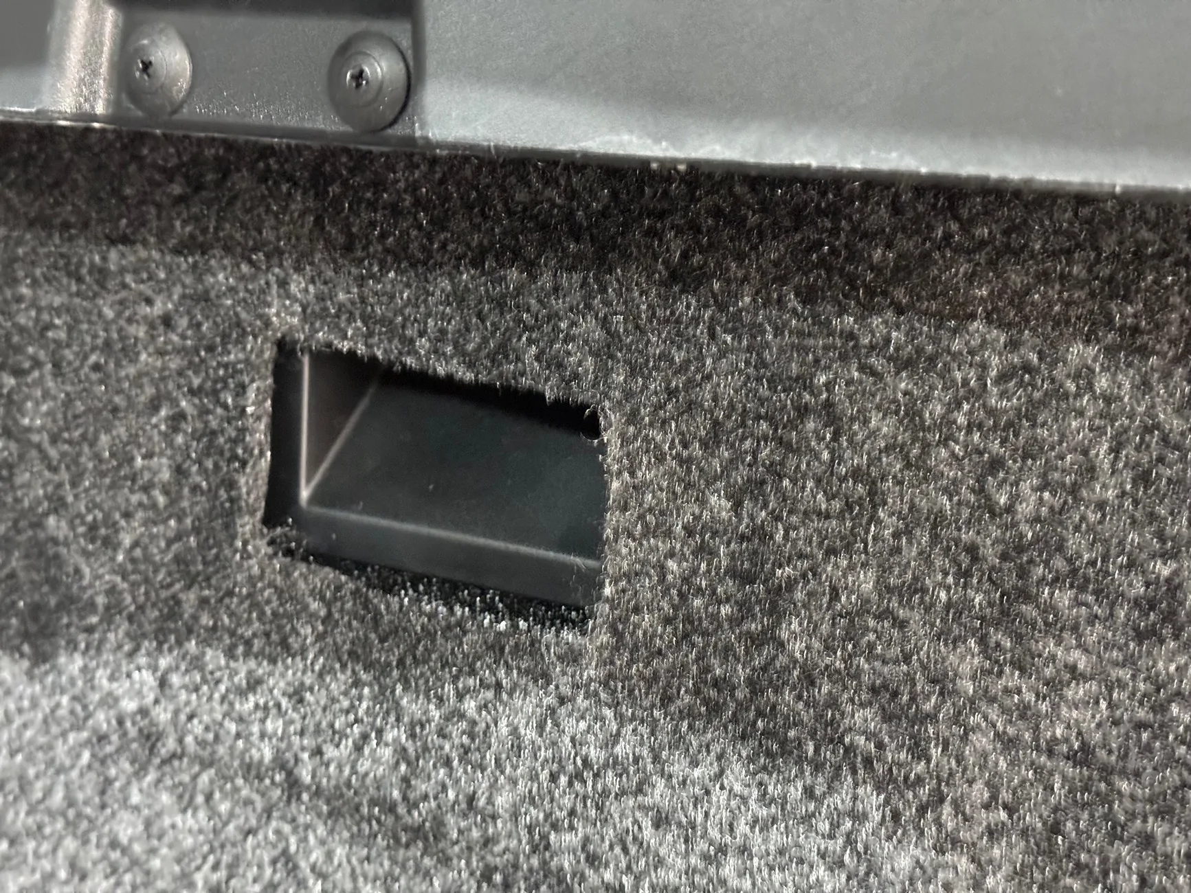

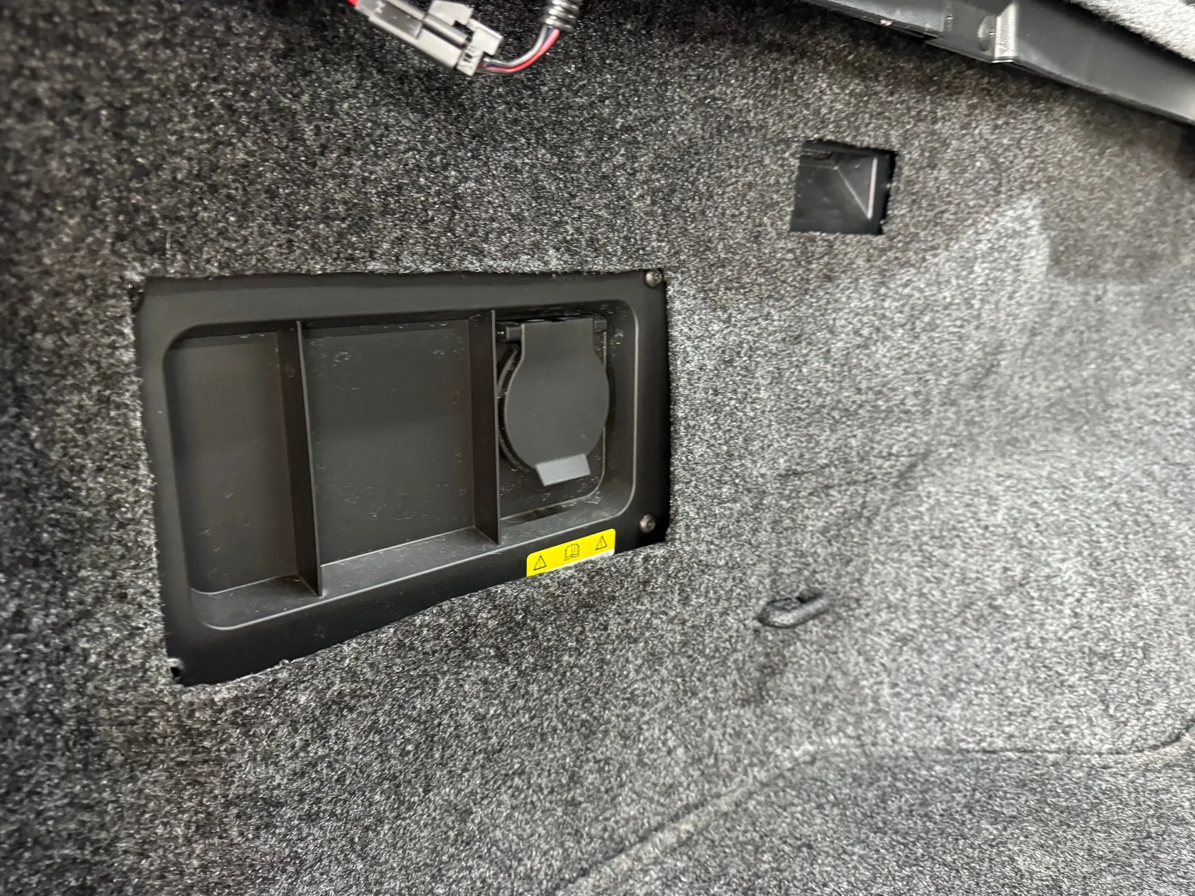

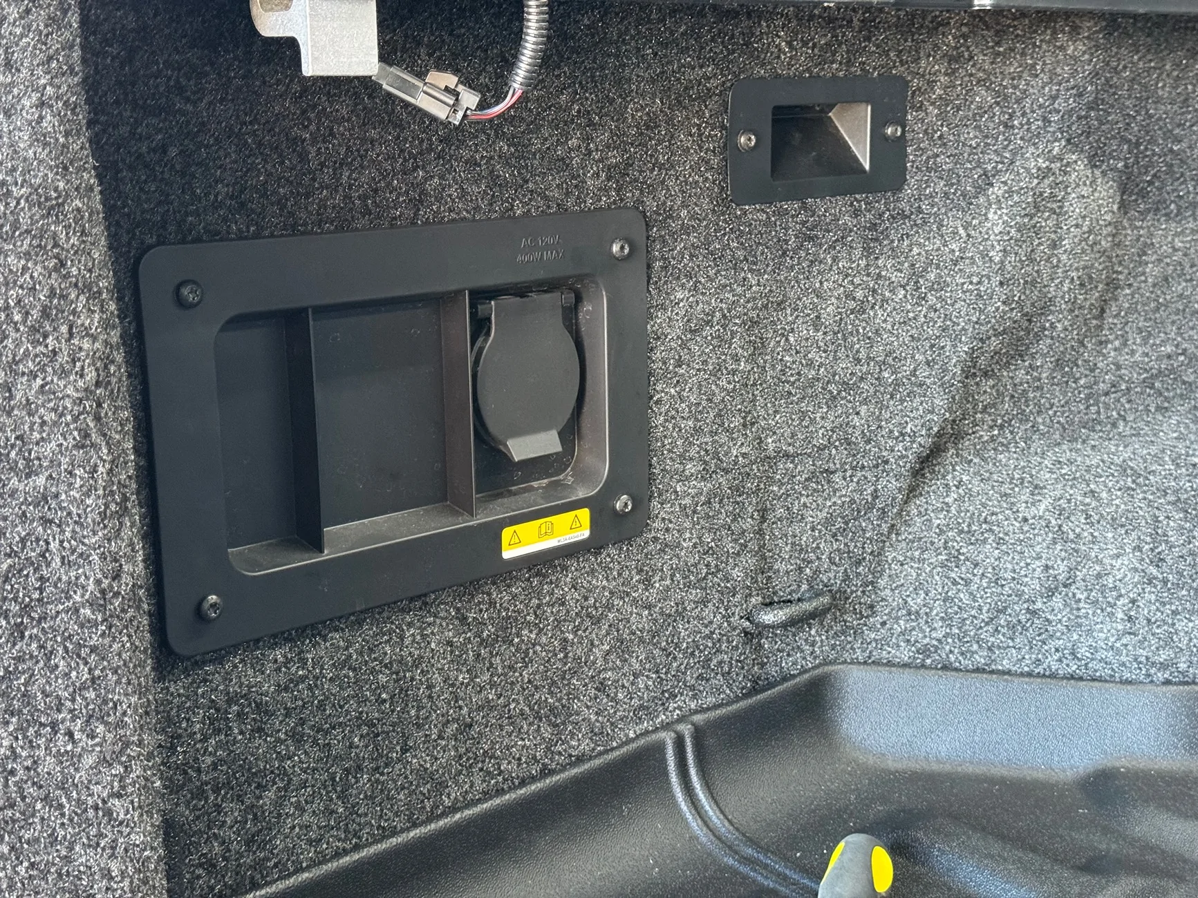

Also fixed the half ass install they did with my bed rug.
Before

After

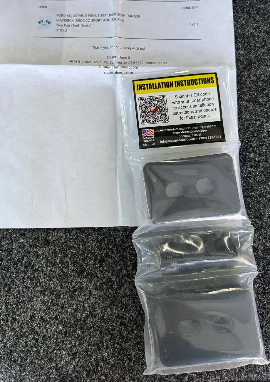

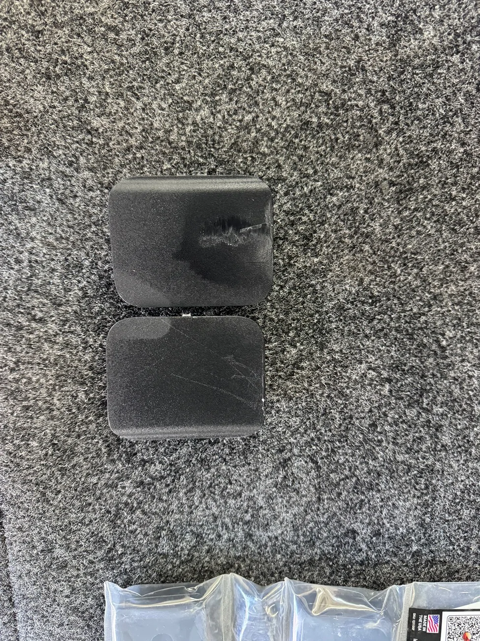

Put in the seat risers I ordered last week.
I wanted more lift in the back of the seat to better take pressure off the back of my legs on long drives.
Hardest part was getting these dang bolt covers off so I could loosen the bolts on the front of the seat. Lol
‘Managed to gouge them up a bit getting them off. 😂

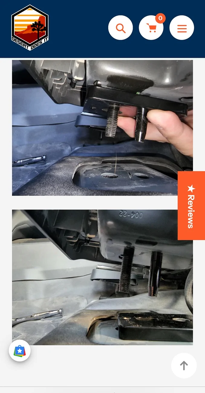

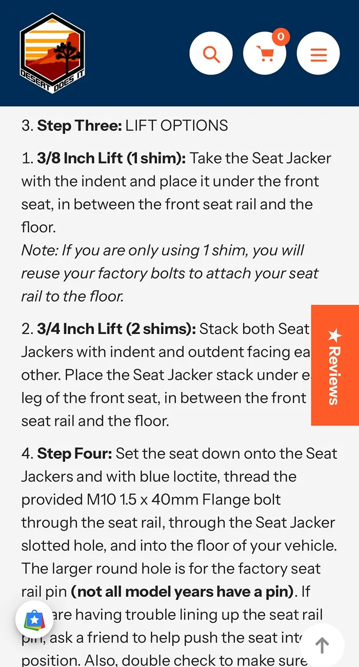

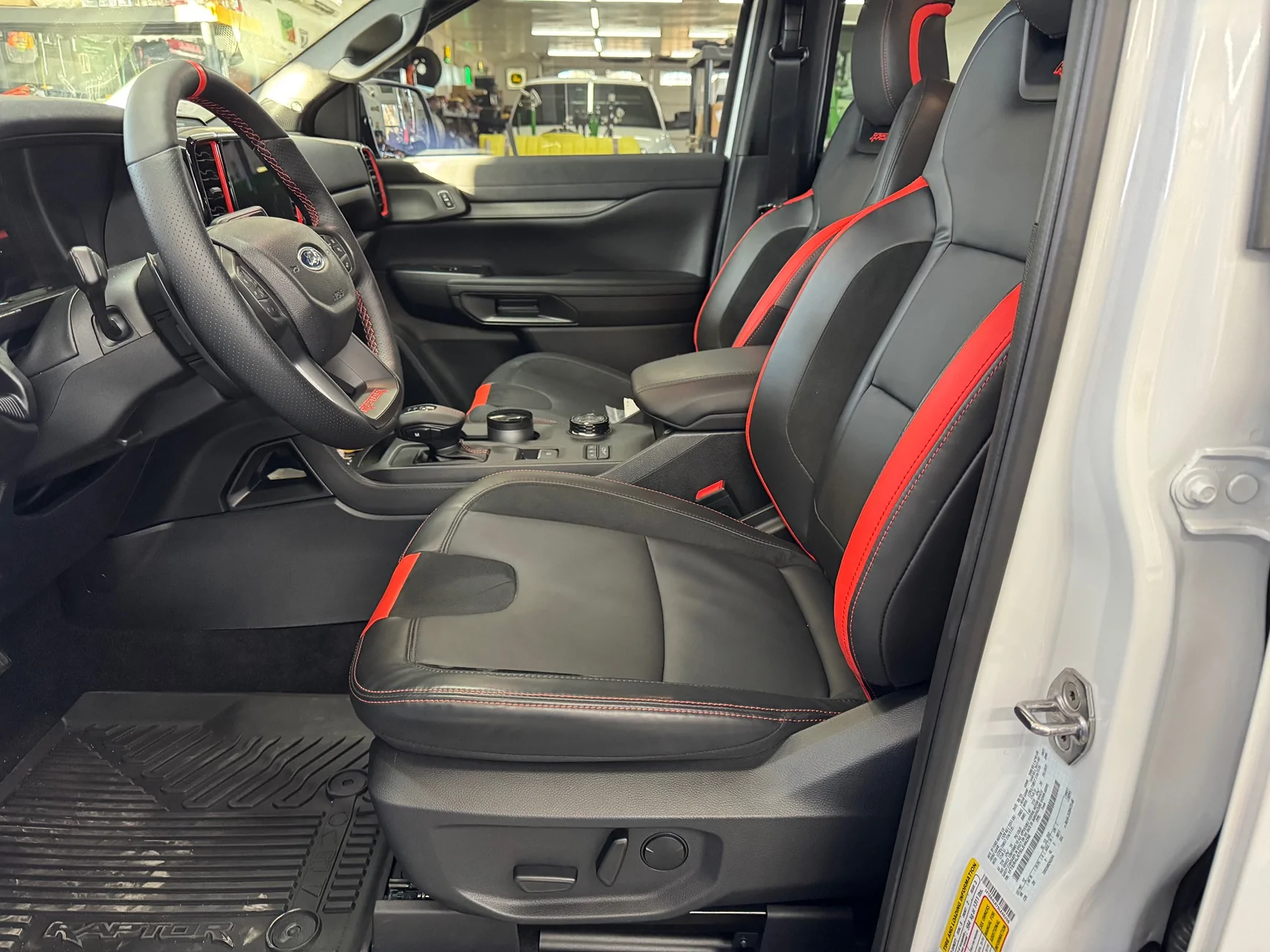

I think so, not really been anywhere since installing them.
I have a 5hr road trip planned for next Thursday.
‘I will find out.
Based on what I know now is I could not tell much difference with only the one shim installed.
I needed both for the 3/4 lift for it to feel much different.
I think it will work nicely can’t hurt.
‘The seats can drop so low on the back side I can hardly see over the wheel and I am 6ft tall.
‘So even now with the lift shims in them I can still drop it down way lower then I can see anyone ever wanting it.
Also worth mentioning is the instructions seem to only indicate these shims are for the front of the seat which would only make matters worse for what I was after. Luckily they did work just fine for the back of the seat as well. The other set is going in my 24 model next.

Couldn’t imagine lifting the front up.
Thanks for the info and will be watching for another update after ur trip.

I checked the Desert Does It website and if u check the ones specifically for the ranger, it states the front or back so your probably good.
2,347
3,148
Sure enough, surprised the instructions didn’t mention that, no big deal, pretty strait forward install without instruction. Nice to know that it was meant for either or.
Thanks for info.
Here is link in case anyone else is looking for something like this.
https://desertdoesit.com/products/f...r-maverick-escape?_pos=1&_sid=4291ca768&_ss=r

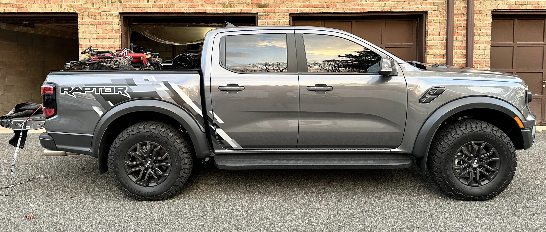

Hauled a Subaru EJ207 around. The truck was squatting a little with the engine and stand.

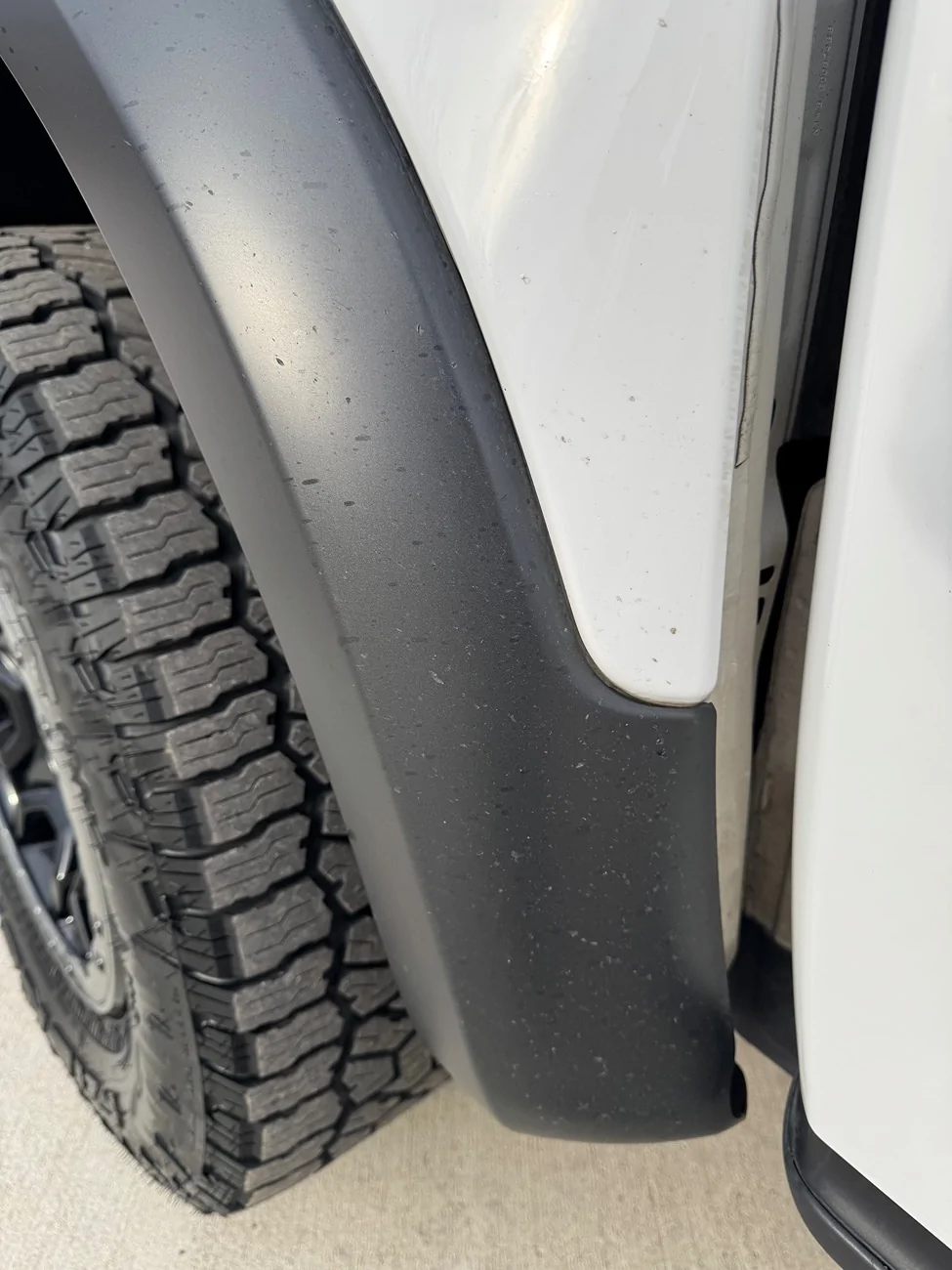

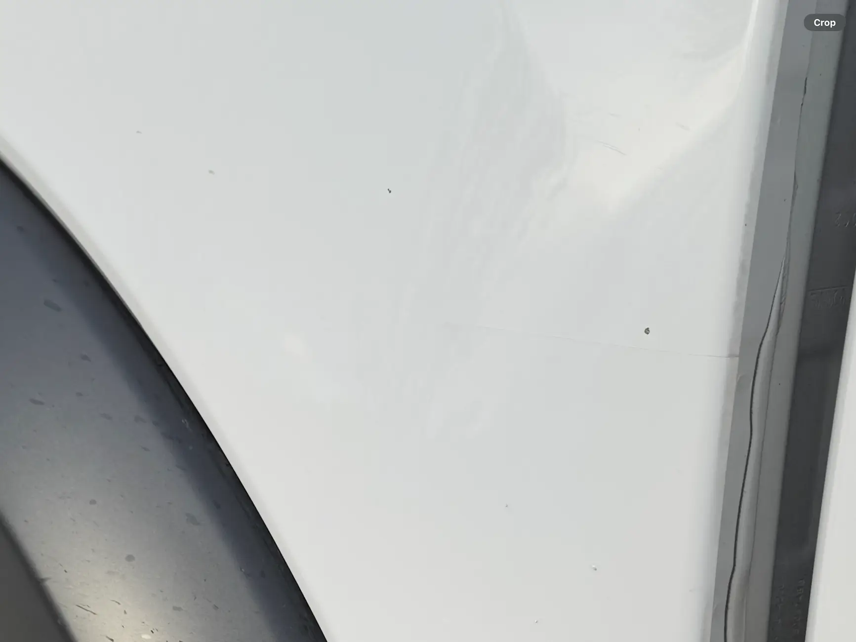

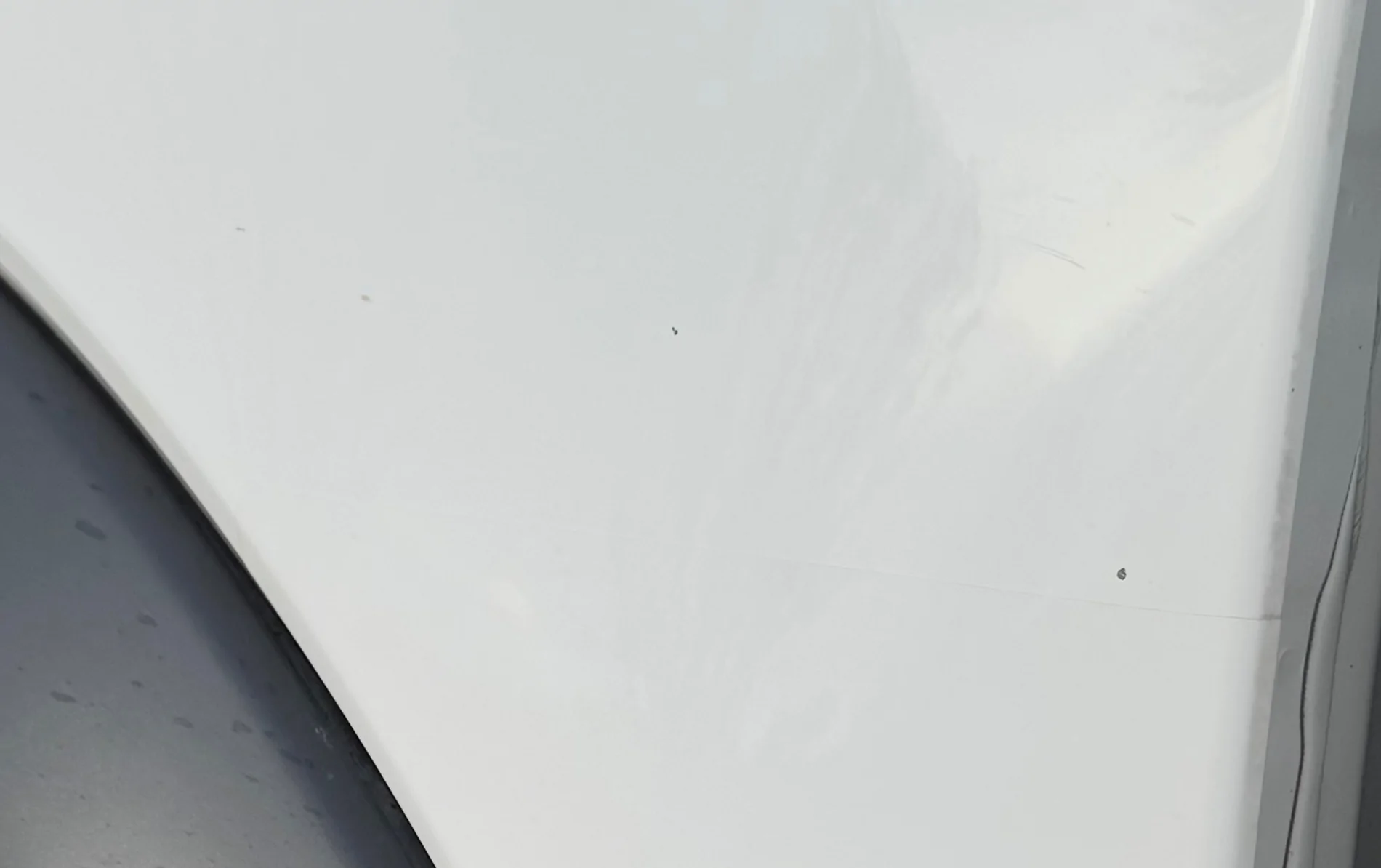

Note the same shop does my PPF work, we were both a bit surprised at the level of damage my back fenders have seen in only 12k miles.
There is price to be paid if you pull off the side steps.
Splash guards, PPF were not enough to save those back fenders from damage.

Dang.... All the way up to the gas cap door level. I did 3M PPF up 10 inches from the bottom--or, about 3 1/2 below gas cap door level.
The KO2' on my former Wrangler tossed rocks just the same--impacting the plastic flares.

Yea, I should taken the PPF a good 6”s higher.
