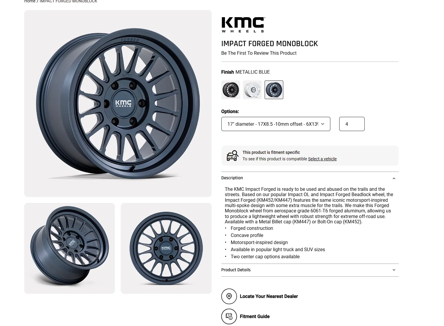

I'm looking at the KMC447 17x8.5 wheel with -10 offset. It's hard for me to see how it's going to look but from i can tell it'll poke out about an inch in a half if I'm correct.  Im new to owing a truck like RR so im still trying to figure it out.
Are you planning a lift ? Crash bar delete?
What tire size?
I really can’t see -11 offset ever working without a lot of other modification even with the stock tires.
That amount of poke even if clearing them could be accomplished, the back fenders are in for a serious beating . Honestly+20, +30, +35, +40 are all much better offsets for the Rangers IMO.

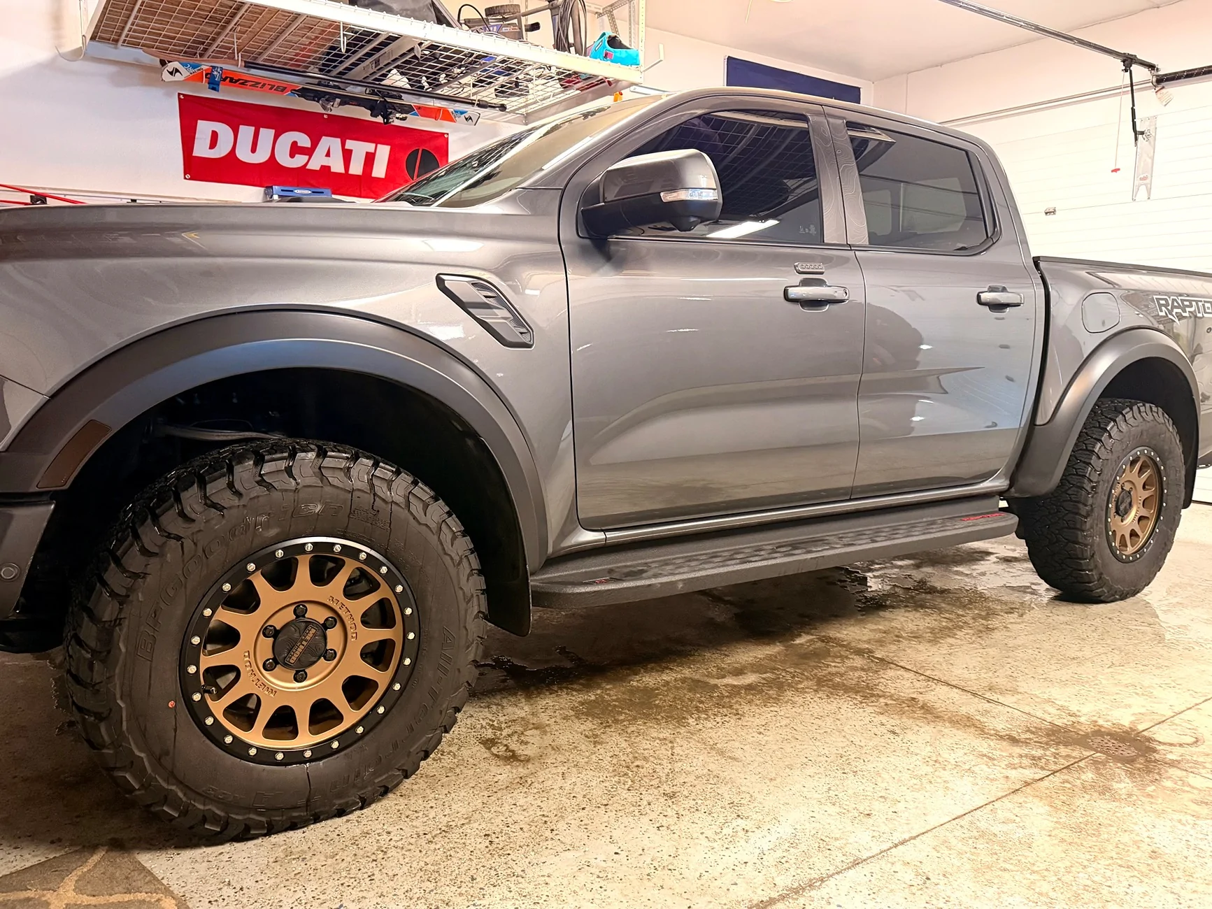

I run a stock 285/70R17 tire size and +30 Offset no other mods and I do clear the crash bars but not by much. Stance is flush with the wheel wells.
Daweism
Jan 21, 2025
457
425
Austin, TX
What tire size?
Based on my research, 0mm offset with stock tires, I found most people said no rubbing when off roading. A couple of people reported very slight rub at full lock on if you have mudflaps installed. a -10 offset would most likely be rubbing a bit off road and definitely on full lock.
