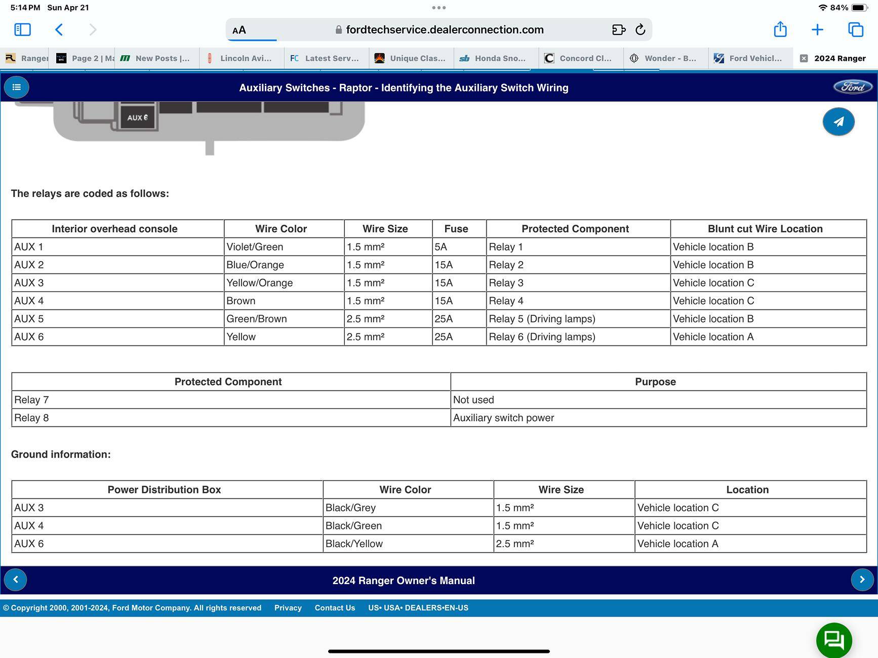

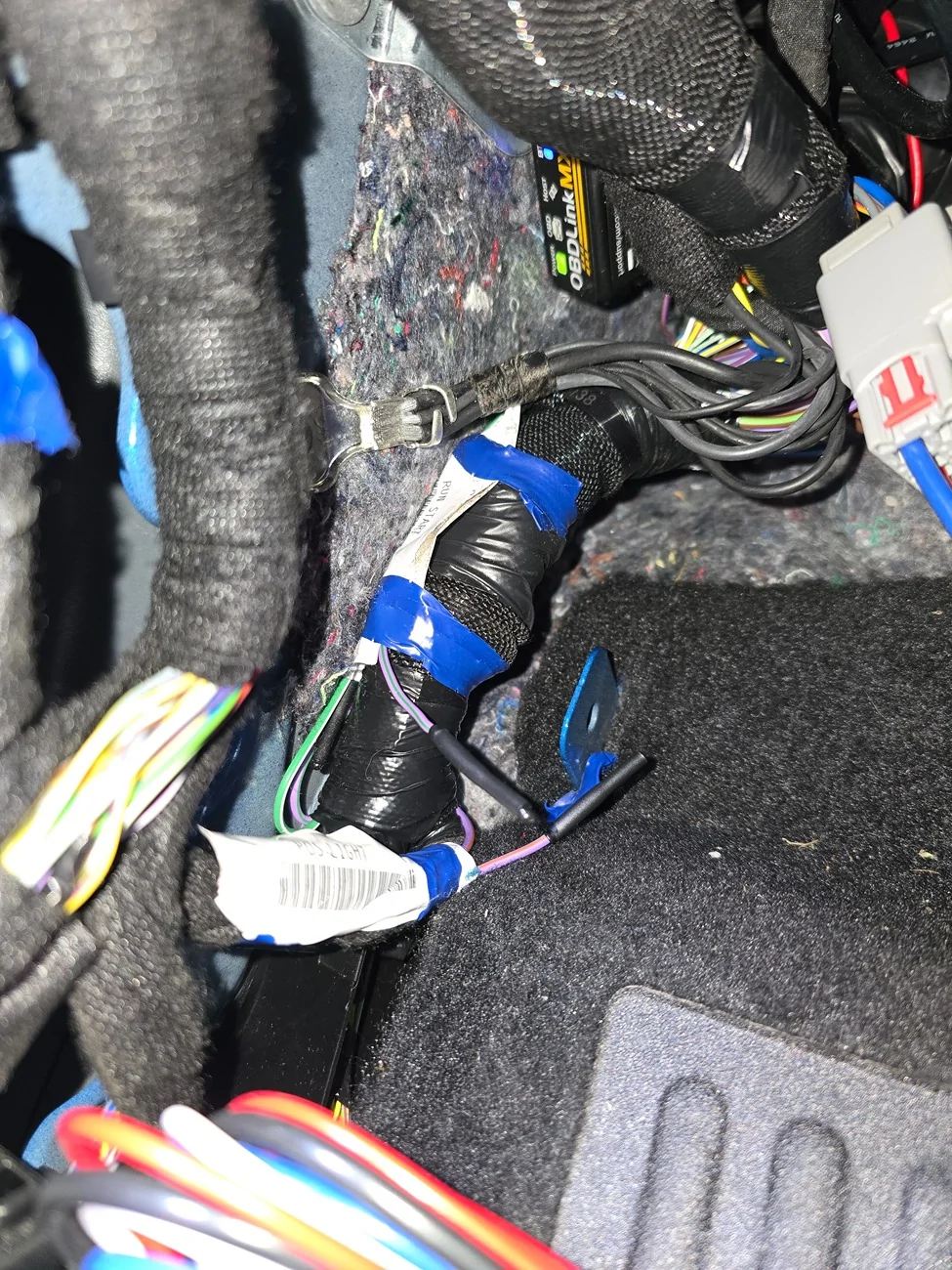

According to the ford pro body builders guide. theres 3 blunt cut wires under the bcm. on my xlt all 3 work, on an aussie one, apparently one of them dont. I think it was the high, the wire was there. but no power.
it also should be there on the raptor. They are used for triggering relays. one high beam trigger, one marker light(pos light aka position) and one run/start(ignition) I use the ign to turn on/off my dswitch and my arb second battery charger automatically, the marker wire puts my dswitch into night mode, and turns on my grill lights, and the highbeam is hooked to one the dswitch programable trigger inputs, and right now is set to turn on my lightbar with highbeams.

That looks like the internal harness, I'm trying to find the Aux wires, can you highlight where they are ?
