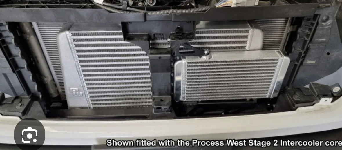

When I am in Baha mode, the temps get around 225 to 230 a lot. This happens also when I am in snow and spinning the tranny at high RPMs. I saw it get to like 240, so I chilled out on the throttle until is cooled a bit.
Is this normal or in any way damaging? 230 is not that hot, but doing this for extended periods of time (which is actually when I have the most fun) could break the oil down really quickly. I was thinking about getting an aux trans cooler with a fan for the heck of it. Not all that expensive, but what do you guys think?

One other thing, what do you guys think regarding putting one under the truck with a fan verses one in front of the radiator/ac condenser? I think I would rather have a fan one underneath or elsewhere rather than in front of the radiator.

One other thing, what do you guys think regarding putting one under the truck with a fan verse one in front of the radiator/ac condenser? I think I would rather have a fan one underneath or elsewhere rather than in front of the radiator.
I believe it's water to oil cooler. So, the trans cooler is part of the main heat exchanger system (aka what most refer to as the radiator) and runs the transmission coolant through water jacketed cooling block.
The Ford specs listed it as air to oil cooler, like a race vehicle, but that is incorrect as far as I know and its water to oil which is more common. Air to oil coolers work better than water to oil coolers at high speeds, but not at lower speeds as the main radiator has far more cooling capacity and active fans, so for most applications, trucks or high-performance cars with autos usually have water to oil coolers.
