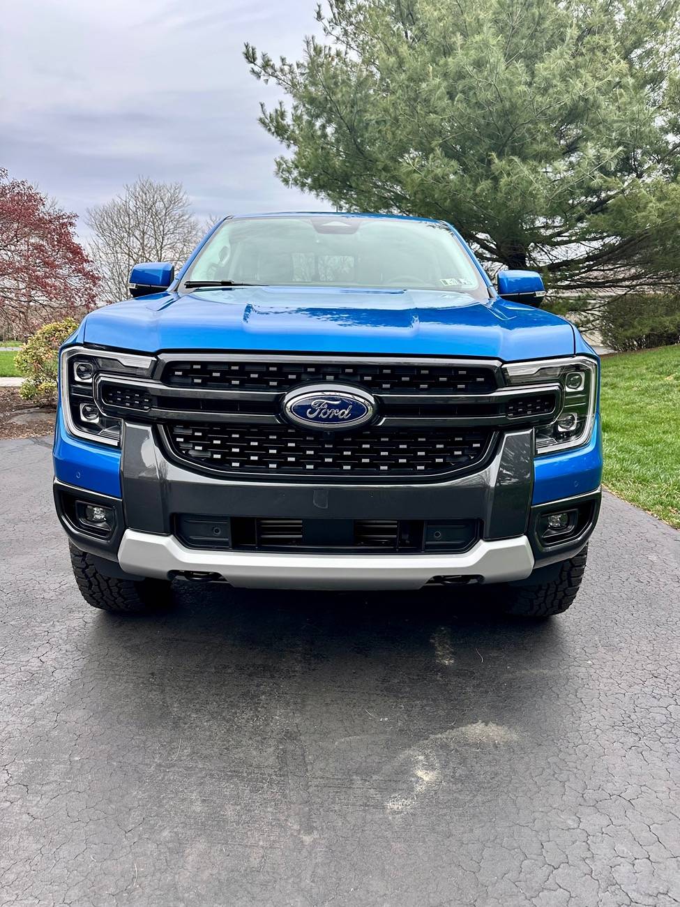

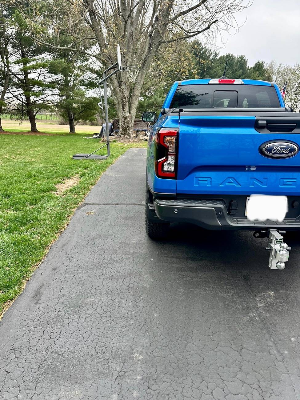

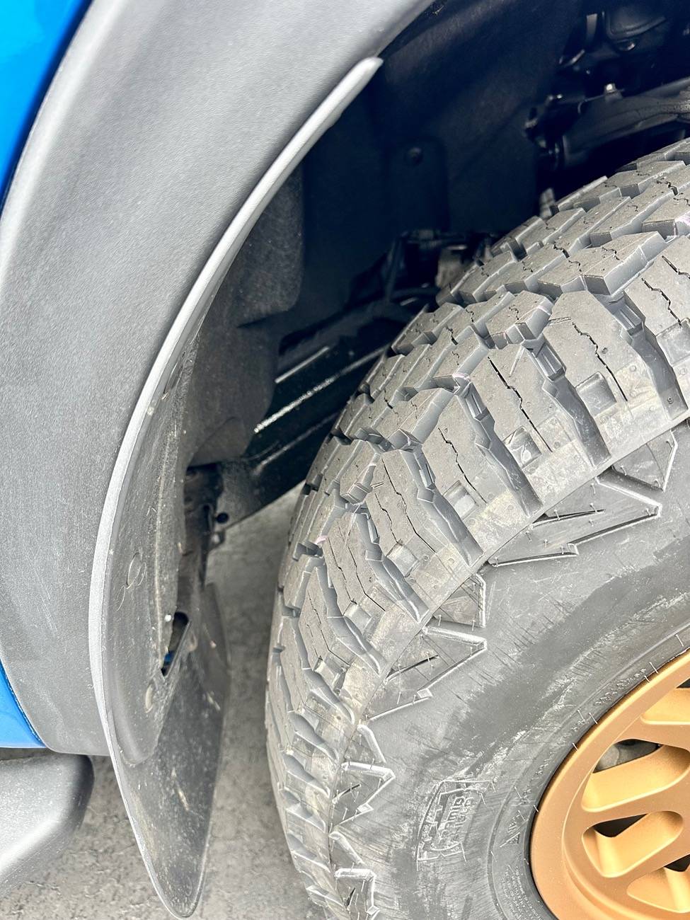

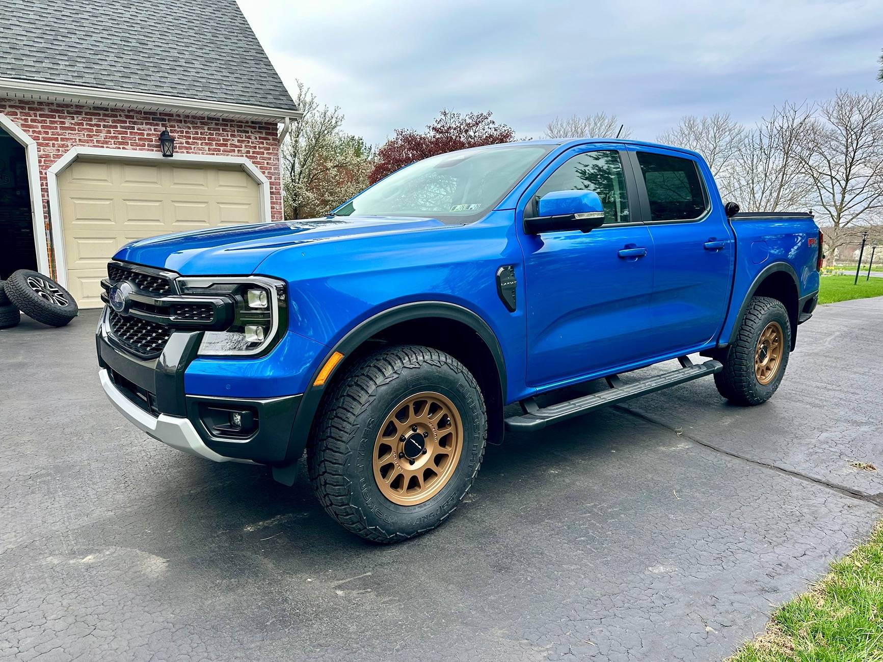

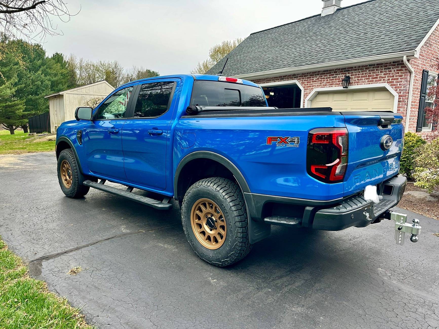

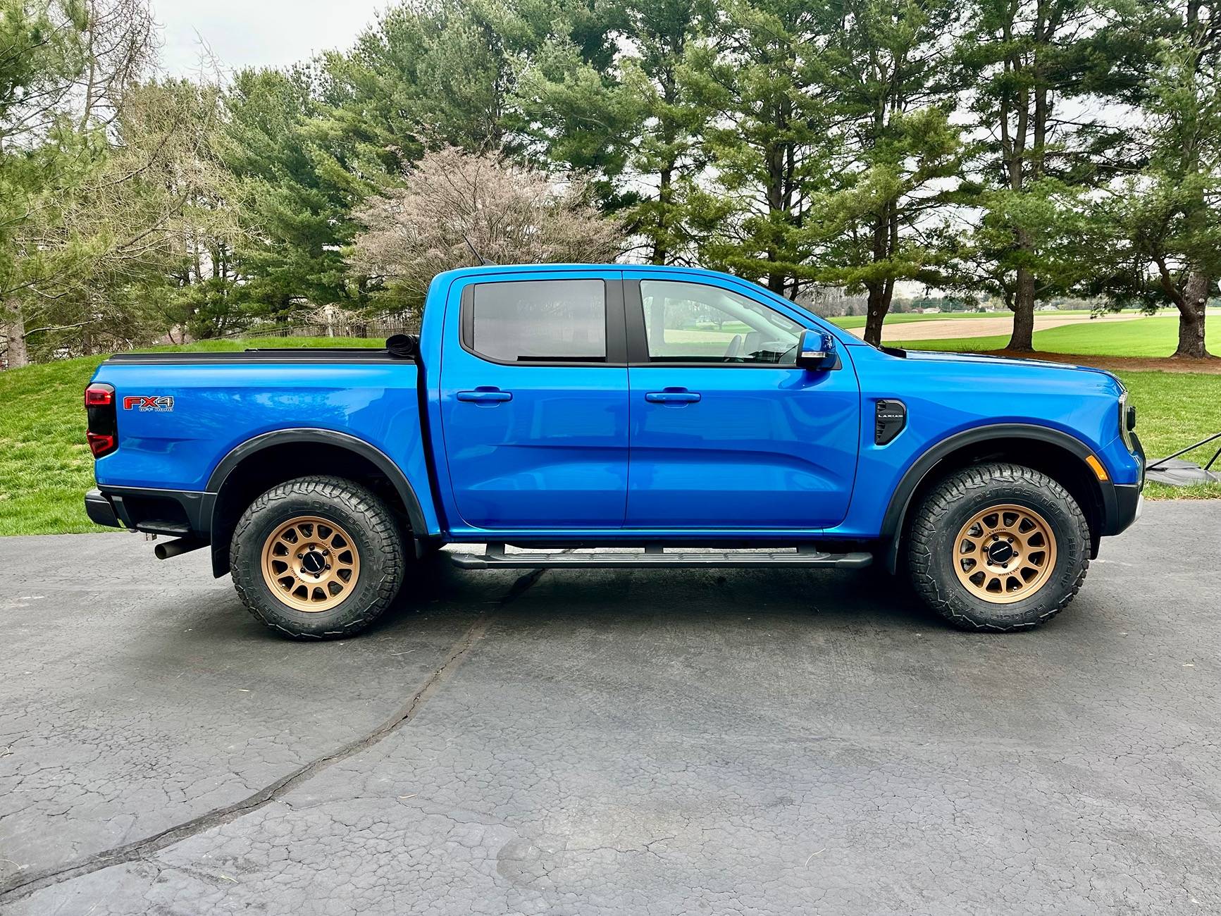

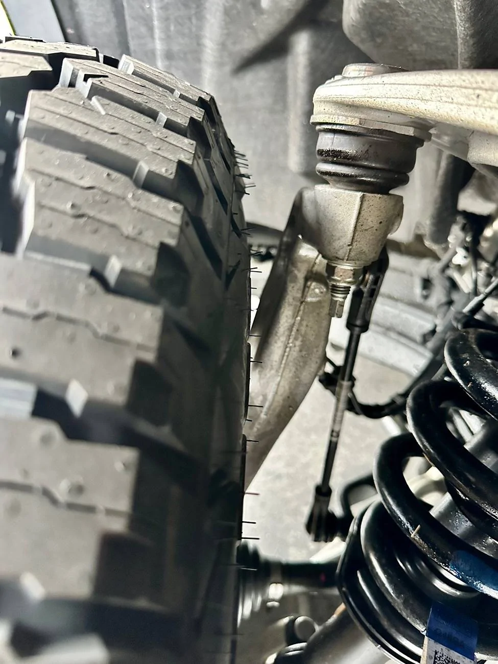

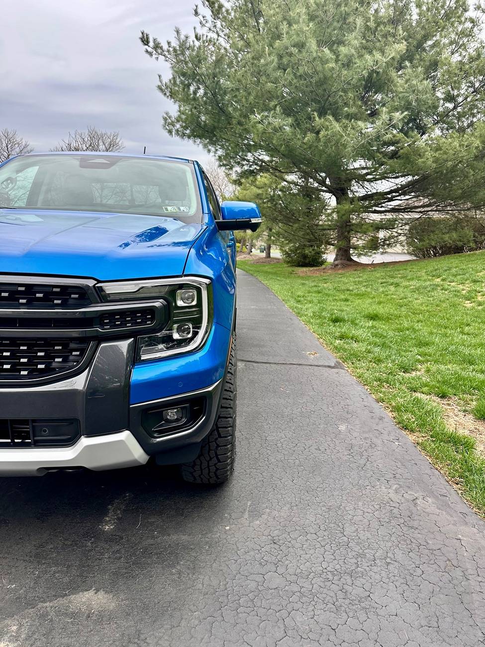

I just installed a set of Nokian Outpost nAT tires on a set of Method 703 rims with +35mm offset. The tires are 255/75r17 which are about 32” (32.1”?) and same width as the original tires. The nokian’s diameter is 1” taller than the stock 255/65r18.
No clearance issues yet and I don’t anticipate having any problems. I did not lift the truck or add spacers or do anything at all to the suspension or anything.
The truck came from the factory with Goodyear wrangler territory at (not at/s like the 2024’s I saw had). The Nokians are slightly louder than the stock Goodyears, though they’re also less inflated (30lbs) than the Goodyears were (35lbs). Both the Goodyears and the nokians are the same width, but the Methods are 8.5” vs the stock rim’s 7.5 so I expected a bit more stiffness from the Nokian/method combo. I haven’t noticed a difference yet so maybe the stiffness increase was offset by the nokians being slightly taller? I dunno…

I like those wheels a lot and wanted to get them for my Raptor. I just thought +35 might not be wide enough and I never saw any pics of those wheels on a Raptor to find out.

This combo looks really good, been considering doing something similar on my 24 XLT (I like the Bronze with the Blue, but I'd go silver since my truck has the Chrome Package). That tire size and wheel offset looks dang near perfect on a stock truck IMHO (maybe go for a 265 width if that's an option?).

Thanks for sharing your setup. It sounds like everything is working fine so far.
The Nokian tires are a bit taller, so they might feel a little different while driving. The lower air pressure can make them feel softer and a bit louder too. If you bump them up to 35 psi, they might feel closer to the stock ride and make less noise.
The wider Method rims can stretch the tire a little, which can add stiffness. But since the tire is also taller, that can make it ride a bit softer. So you're right — the changes might be balancing each other out.
It’s good there are no clearance issues. Keep an eye on it over time, especially when turning full or hitting bumps. Sounds like a solid setup overall.

I’m not generally a fan of bronze wheels, but that actually looks really good. Well done.
