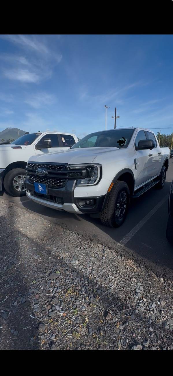

Starting base:
2025 Ford Ranger XLT FX4
  • 2.7L
  • Tow/Tech Package
Coming from a 2019 Ranger, I actually did prefer the old design at first, but I wanted the 2.7. Over time, I’ve come to actually prefer the somewhat wider front face of the new one.
Ford Ranger Ranger FX4 2.7 Build thread : Nāhele Ranger IMG_5296

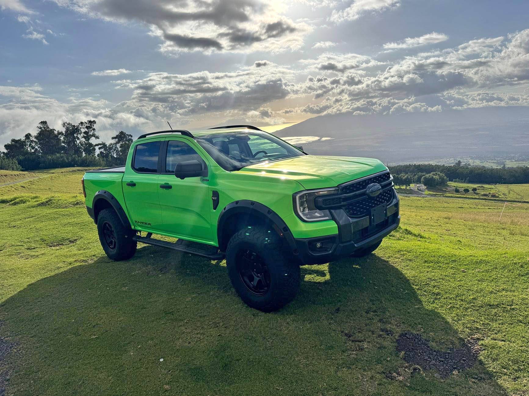

Wrap and lift:
The wrap and lift pretty much happened around the same time. The lift is a Rough Country 3.5" kit. I plan to upgrade to a better setup eventually, but so far it’s been great.
Fitment challenges:
Making the rims and tires fit was a bit of a pain. I feel like I was a bit conservative with my size choices, but maybe not after reading other builds.
I trimmed the crash bars and the wheel well fabric and was able to tuck and cut enough to make everything fit — pretty much the same process I used when fitting 33s on my old Ranger.
Heres how it sits currently. Loving it.
Ford Ranger Ranger FX4 2.7 Build thread : Nāhele Ranger IMG_5283
Ford Ranger Ranger FX4 2.7 Build thread : Nāhele Ranger IMG_5267
Lots more to do, Just waiting on a front bumper to add a Winch but it's looking like that'll take a while. I'm in talks with hamer4x4 to maybe buy one and see if i can jerry rig it and make it work but we'll see..... I also want to color match my fender flares but I didn't have enough wrap. I actually managed to wrap the whole thing with 5x59 feet of wrap and that's with not messing up at all.
That's it so far. if you have any question wrapping or fitment let me know. Plan to have this for a long time. Super excited to be a part of the community!

Love the stance and the seat covers. Were they hard to install? Im looking at a 1.5" Eibach coilver kit just to level it up. But may go 2.5" now.
I was going to say, I think 295/70̸R18 is the biggest size I've seen on a non-RRaptor 6G Ranger, and -55mm as compared to stock is pretty aggressive on the offset front.
I know y'all are big on the XL tires in Hawaii, but I'm curious as to what prompted the jump to 34s and interested to see how that works out over time. Did you do any supporting mods aside from the lift & trimming?
Definitely more annoying than some spacer lifts because requires spring compression. .. I went 3.5 because people reported it not leveling it out with the 2.7 engine being that it’s heavier, something to think about. I’d go 2.5 if I were you.
Over here it’s definitely still on the not so crazy fitment side. As far as rangers it definitely is tho I’ve only seen 3 other stock rangers out here.
as far as supporting mods nothing outside of what the lift came with. Unfortunately there’s not much out there currently. Regearing in the future if I go bigger. I’m monitoring my axle angles. The tune will happen later this year but I want to get used to the power it has atm.

I like it. Not the color, but the rest of the build is really pretty impressive. I didn't see it mentioned (or maybe I missed it) but who makes the wheels? Those look great! Looking forward to watching your progress from here.
they're These on ebay . They're solid arrived fast. Cosco damaged one putting a Tire on but otherwise they're great. The reason I went with these is I have OG TE37s coming in for my nd miata end of the year so I figured it would be sick to have my truck with reps and my Miata with authentic Te37s
