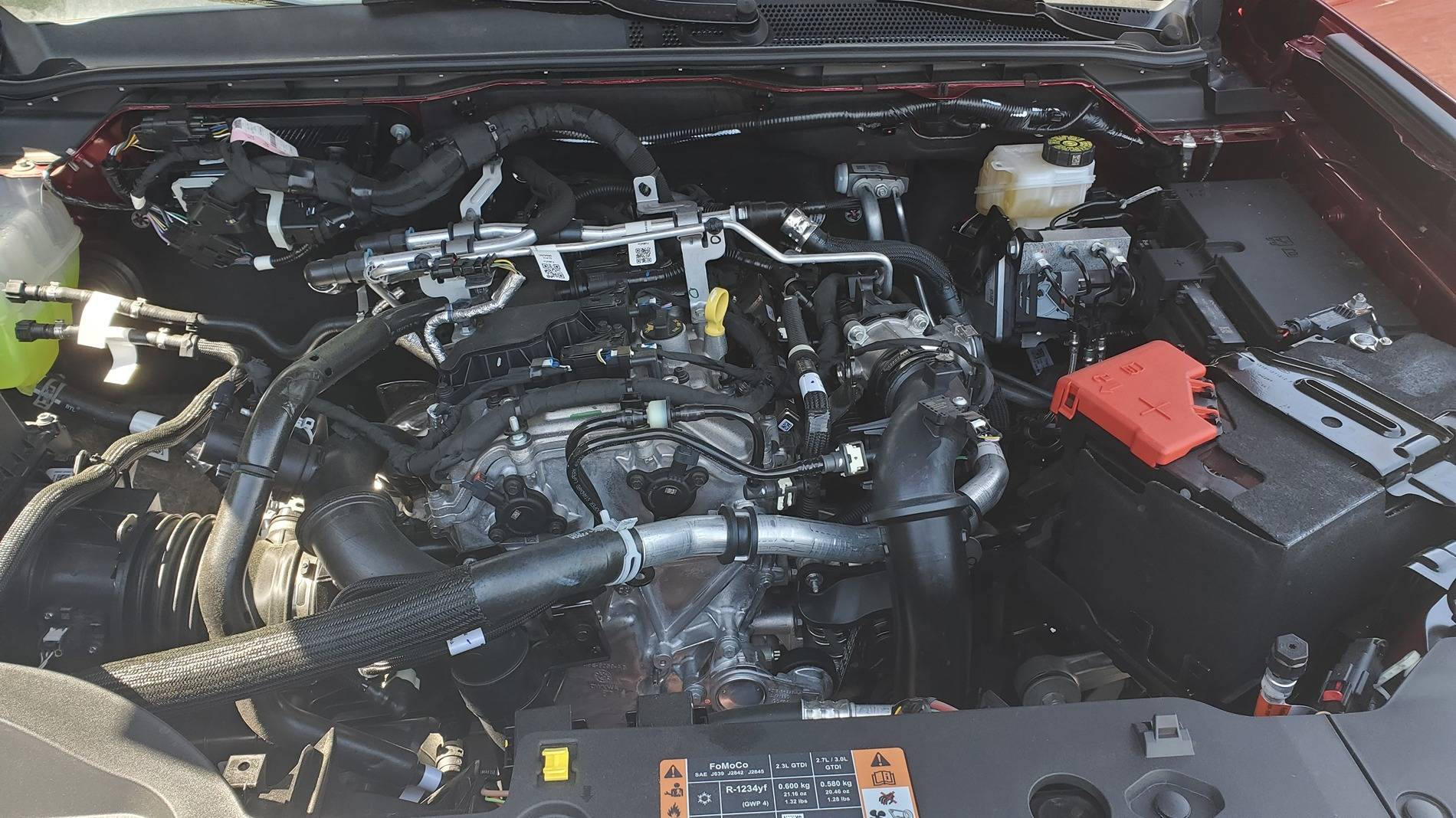

Yep, Got
Ford Ranger 2025 Ranger 2.3 calls for 5.6 qts of oil 20250325_122634
Ford Ranger 2025 Ranger 2.3 calls for 5.6 qts of oil 20250325_140743
the new motor. Why the big secret from FORD??

Just to close the loop on this, as rangerjimm said, the 2024 and 2025 2.3L are two completely different engines. Different stroke. Different bore. Same displacement. Different compression. Change from belt driven oil pump to gear driven. Alternator location changes. Brake pump is electronic boosted instead of vacuum. Turbo becomes twin scroll and smaller bore making more mid range power. HP almost definitely goes up even if Ford isn't reporting it while 2024s still sit on lots. Electronic waste gate introduced.

Understandable. It's wishful thinking on their part. They have a 2024 and want to believe that somehow their year is superior (in my belief it's not). In addition to everything I have cited, the majority of 24s only support 85lbs at the bedrail without an add-on support part.
