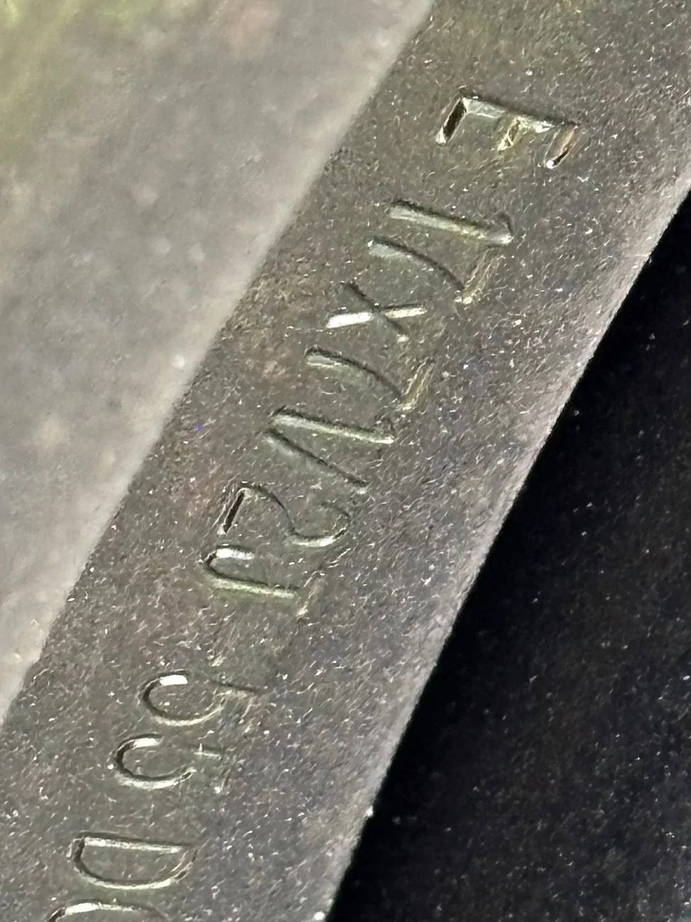

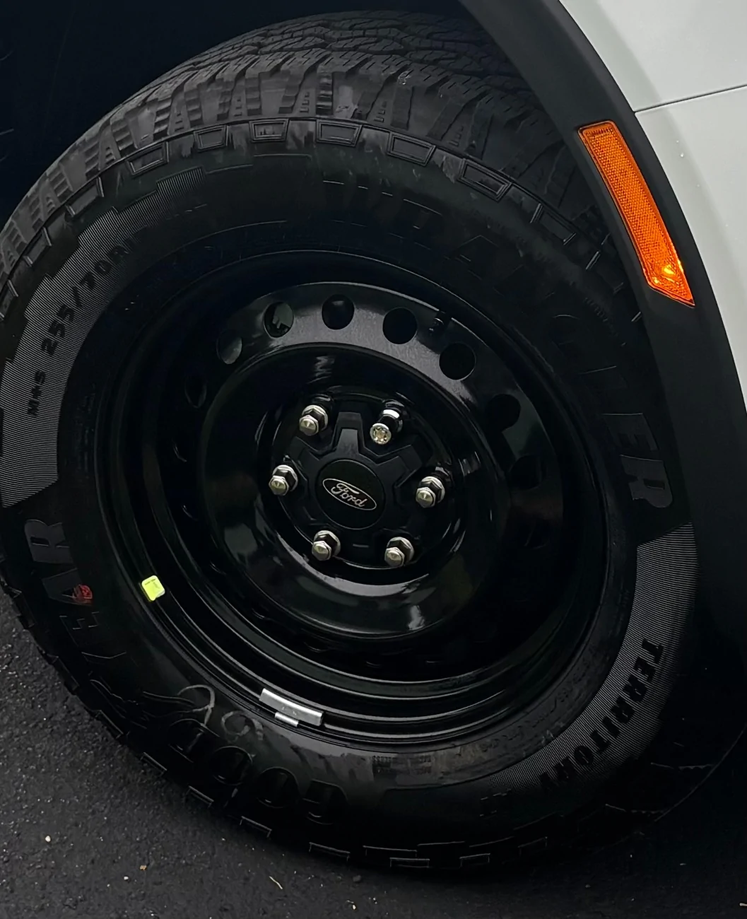

I just purchased a 2026 Ranger XL. It has the painted rims which I would call "Steelies". The rim on the steelies show "17 X 7 1/2J. I am looking at wheels.
I found wheels I like the specs are 17x8.5 6 bolt pattern should fit the Ranger. Will this wheel work with my Ranger and the existing tires?
Thank you in advance.

Maybe? The lug pattern needs to be 6x139.7 (6x5.5”), and consider the offset in concert with the tire size you want to mount.

here's the specs on the ones I am looking at
  • 17" x 8.5" wide
  • 6-lug, 139.7 mm bolt circle
  • 55 mm offset
  • 177.5 mm backspacing
3,661
3,454
Bolt Pattern: 6 × 139.7 mm (or 6 × 5.5 inches)
Center Bore: 93.1 mm
Thread Pitch: M12 × 1.5
Factory Offset: +55 mm
Factory Rim Sizes: 7.5J × 17 or 8J × 18
That's stock according to googly so you will be good. .5 inch wider wheel is .25 per side
