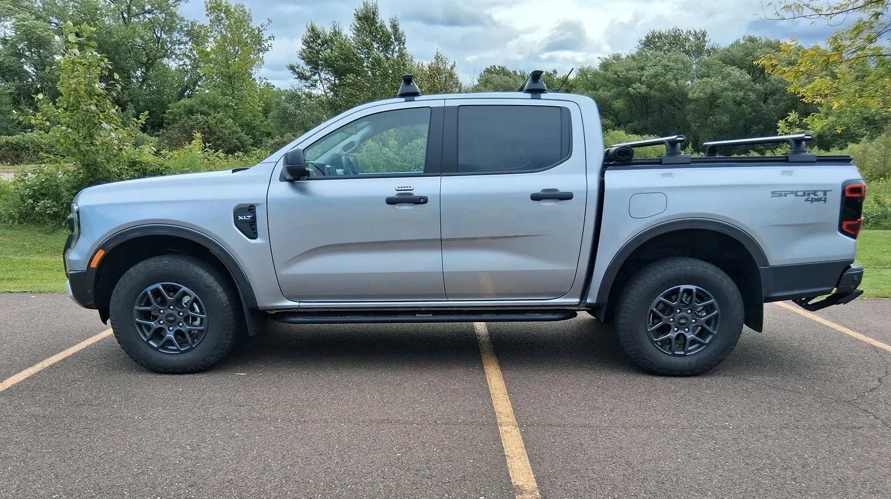

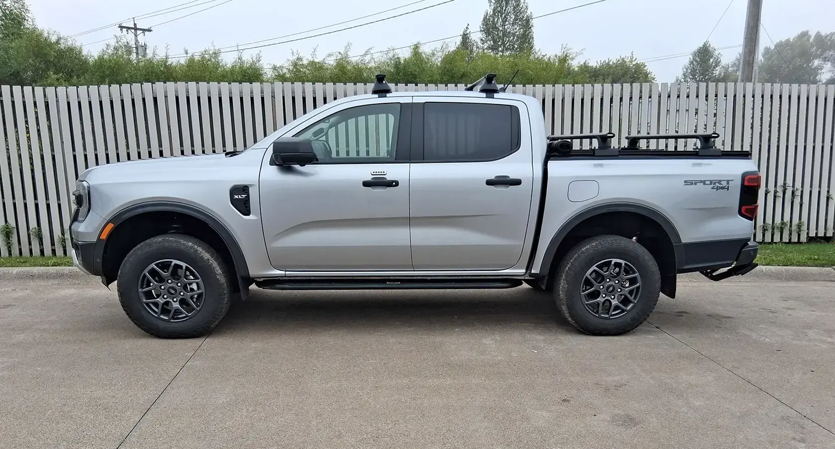

Installed Eibach's kit last weekend. I have the 24' 2.3 XLT.
It was a little tricky for a mechanically challenged person like myself, but it was worth it.
Makes the truck a little less wobbly, side to side.
I did lower the fronts 1/4 - 1/2 inch. Not hard to do. 265/70 Falken Rubitreks going on in a week.

How much factory rake did your 2.3l come with and how much did it this kit lift it? Measuring my 2.7l it looks like I only have 2 inch rake.

Had about a 3 inch difference.
Originally bought 1 1/2 inch spacers from truxx. Think those would look nice, leave a little rake. Might lower my fronts a little more.

Agree, 1 1/2" level is the happy medium. That will leave you with some rake and the axle shafts will last longer.

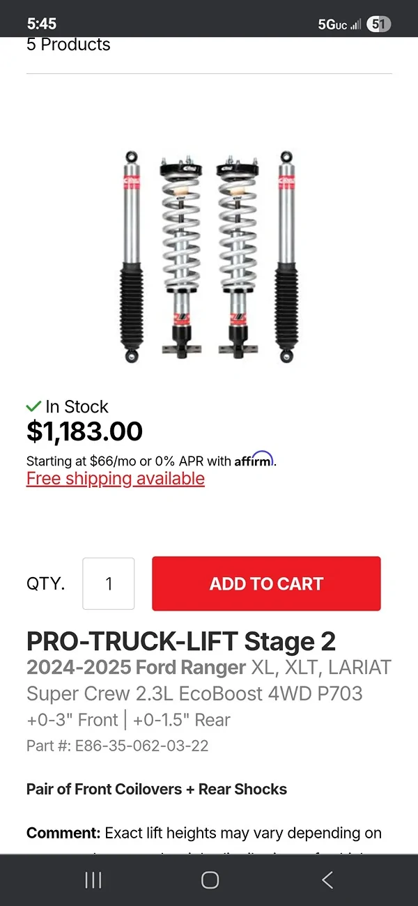

What eibach shocks are they? Stage 1 or 2. How's the ride can you describe the difference
JRRANGER
I'm waiting for the eibach stage 2R.

It's described as stage 2. Not even sure what that means, but I like how they feel. Some people describe them as in between bilsteins and stock. Best in town example I can give is turning out of an alley to a street- small dip.
Ford Ranger Eibach Pro 2.0 installed on 2024 Ranger XLT Screenshot_20250916_174554_Chrom
With the stock shocks there was noticeable side to side "wobble". With these, I don't notice anything. More stable?
Haven't taken a ride off pavement yet, waiting for tires and alignment.

The only tricky part for me was getting the stock shocks out. Specifically, the bottom 2 bolts didn't come out with a hammer. Or putting a floor jack under them. The instructions did mention they might need to be heated up. I don't have a torch so I used a grinder and a recip saw to cut the bolts and/or the tabs they go through. Kinda stunk wrecking them, but I was kinda committed. Like I said though, I'm far from being a real wrencher.
I actually lowered the height of the eibachs a little. They didn't specifically recommend upper control arms unless you go higher than the way they send them. (Level)

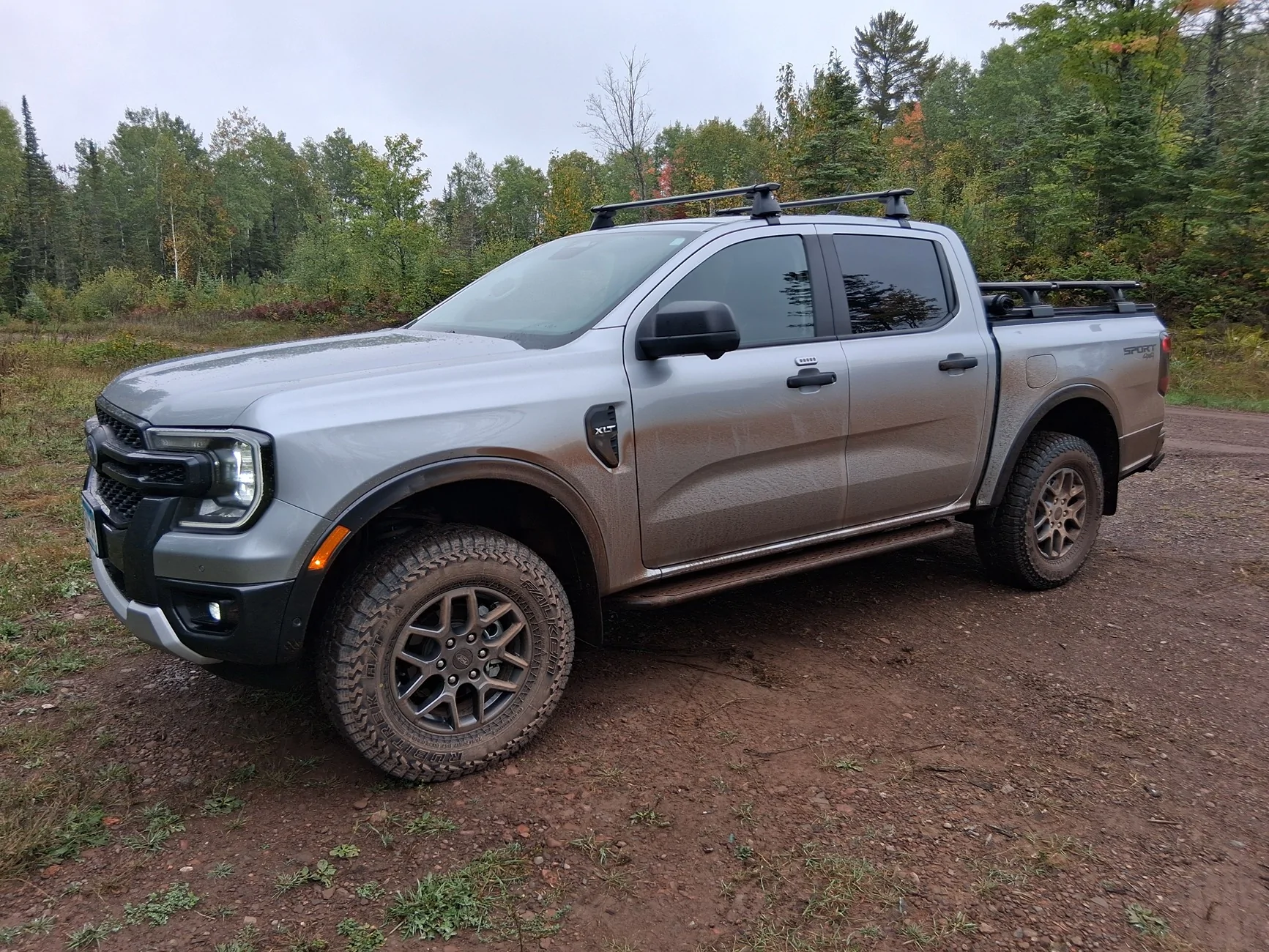

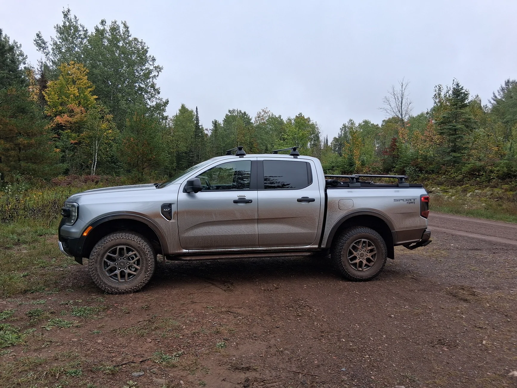

Last pic- put on some falken rubitreks. 265/70/17
As for the new shocks, the biggest change I can report is how they eat up washboard/pothole dirt roads. Not nearly as jarring.
