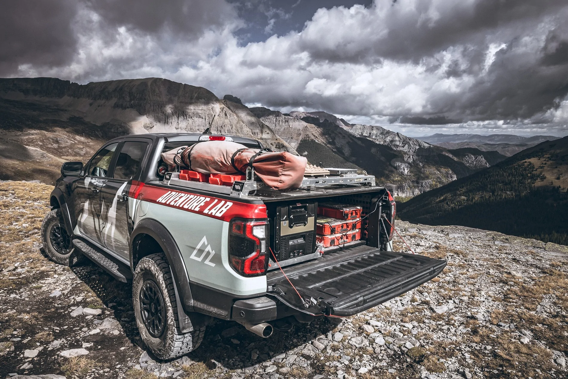

Keeping with our recent tradition, I wanted to bring you all in pretty early on this project. We’ve got an exciting new system in the works – 54" Bed Slides and Drawers – and I thought I’d share an early CAD preview to get your thoughts. I’ve attached a short Solidworks screen recording below showing the 54" slide paired with our new 6" drawer shell.
Some key features we’re building into this system:
  • Fabricated entirely from lightweight 5052 aluminum
  • 54" locking slides – lock in and out
  • Slide rating at ~500 lbs
  • Modular system – a 6" drawer shown here, with a 4" drawer also coming
  • Ability to stack drawers and slides for custom setups
  • Easy install/uninstall when paired with our BASE floor rails
This is still early, so your input is extremely valuable. What would you like to see in these components? Accessories, mounting options, dividers, latching styles – we’re open to ideas.
More information on our Ford Ranger BASE System can be found here - https://americanadventurelab.com/product/ford-ranger-bed-attachment-system-base/
Looking forward to hearing your feedback. Thanks for helping us shape these products before they hit production!
Here are a few shots of the prototypes we have in the truck now and that we used on the Trail Hero Expeditions show.

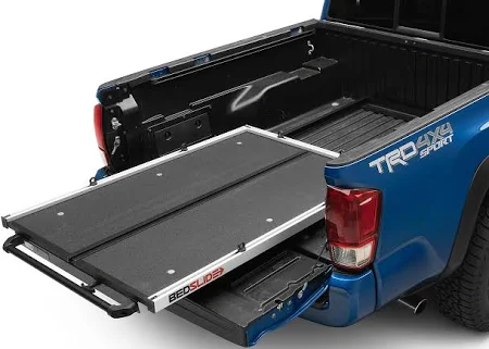

I was implying a single platform across the bed instead of two. It would open up more layout possibilities for different containers and help the bike guys using it without a cover. It would probably sacrifice of a few inches of height in the bed, so it would be a trade off.
The Weights sound good. Glad to see you are keeping this prioritized.
You're referring to something similar to the "Bed Slide" (attached) setup, correct? If so, I don't see a compelling reason to compete with that setup. It has its trade-offs like everything else does, including our system, but if someone wants that type of platform, that one seems to do the job. Those are manufactured next to our shop.

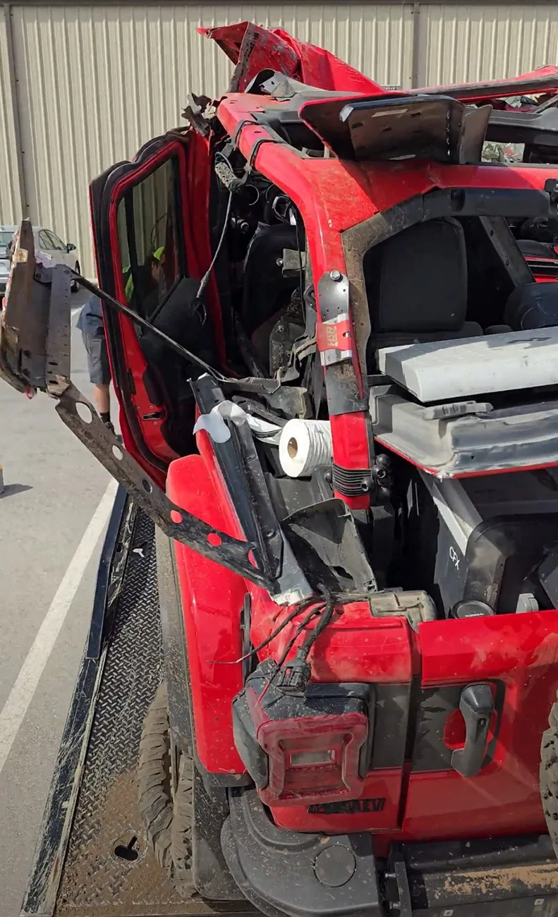

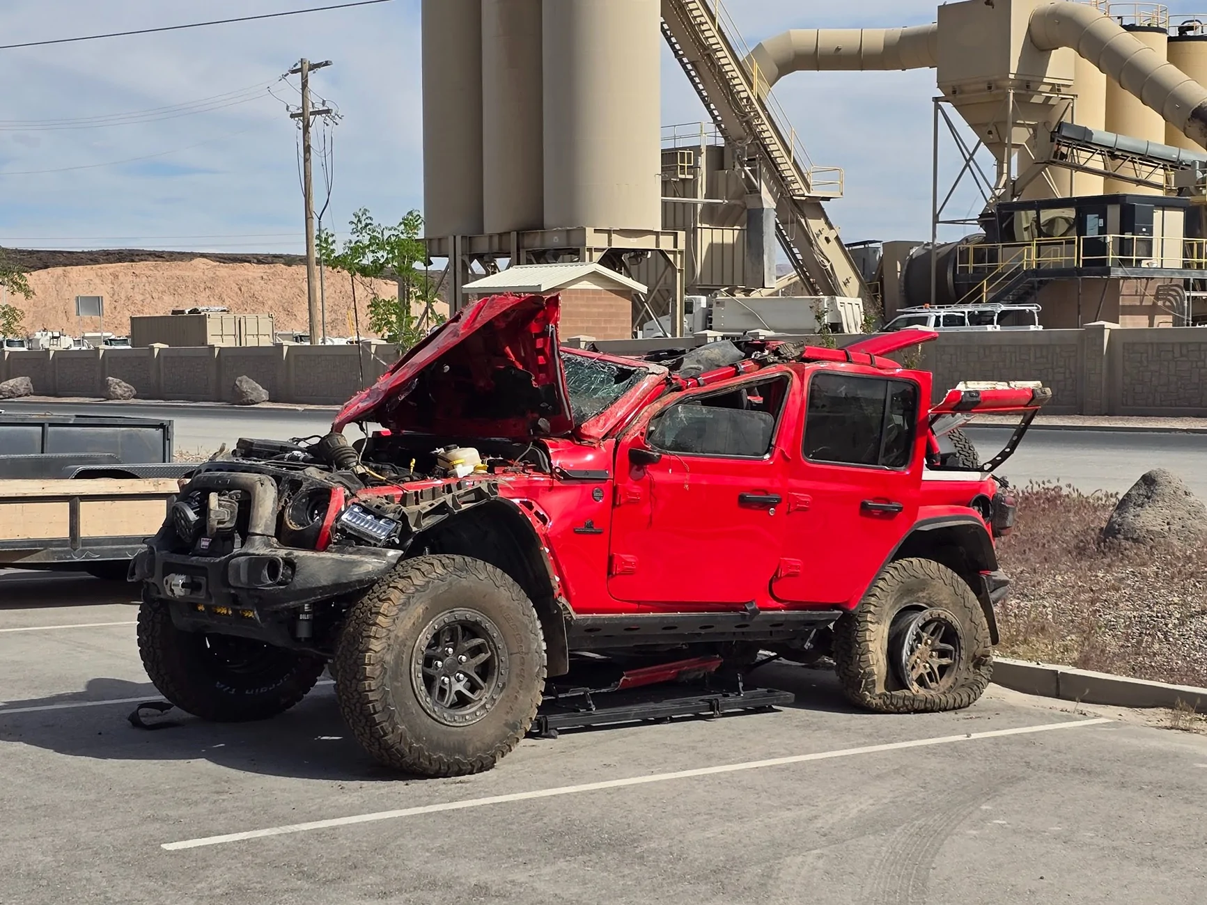

Here is a Jeep with our system installed that rolled 7 times on the freeway. Notice his fridge is still bolted to the slide. We take great pride in building products that withstand the abuse these trucks are capable of giving them.
