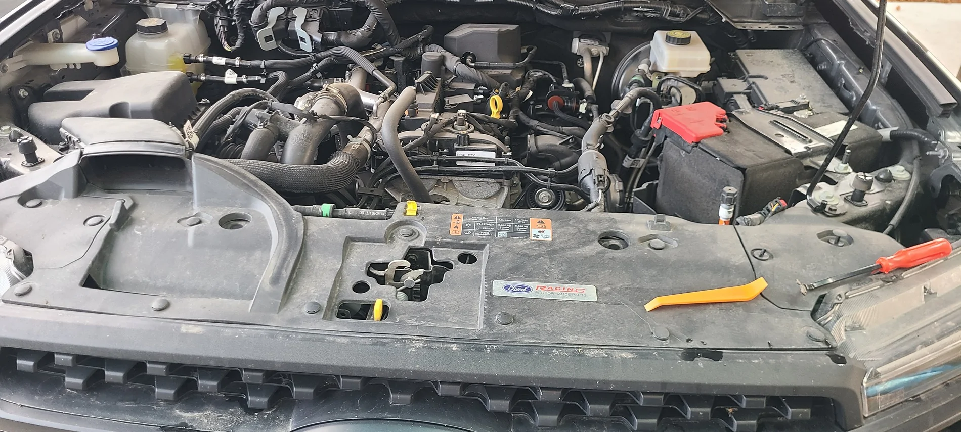

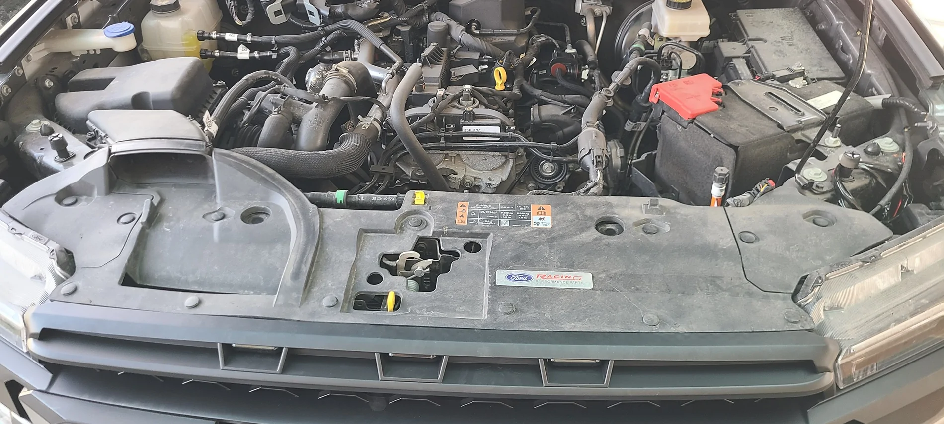

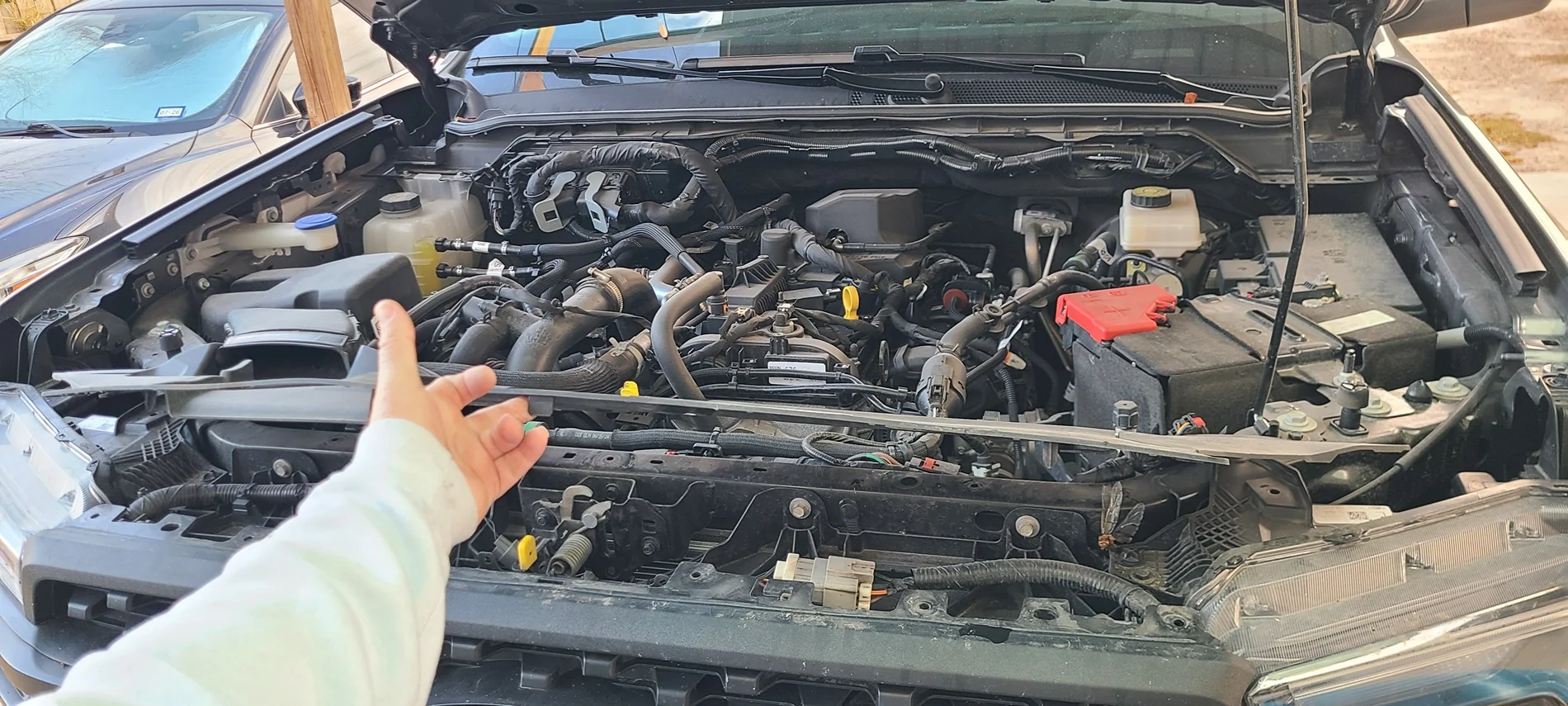

Pop the hood and remove all these little push pin holders.
Ford Ranger Ranger Raptor grill on regular Ranger - DIY install with pics 20260204_092343
Ford Ranger Ranger Raptor grill on regular Ranger - DIY install with pics 20260204_093317

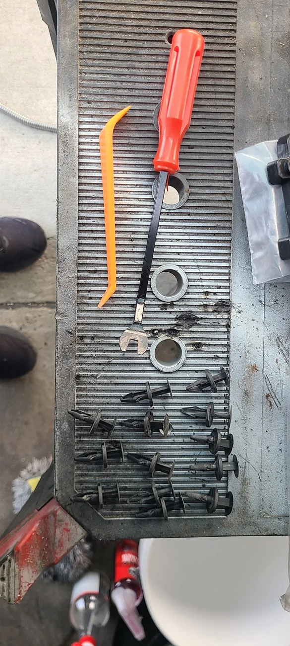

There are 13 to remove. Use a plasric trim tool to get the center up and then you cam just pull them straight up amd out of the part that covers the top of the grill area. I used the handy tool that came with my muslogy mud flaps.
Ford Ranger Ranger Raptor grill on regular Ranger - DIY install with pics 20260204_093331
You should be here now

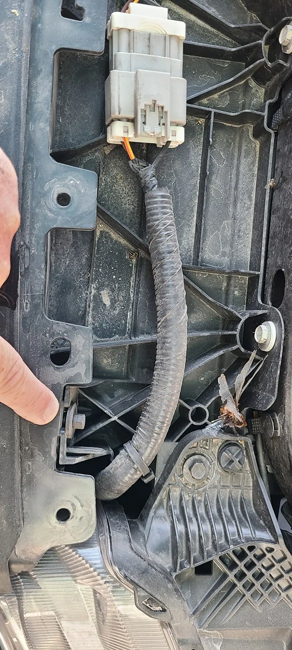

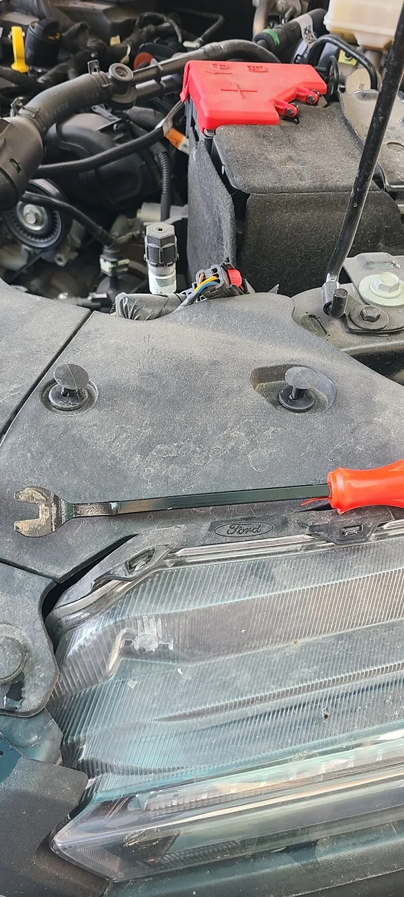

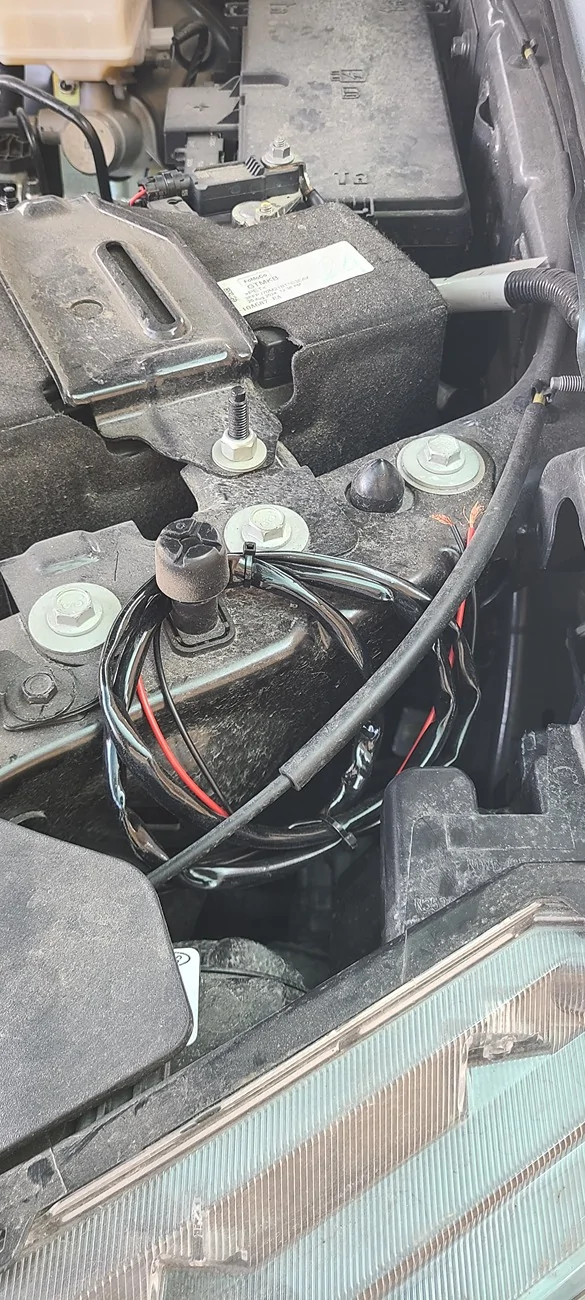

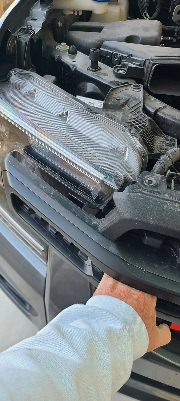

Remove these two bolts from top of the current grill on your truck. They are 8mm, or 5/16". Same size is how it seemed to me
Ford Ranger Ranger Raptor grill on regular Ranger - DIY install with pics 20260204_093759

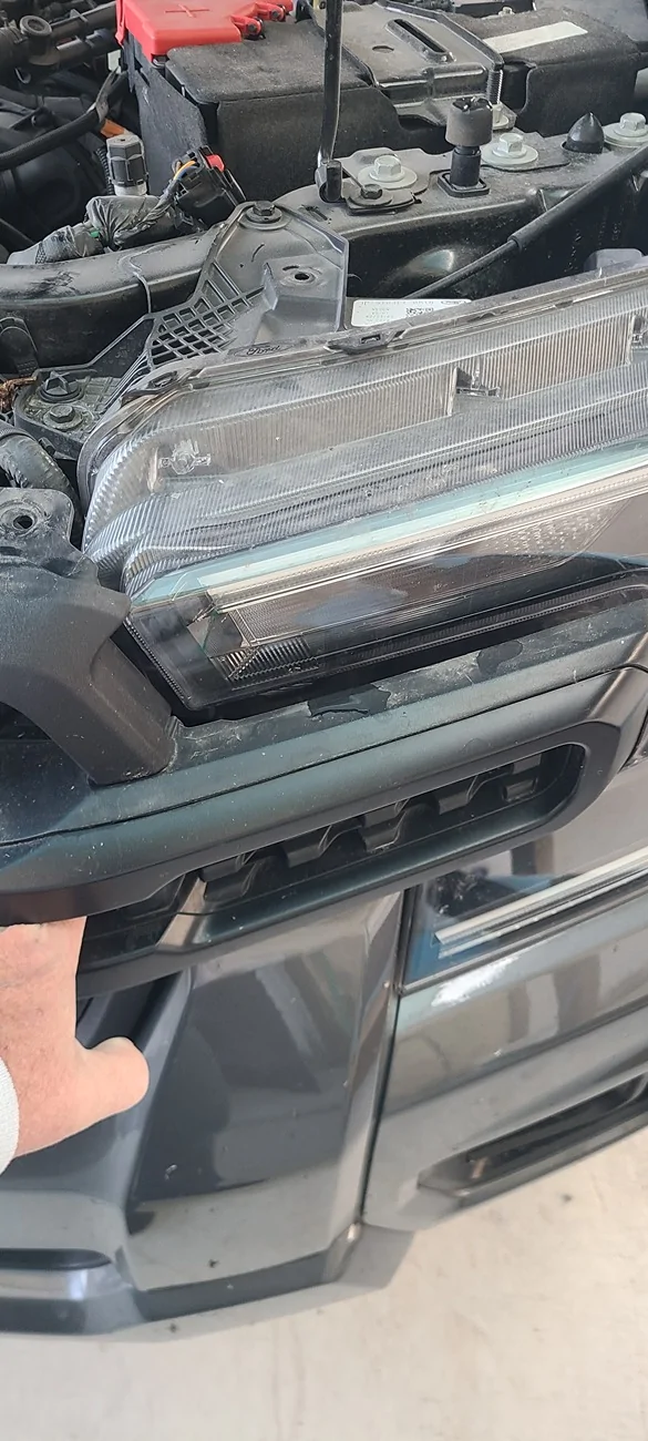

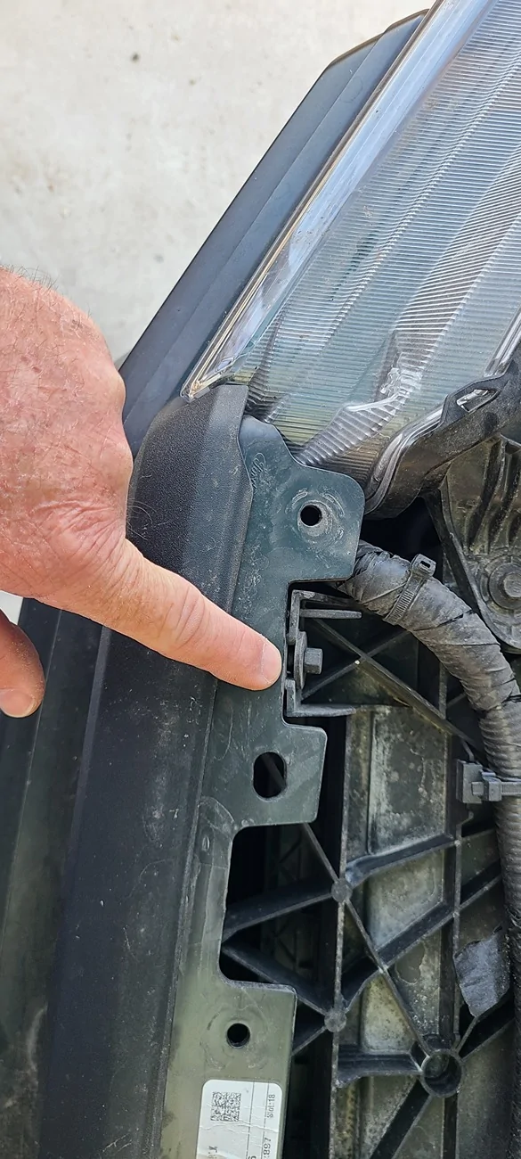

Grab here and pull straight out to pop the wing bracket out of its holder.
Ford Ranger Ranger Raptor grill on regular Ranger - DIY install with pics 20260204_093808
Do the same thing to this one.
The next part was tough and i didnt get a good picture. Its where you actually remove the grill from the truck. There are 8 more brackets across the bottom side of the grill that need to be pulled out. 2 of them are situated on their sides and are in the curved up area of the bottom of the grill. The two on theur sises will come right out of their attachment slot but the 6 across the very bottom are a pain the ass. I broke 5 of them and i was awate they were there and how to get them out. I just couldn't get then to pop out, even using a little tool to try and disengage them. Finally i just said screw it since i am replacing the grill, anyways. It just means i cannot sell the oem grill for a decent price now, though it still has enough clips to mount solidly. So thats why no decemt pic

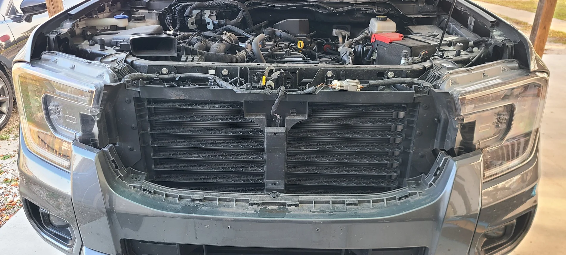

The clips go into those thin slots at the top of the bumper. You will be here, once you get the grill off.
Ford Ranger Ranger Raptor grill on regular Ranger - DIY install with pics 20260204_095630

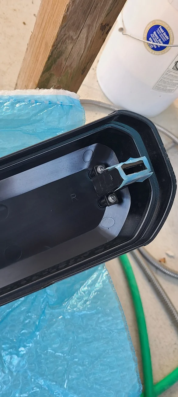

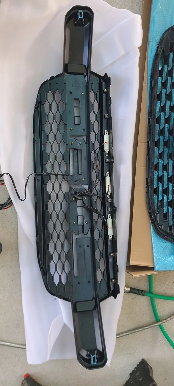

Next, you need to get the little brackets from one of the plastic parts bags that came with the grill, and the bag of screws, and put a bracket on each end of the grill. 2 screws per bracket. I took the blue tape off the oem grill smd put it in place on the new grill, just because ford had it on there for some reason.
Ford Ranger Ranger Raptor grill on regular Ranger - DIY install with pics 20260204_102046

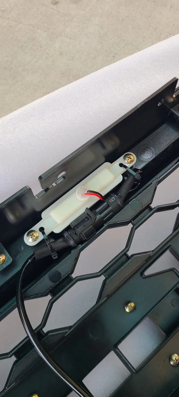

I used bright colored screws so you can see everywhere that needs screws, behind the O and R, holding the led lights in place, and holding the flat top pieces on.
Ford Ranger Ranger Raptor grill on regular Ranger - DIY install with pics 20260204_102548
I used small zip ties to hold the wiring for the leds in place because if you dont, the wires just flop around and i was afraid they would get abraided and possilby short out over time.
Ford Ranger Ranger Raptor grill on regular Ranger - DIY install with pics 20260204_103219

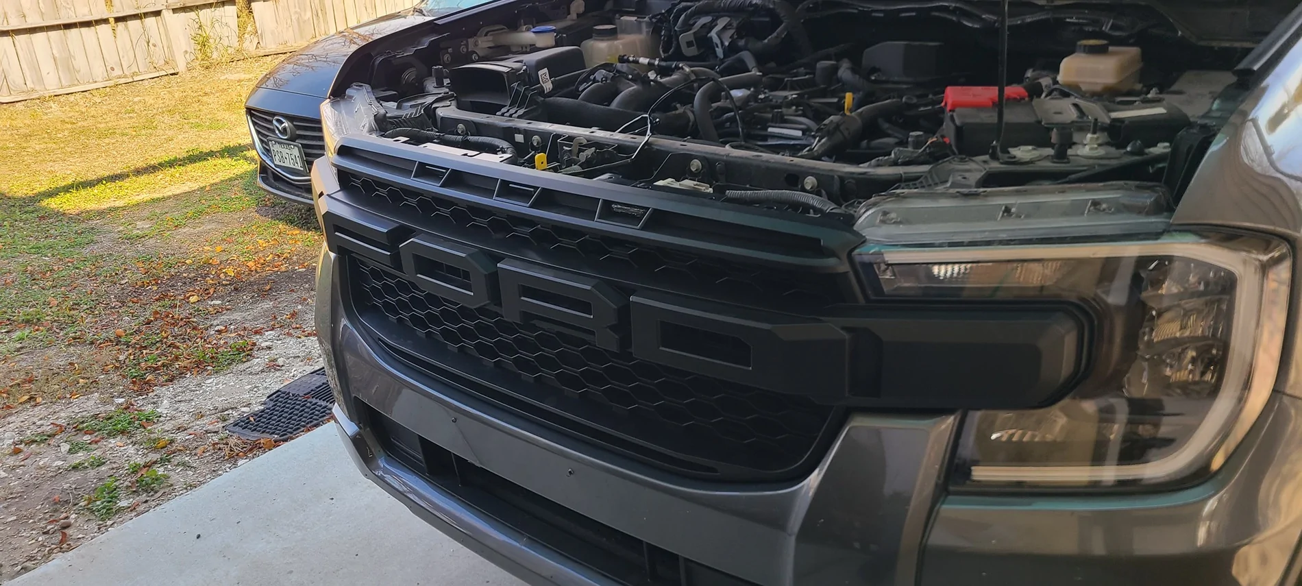

You are almost done and can see how cool it looks now
Ford Ranger Ranger Raptor grill on regular Ranger - DIY install with pics 20260204_104054

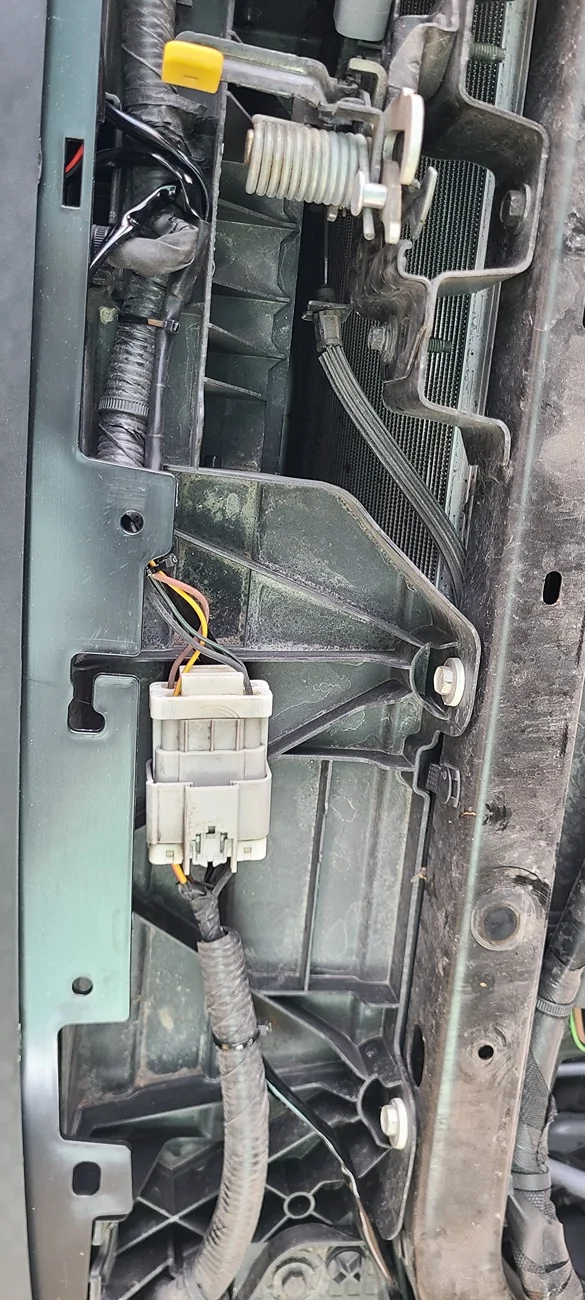

Runnthe led wiring harness along the factory harness and zip tie them tigether so the new harness doesnt wiggle around and short out or get cut somehow.

I have the led harness zip tied up while i try and find a better why to hook it to the day time running lights then cutting and solder/shrink wrapping it to the truck wiring harness.

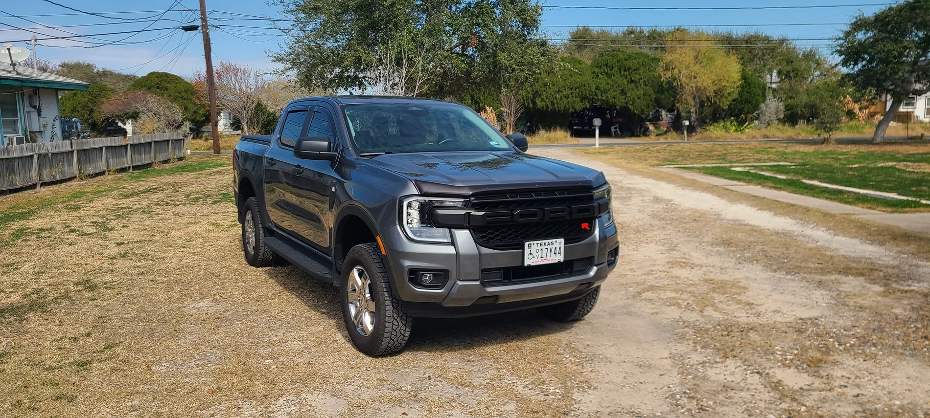

You are now complete.
Go have a snack and drink and wash your super cool truck that totally stands out from the crowd, now

I had to remove my license plate holder to do this. I forgot to add that, and also that those two 8mm bolts are not used on the new grill. I have no idea why but there is no way to reinstall them on the new grill

I found out two web sites sell an adapter to plug into the light harness instead of doing any cutting.
F150leds is one

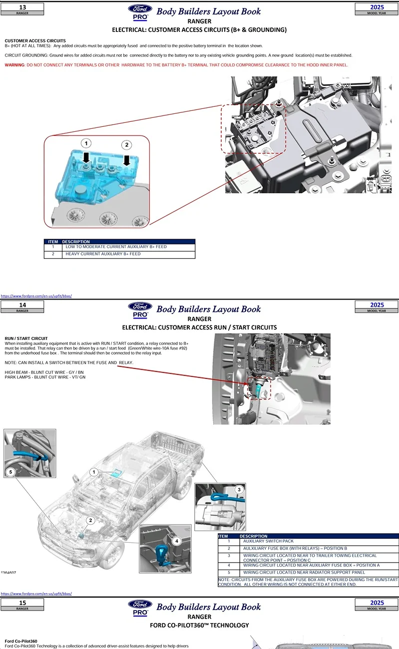

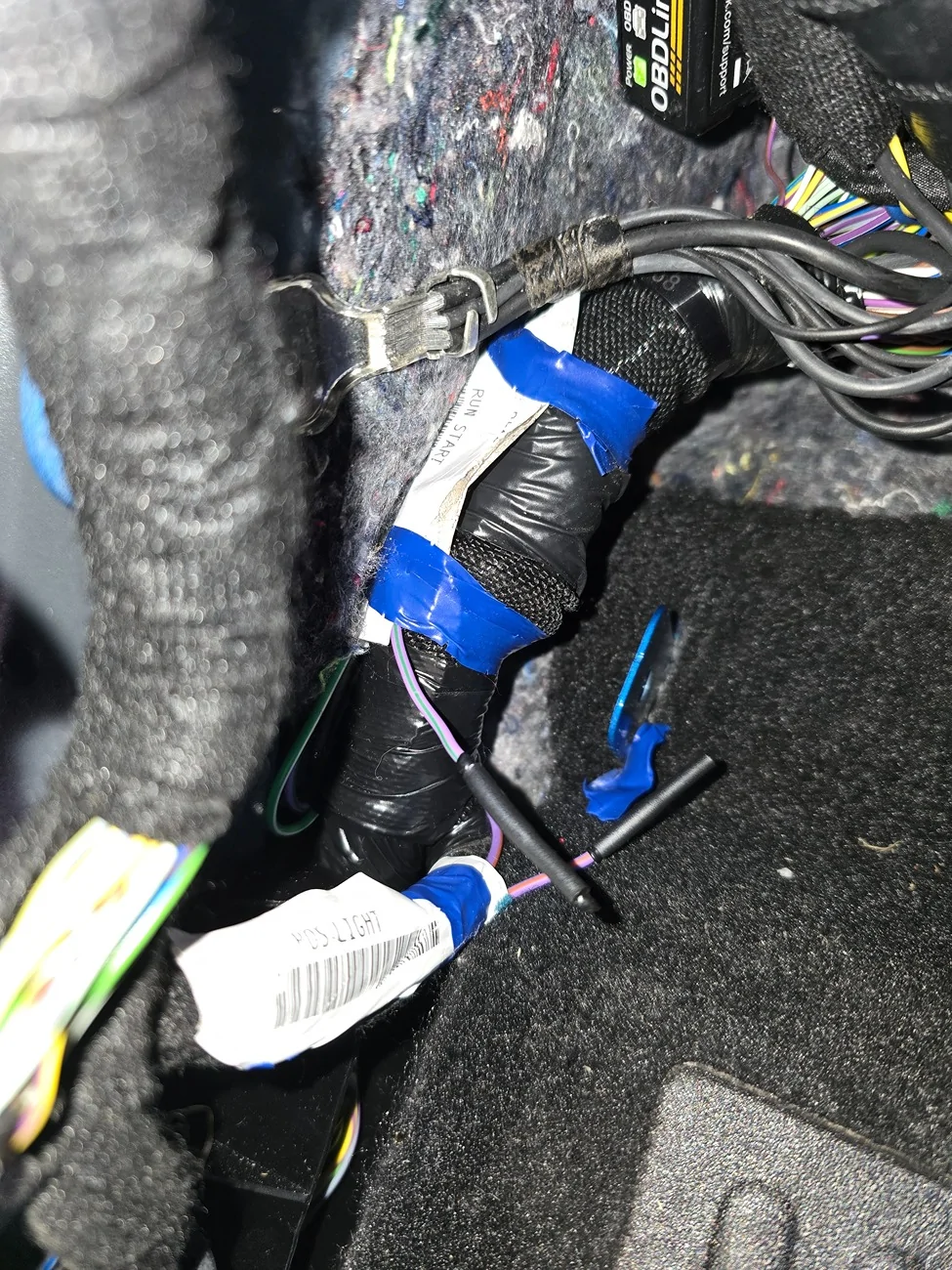

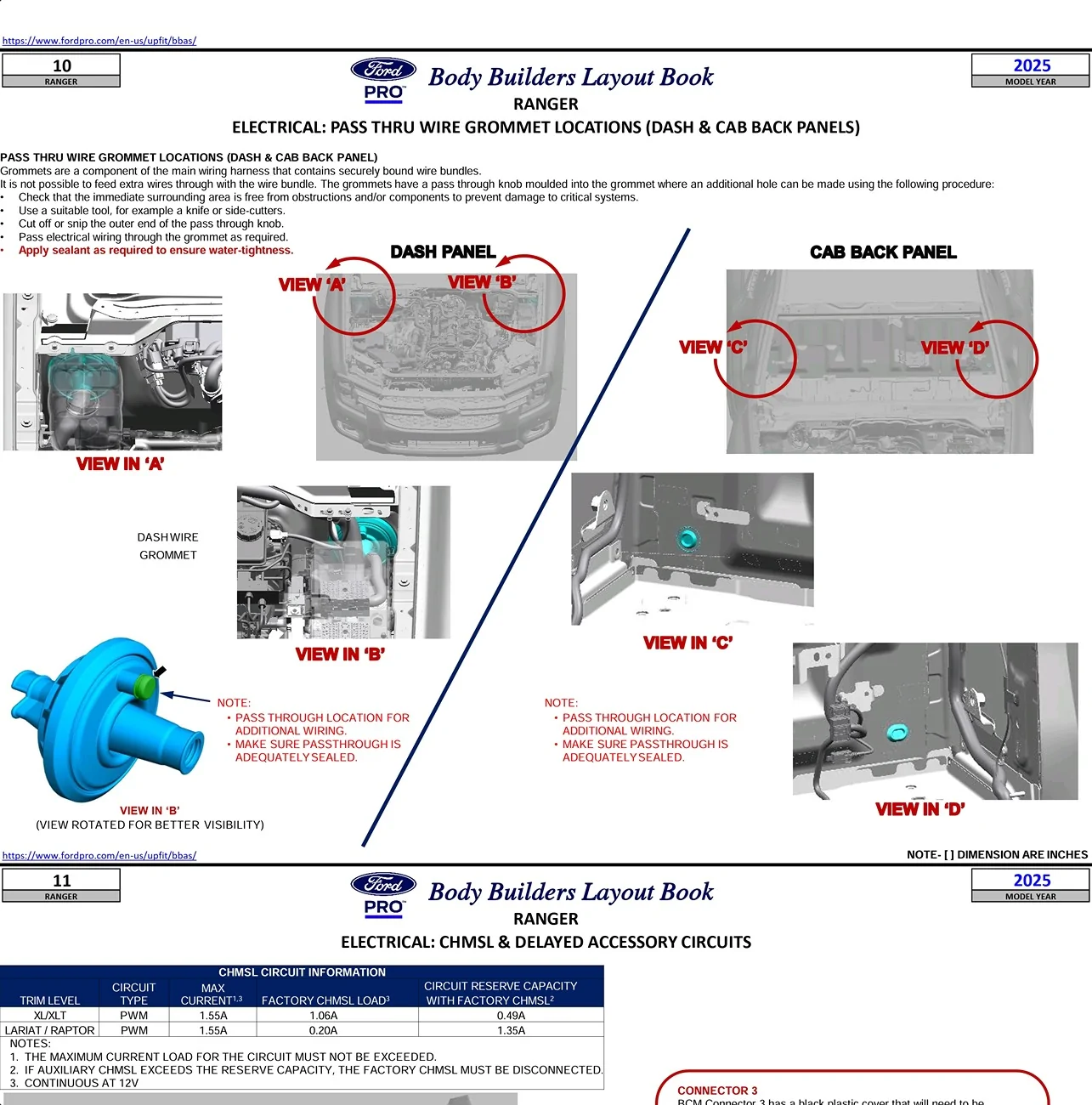

theres a marker light blunt cut wire under the bcm/trailer module behind the driver side kick panel.
theres Ignition, marker, and highbeam trigger wires.
Ford Ranger Ranger Raptor grill on regular Ranger - DIY install with pics Screenshot_20250922_091559_Adobe Acrobat
Ford Ranger Ranger Raptor grill on regular Ranger - DIY install with pics Screenshot_20250922_091636_Adobe Acrobat
Ford Ranger Ranger Raptor grill on regular Ranger - DIY install with pics 20250822_150423
Ford Ranger Ranger Raptor grill on regular Ranger - DIY install with pics 20250822_150451

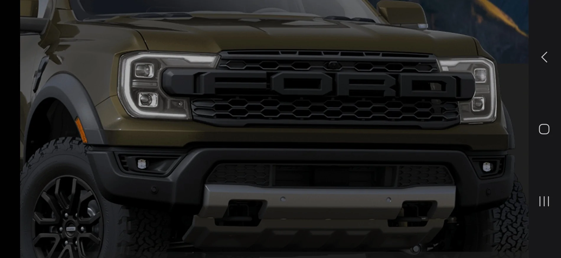

Bumpers are different. and the curvature. pulled from fords website
Ford Ranger Ranger Raptor grill on regular Ranger - DIY install with pics Screenshot_20260208_002014_Samsung Internet
Ford Ranger Ranger Raptor grill on regular Ranger - DIY install with pics Screenshot_20260208_002033_Samsung Internet
