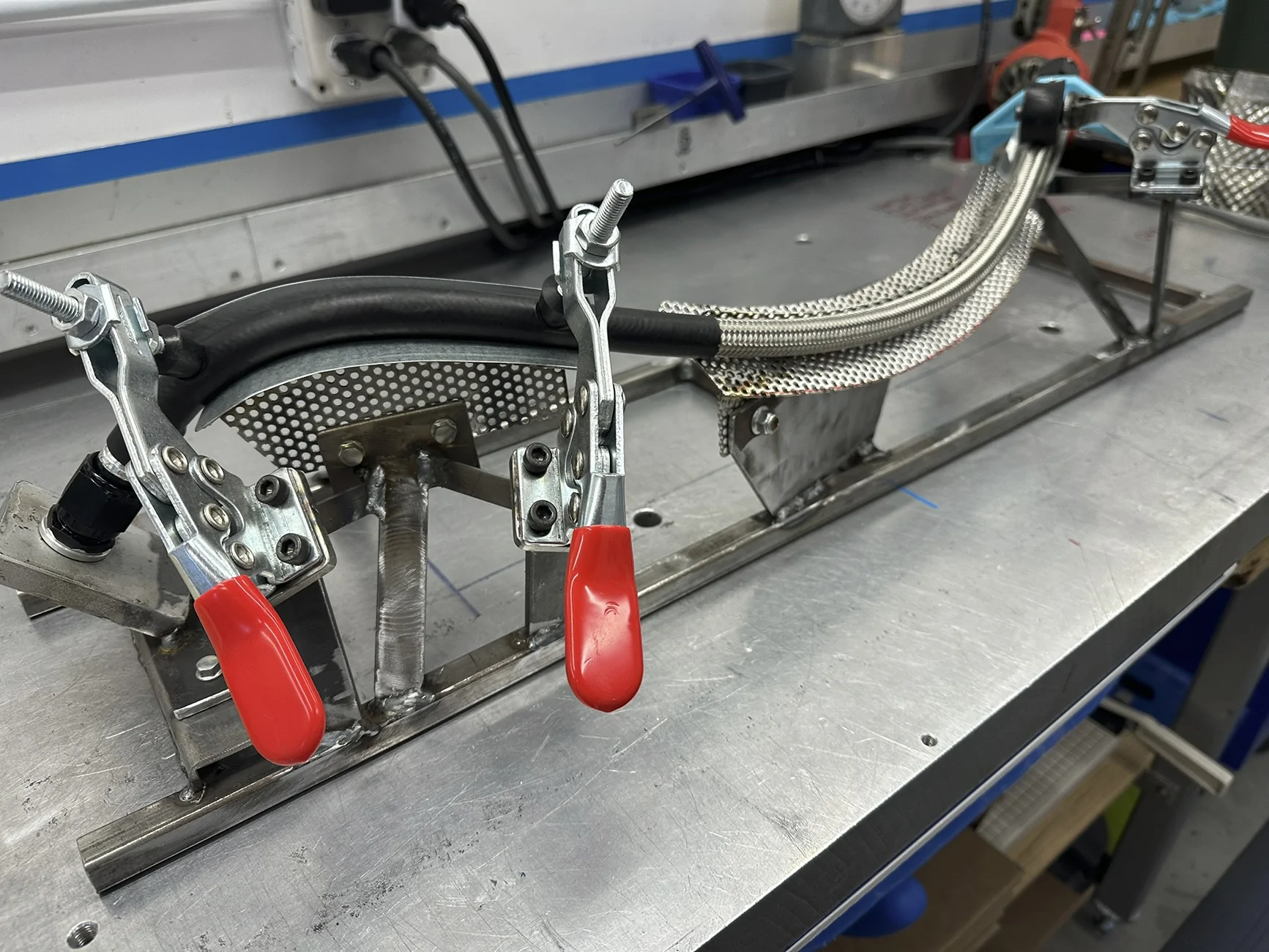

I am most curious about how well the shape will hold, I form them at high temp with structural adhesive, so after a week in service, I want to put it back in the fixture to check it.

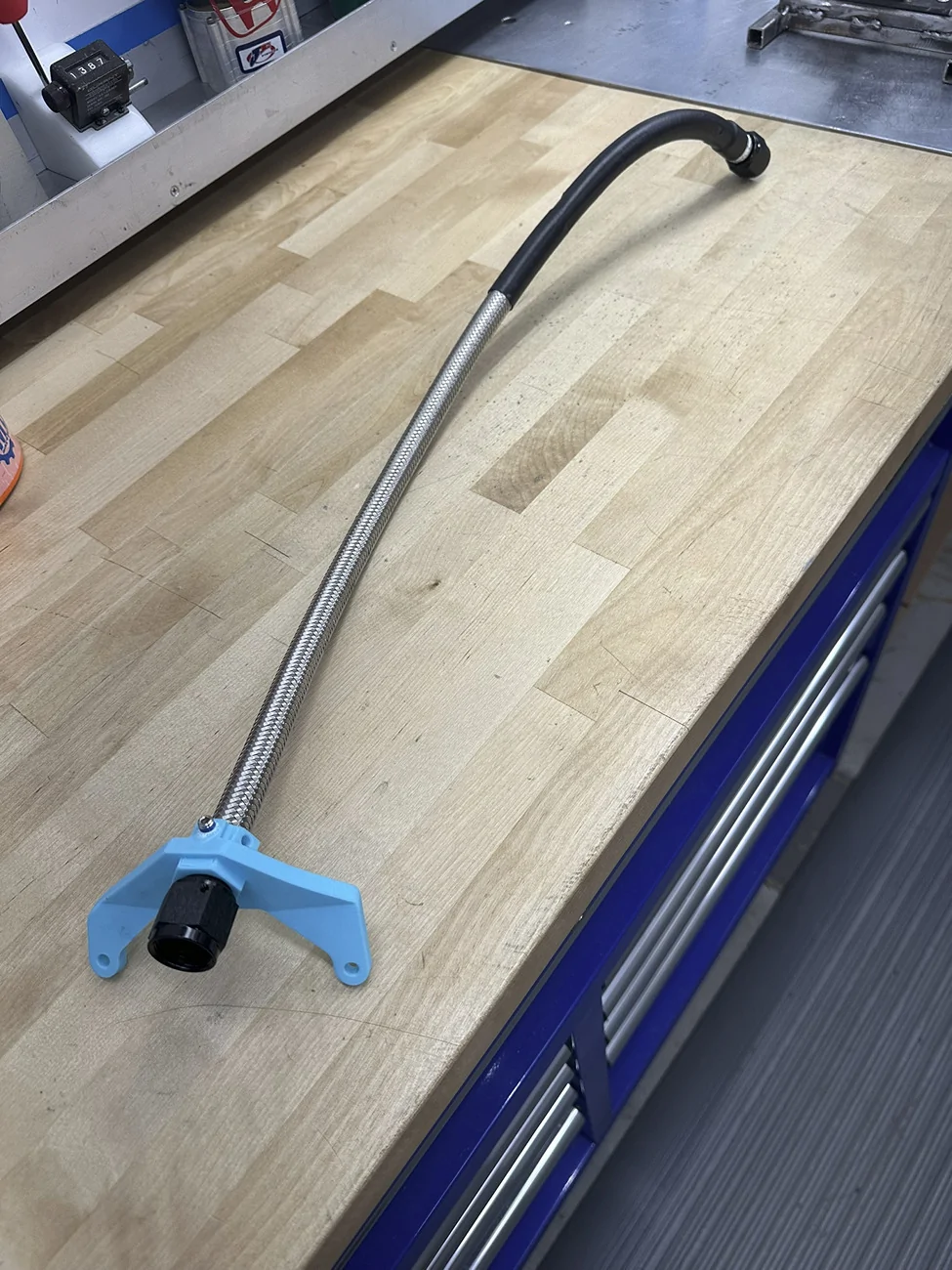

The first pic is the important curve, the rest of the dipstick housing is simple, I only have the 3D printed engine bracket for now, but if this fitment goes well, I will order the aluminum ones.
